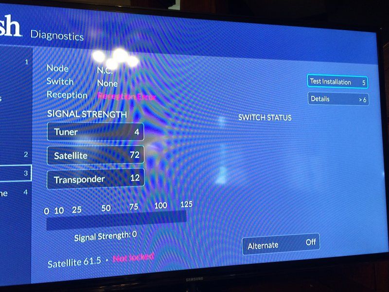

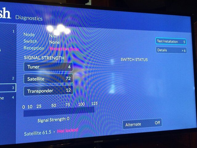

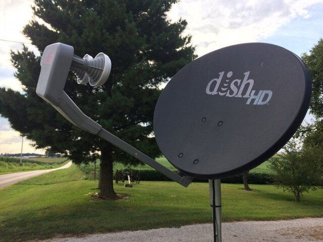

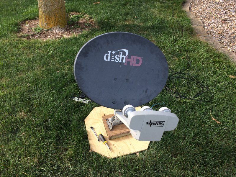

I currently have Dish set up at home with the Hopper 3. I have an extra Dish that I would like to use when camping. I used to do this all the time with my old receiver and a Dish 500. But with this new equipment, I can't seem to get the Hopper to recognize my camping Dish. The LNB (hope that's the right terminology) on my camping Dish says "DP PLUS" and it looks slightly different than the LNB on my permanent Dish. When I hook up the camping Dish, I go to the settings and run a "test installation" and it won't seem to recognize the LNB switch at all. Are they just not compatible? Could the camping LNB just be bad? Any guidance would be appreciated and P.S., I don't know a great deal about this stuff so forgive me if I use the wrong terminology. I've uploaded some pictures in case that helps identify what I'm talking about. Thanks!

With the Hybrid LNB, if someone wants to share, you have a better excuse to tell them no, compared to the Switch.
The first photo must be from the home system.
From his photos. he has an DPP LNBF on a DPP 1000.2 dish in the fourth photo.
The third photo shows an WA DPP LNBF. That is probably what the second photo is indicating, no switch.
You choice is a EA and WA Hybrid LNBF or a DPH-42 Switch that will allow your current LNBF heads work with the Hopper 3.

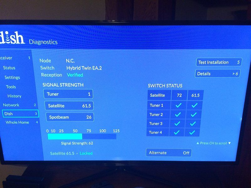

Ok, so here's an update: based on JSheridan's first comment, I got ahold of a hybrib LNB and put it on my portable Dish and now the Hopper recognizes it. Now I think I just need to get it pointed correctly. So on the portable Dish, I matched the elevation and skew (hopefully those are the right terms) settings to my permanent Dish and then, using a compass, I matched the angle it's pointing...about 160 degrees. I've leveled and plummed the portable Dish as best I can, then I've slightly adjusted the angle back and forth looking for a signal but no luck so far. Thoughts?
