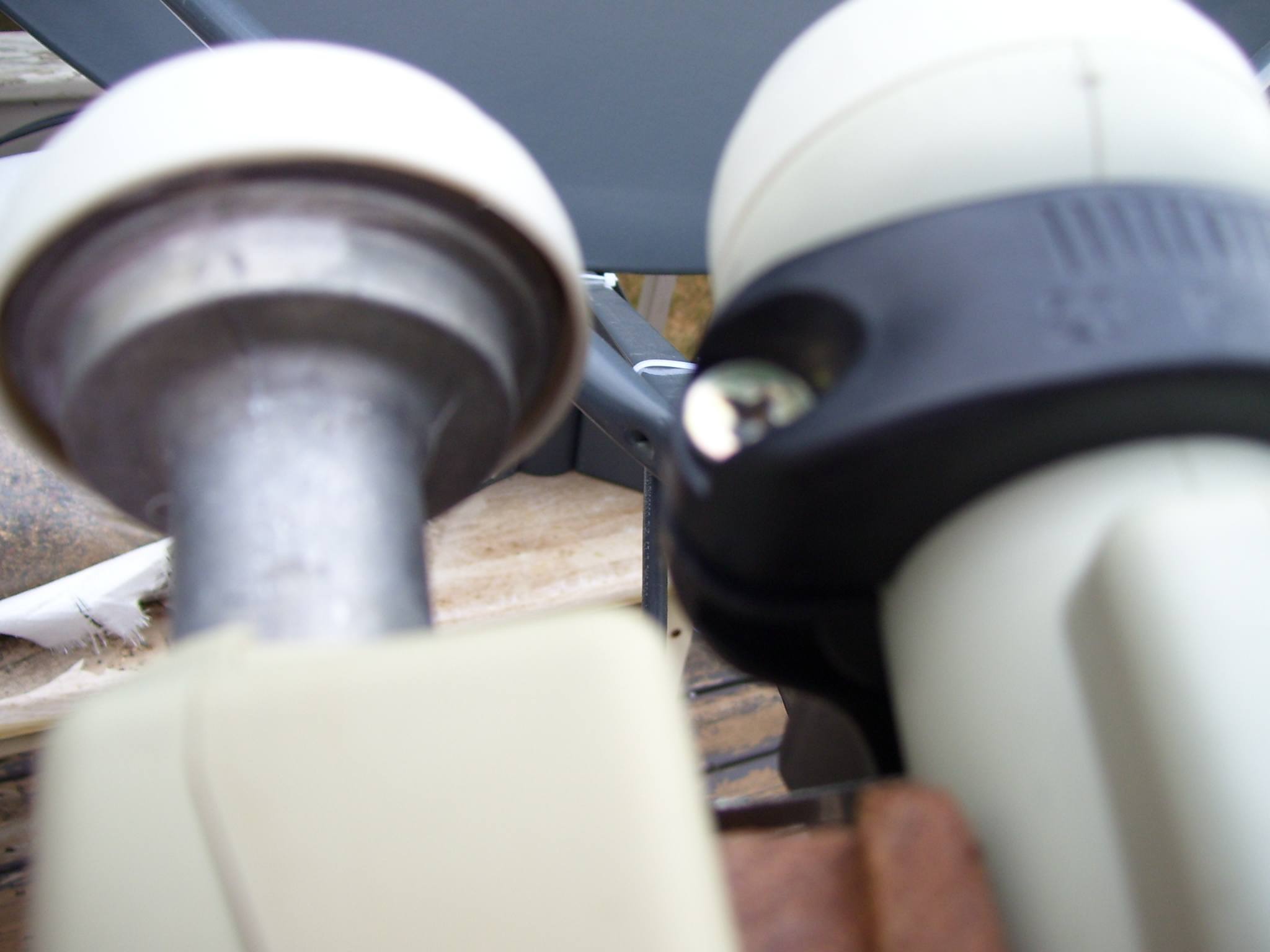

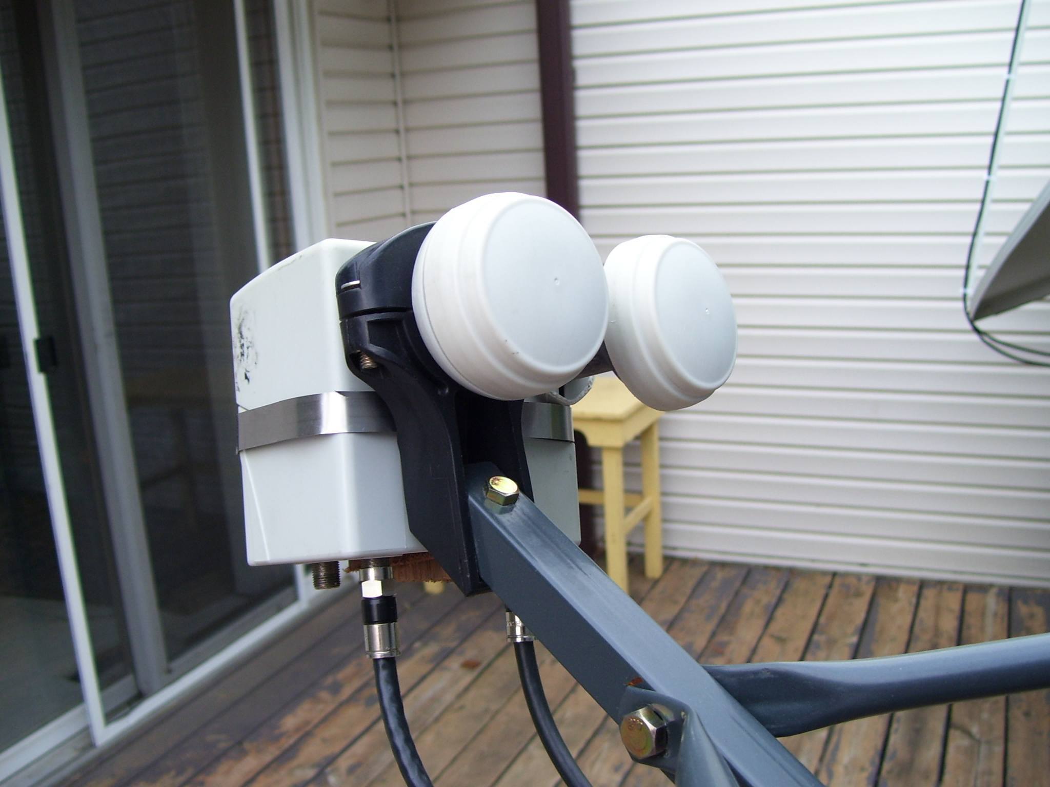

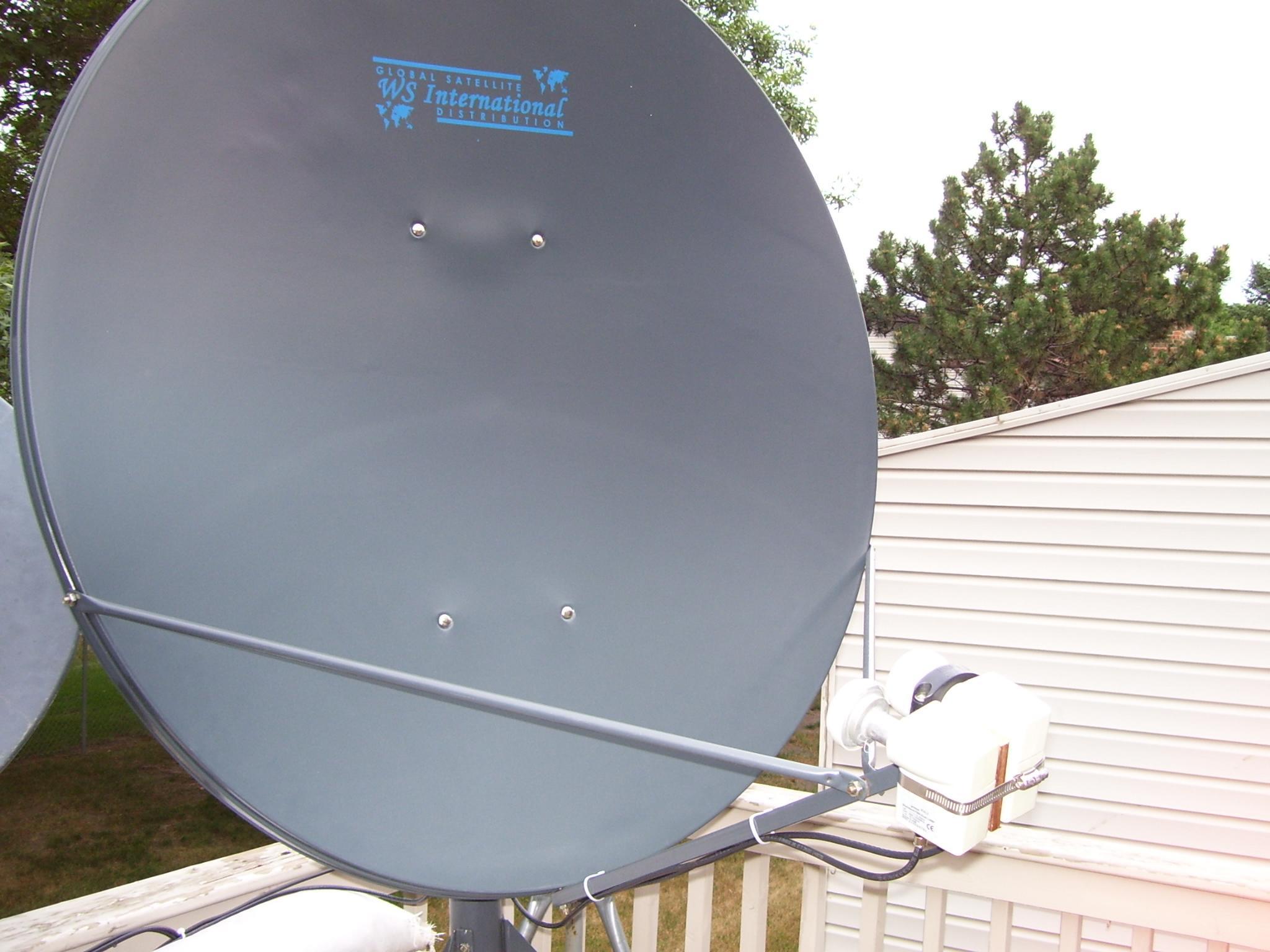

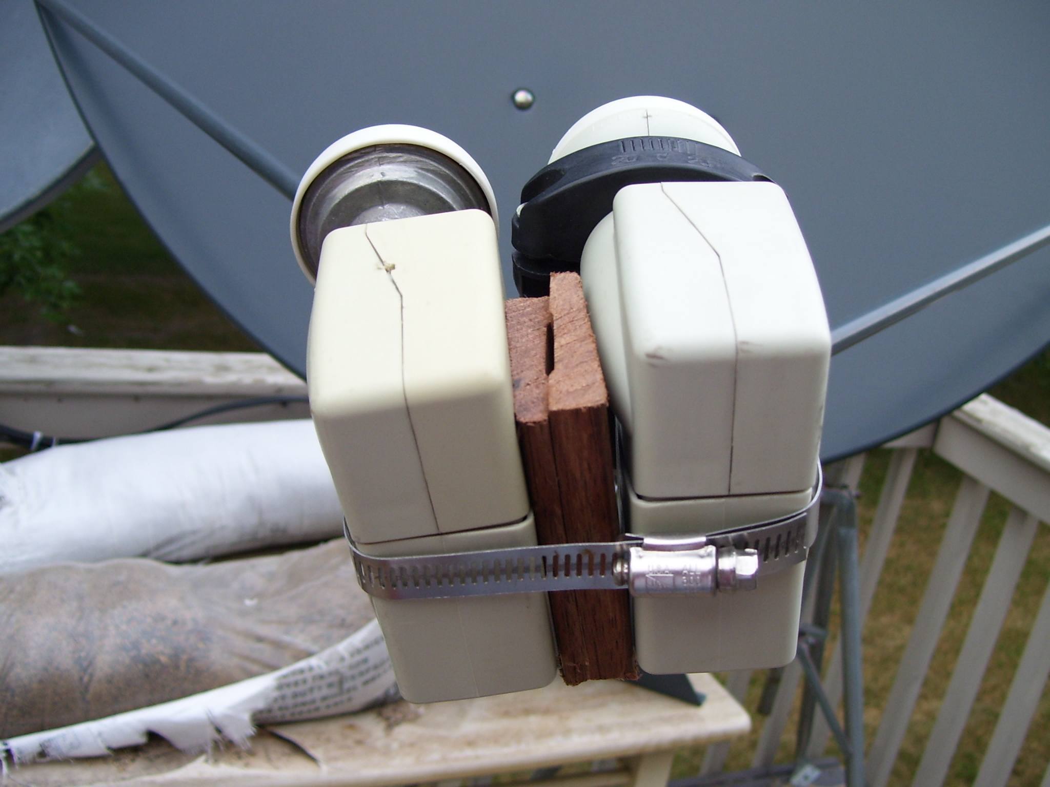

Well yesterday I made my first attempt to get more than one LNB working on a single dish. All I have are round (non-elliptical) dishes, various sizes. I am in Central Alaska, the 48" is pointed at 107, so I left it there and fashioned a second bracket for another KU lnb and looked for a "hot spot" to see if I could find 111. I found it with the LNB's touching each other, and the 111 LNB slightly lower by 1/2 inch. I know this is the sort of setup Iceberg is using too. I'm going to go look for his pictures again.
I was wondering if folks have gotten better results by "detuning" the dish to about halfway between 107 and 111, and sort of centering the LNB's. I am going to experiment this weekend with a spectrum analyzer from work and see what I come up with. Some of the HD channels on 111 are pixellating and are marginal now. I think I can afford to lose signal on 107 if I pick more up on 111 and get everything at once.

But what me personally would do is aim at 111.1 and put 107 offset. You need more signal for HD than you do SD so I have 111.1 boresight and the 107 LNB offset
Shaw 107 and 111
Thanks Iceberg, that makes sense, I'll try aiming at 111. I have a huge signal on 107, around 89 on channel 299. I can afford to lose some. That should do the trick. Looking forward to getting the Olympic broadcasts from the host country, got things working just in time.
