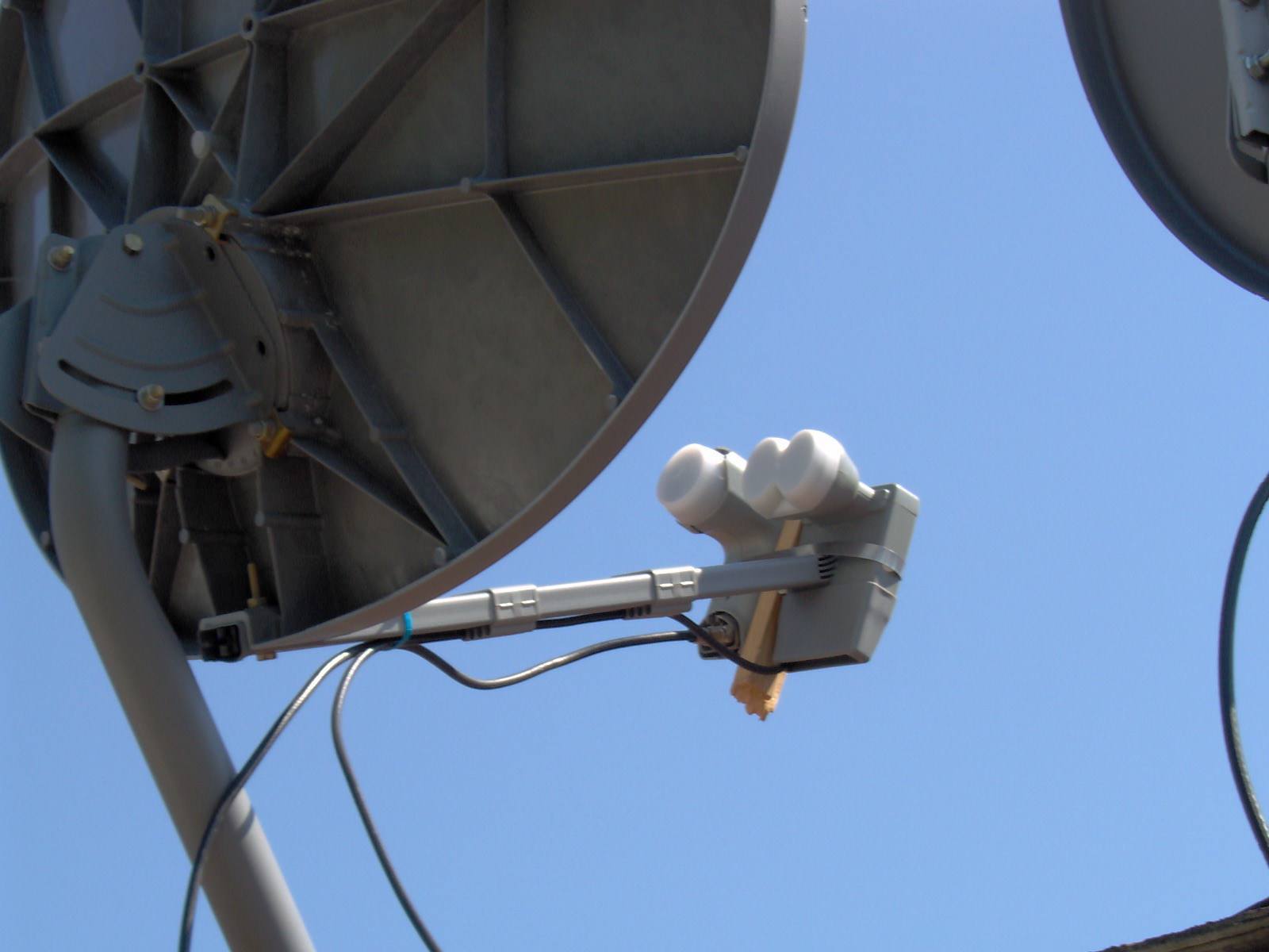

Shaw Direct uses KU Band at 107.3W & 111.1W
107.3 is the "main" satellite
111.1 is the HD and French satellite...if the customer has the oval dish you aim at this satellite.

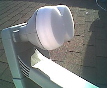

The birddog will work just fine. You just have to set it up to see 111.1 Check frequencies at Lyngsat.com and just make sure if the customer has the "quad" LNB (see pic below) set the meter to 22k burst "ON". While the 605 is a HD receiver, the frequencies being KU are kinda forgiving...not as forgiving as Dish but not as finite movements as Directv KA Band
If you've ever aimed a free to air dish (30" or larger) for international channels or Glorystar (religious channels) then Shaw will be a breeze. It works the same way
oh in pic 2 the LNB to the left of the piece of wood was for 119W

Your client should obtain a 75e elliptical dish ("oval", per Iceberg's post) and quad LNB (the current setup offered by Shaw) for use in Phoenix. The smaller dish that Shaw offers (the 60e) may not be large enough to provide a reliable signal in marginal weather (which doesn't happen often here). The quad LNB for the 75e is as pictured in Iceberg's post (without the wood and the second LNB :)). Note that the LNB must be matched to the dish, i.e., the 75e dish requires a 75e LNB. The LNB number is printed on the back of the case.
