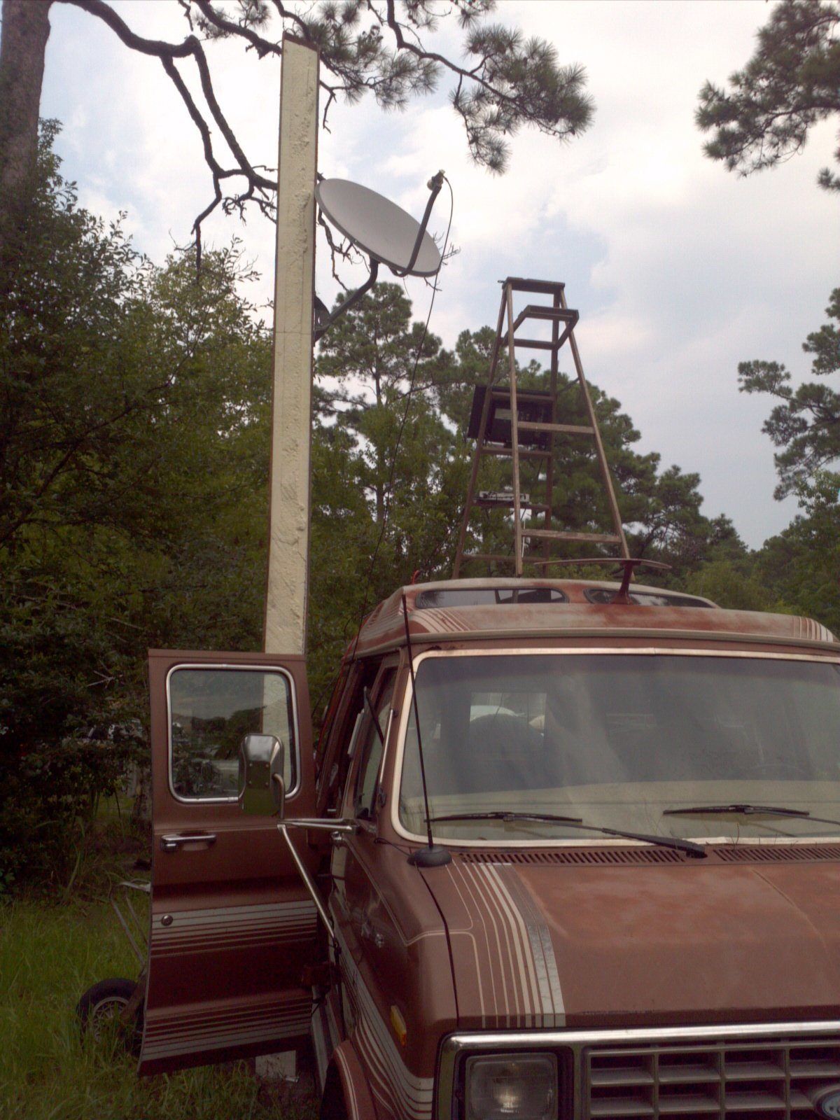

The Mess...
This is the 'temporary' setup... posting for your amusement. Motor removed. Getting closer I feel, but still nothing yet, (I think I have to cut off my 'pole' (part of SIPS house panel) to get closer to the elevation angle) Tom- a great deal of info you gave me Thank you. Still signal intensity and quality Always hover at same numbers... wierd. AND I think I need to ground my unit/antenna also... 2011-08-04_16-50-56_926.jpg
Make sure your mounting post is as plumb as possible. Since you are installing a non-motorized dish, it does not have to be 100% plumb but it's better if it is. This way, you won't have to "fudge" the dish alignment in order to get signal. Put a level on the J pipe itself and make sure it's pointing straight up from all directions.
With the Easyfind LNBF, there's actually a small LED light on the LNBF itself so you don't need to have the receiver and a TV outside. When the dish starts getting signal from the transponder you have it set at, the LED light will start to light up. The brighter the light, the stronger the signal.
