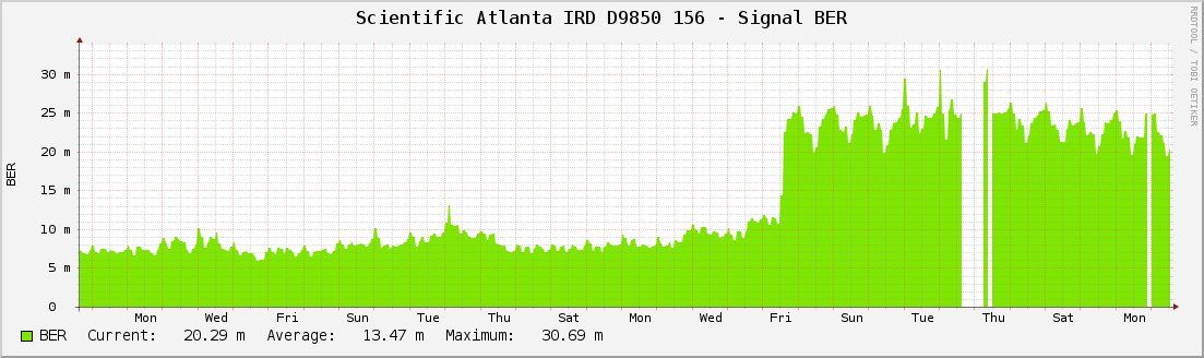

I was going to start a thread on this very topic! Last Friday night the signal just went to crap. I thought it was my dish, but nothing whatsoever changed. DW-TV has no interest in scrambling, and I was thinking about contacting their customer service and letting them know. I have a commercial IRD that has been permanently tuned to 3740V for over two years outputting DW-TV to an analog and digital modulator. The BER of the signal has been logged and monitored by a program called cacti, which pools the IRD via SNMP and creates a beautiful graph of the data.
As you can see, the signal was at a level of BER that prodiced a perfectly stable picture with maybe a transport stream error here and there. Friday night the BER increased to a rate where the analog video output won't produce any picture (blocking causes the video output of the IRD to mute) and there are too many errors in the transport stream to produce video at all at my QAM tuners, just lots of blocking and an audio blip here and there. This is all on a Fortec 6 footer with Norsat LNB. I love how I can monitor the BER of my IRDs because I can precicely pinpoint when an issue happened.
