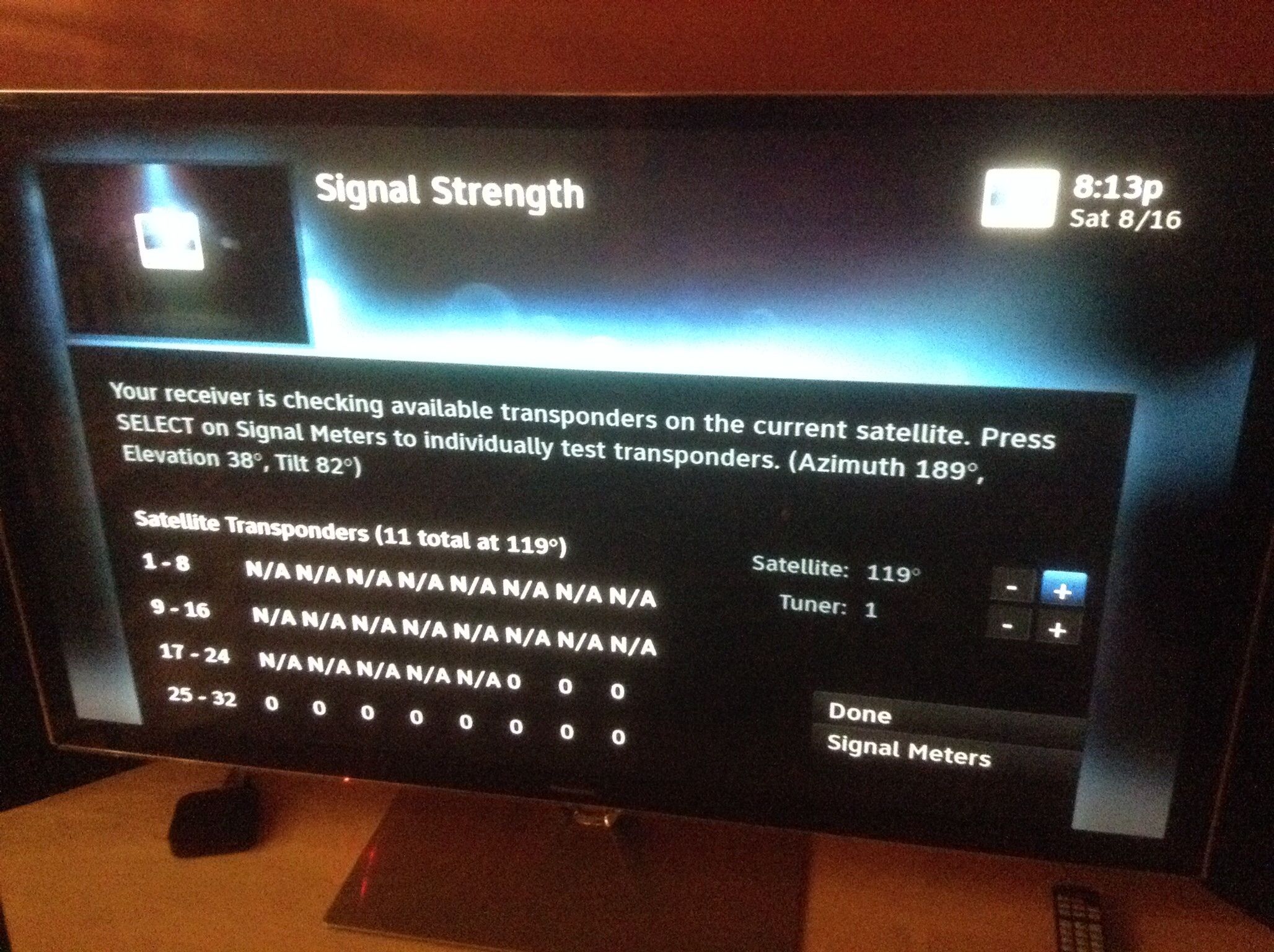

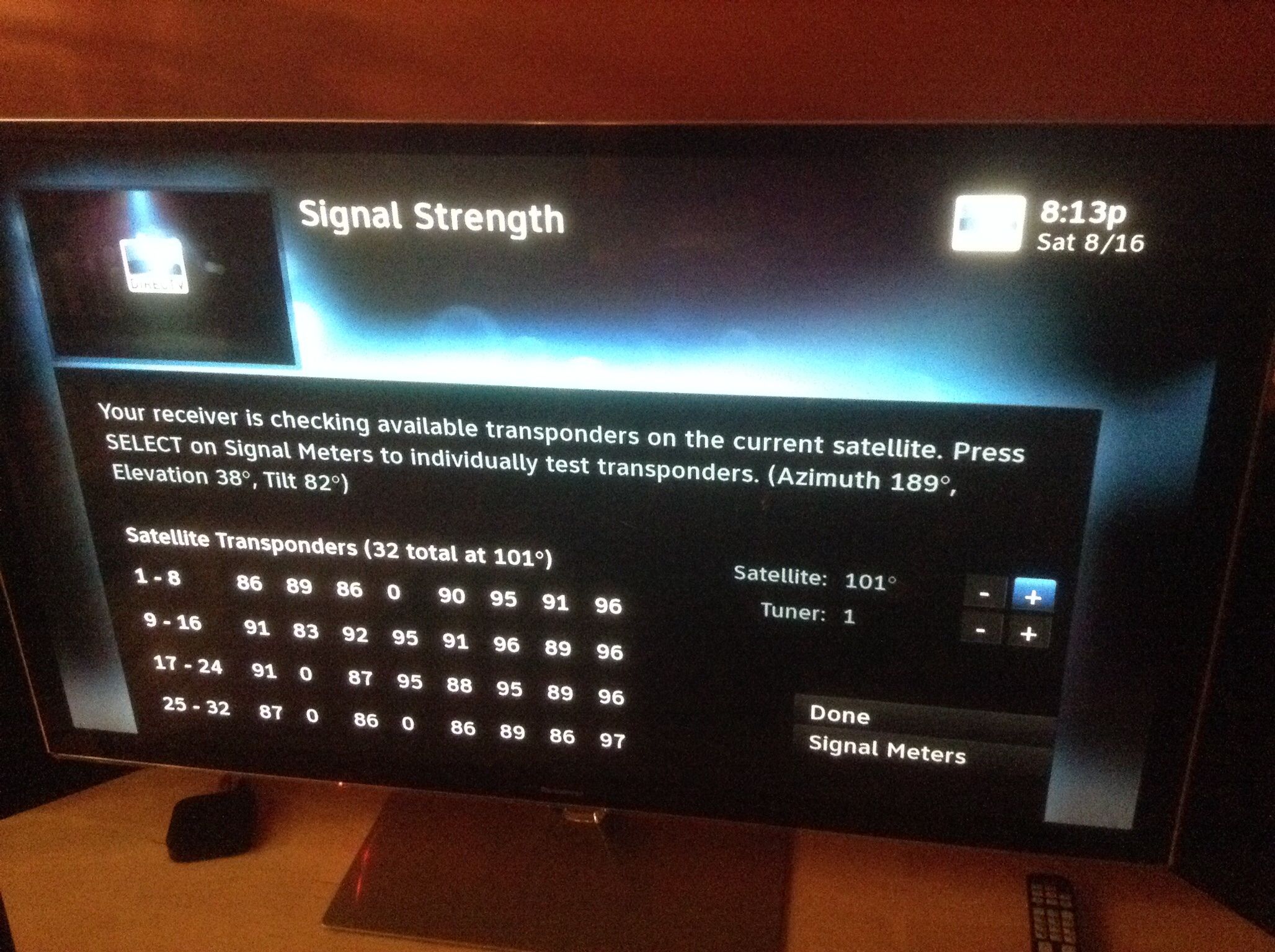

Here are my signal readings 101 is 88%, 110 is 0, 119 is 0, 99(c) is 83%, 99(s) is 0, 103(s) is 0, 103(ca) is 0, and 103(cb) is 74%. The basic dish alignment was set by the receiver set up info which is A=189 E=38 T=82. All this is correct and did minor tweaking with a basic signal meter to get peek signal. I still do not get discovery hd, tlc hd, foodnetwork hd, animal planet hd and so on...
What am I missing? Is there a better or a affordable meter I should get? Should I switch the 5lnb to a 3lnb?
you are off alignment, possibly got a blockage. your 103 is weak, your 99 is fairly weak, and you are missing 119 altogether. 101 is pretty bad, too. If you can peak 101 a bit better and find 119, you'll be on the right track.
The chances of 119 being 0 while having 101 at all are slim and none. You most likely have a defective lnb or los issue for 119. The error about missing guide issue is directly related to your 119 signal. But it seems as everything needs to be repeaked.
:welcome to Satelliteguys Boatright!
As the others mentioned, you have either a bad lnb or line of sight issues. The guide data comes from 119 if you have a 5 lnb. You might want to check to see if anything is blocking your view to the southwest. Also check to be sure the mast and dish are tight. If it is a line of sight problem, a 3 lnb may be your best option.

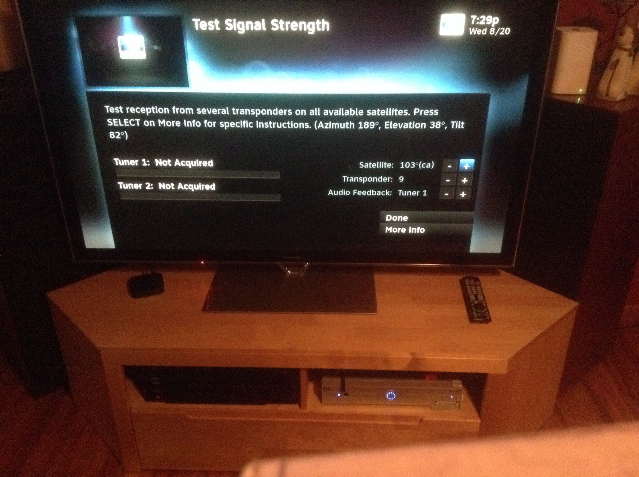

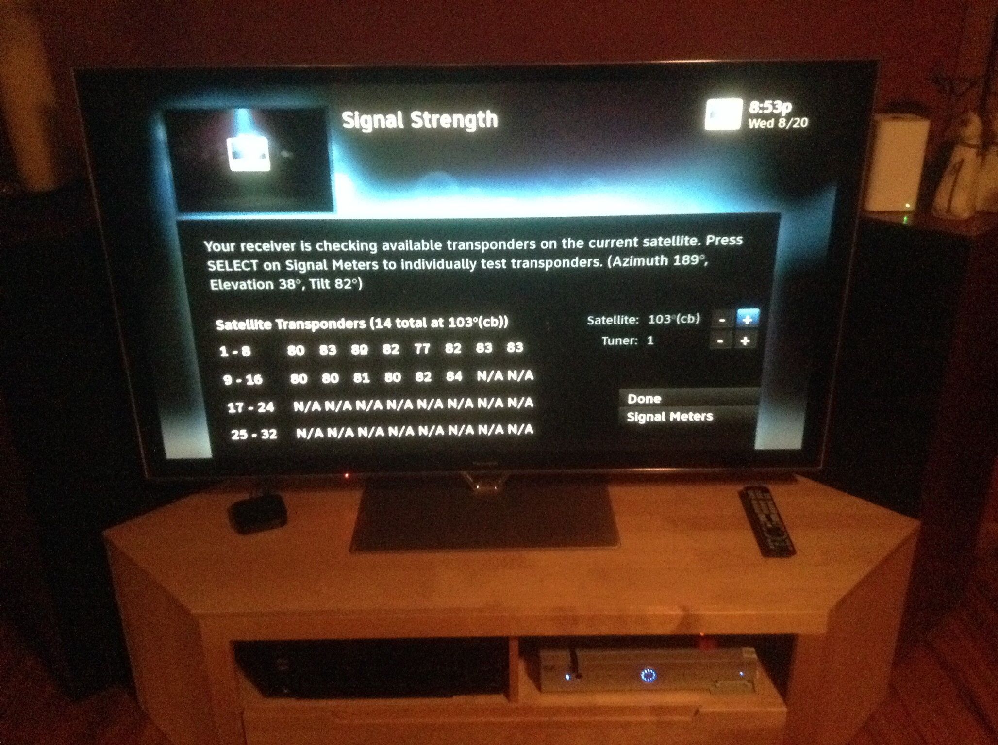

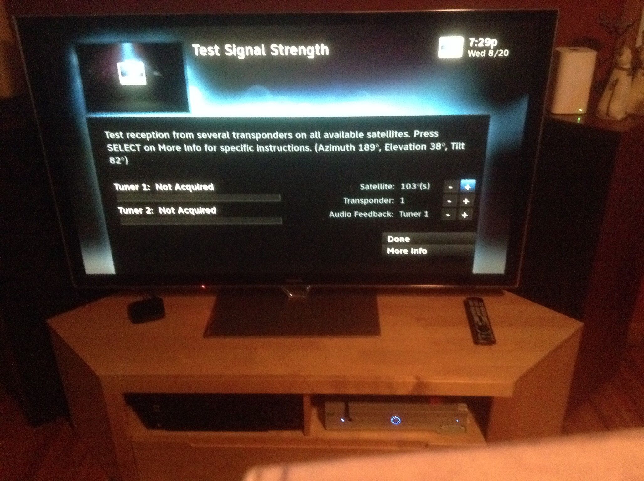

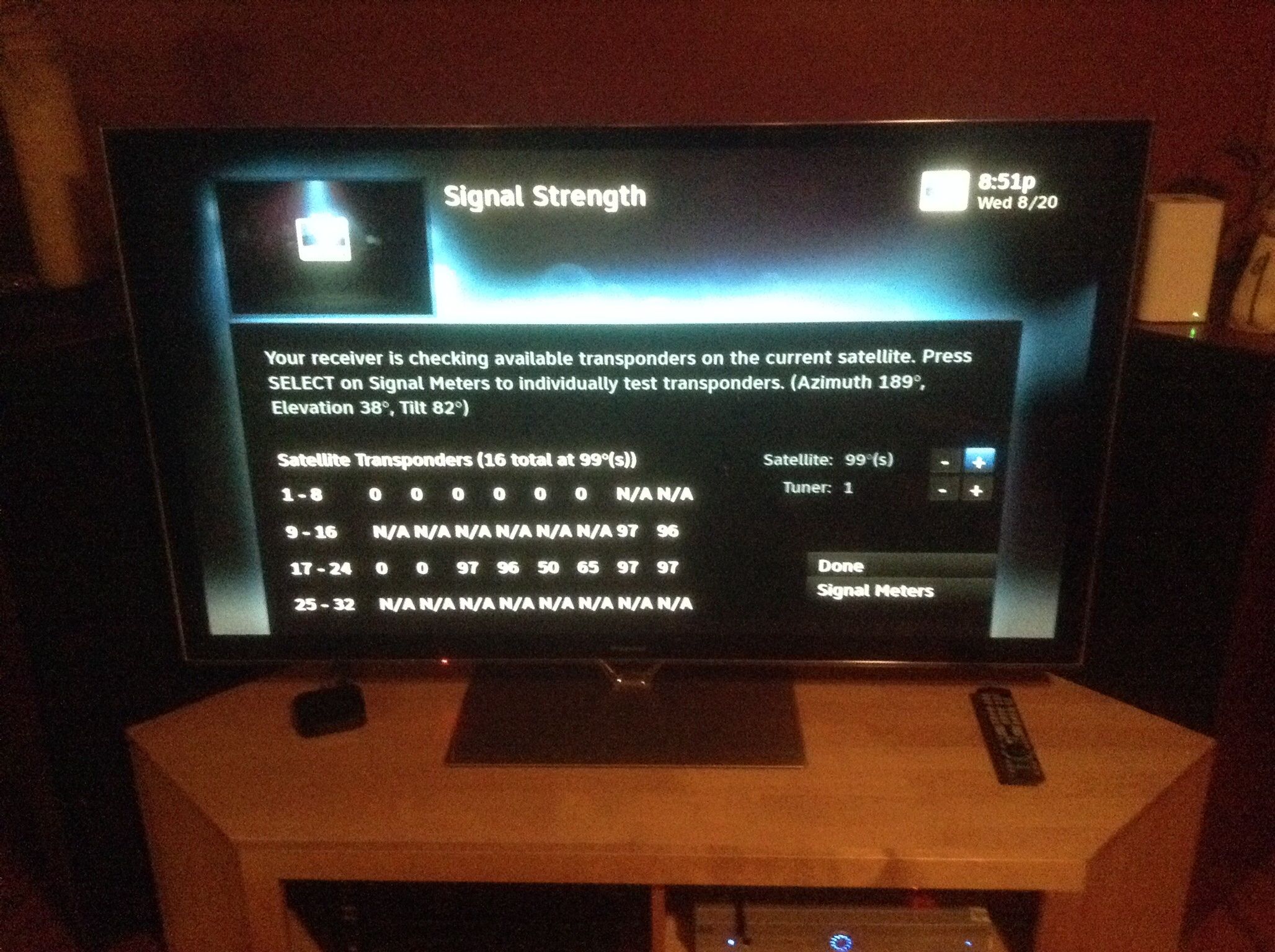

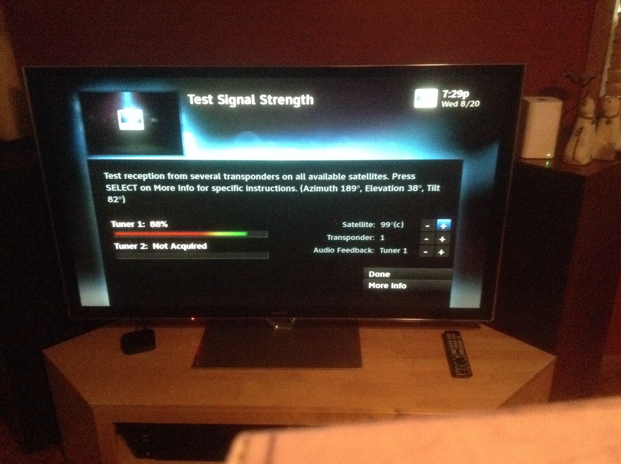

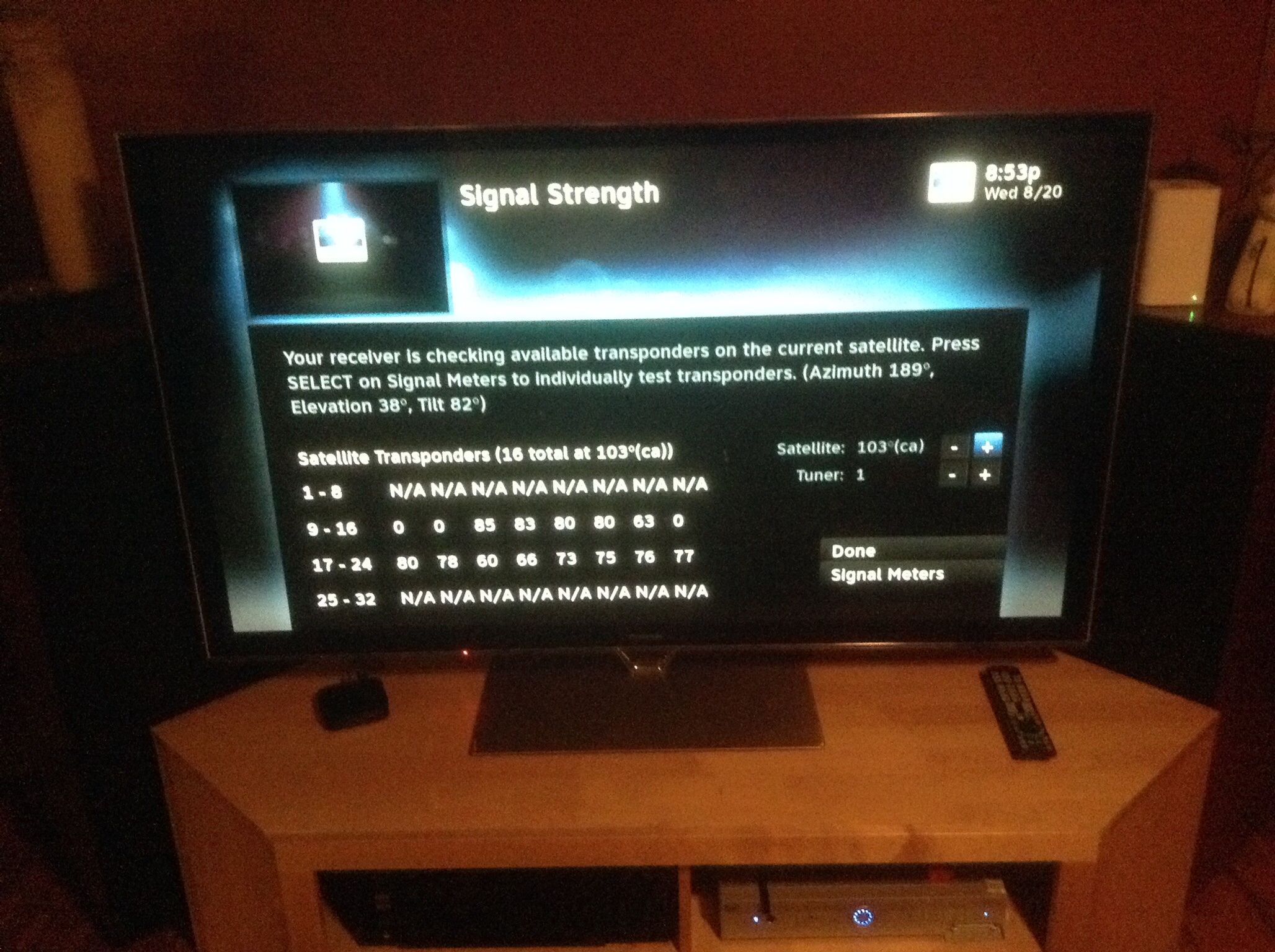

Thanks to all for your reply. There are no obstructions, clear sight line. I'm thinking at this point it's gotta be a defective lnb. I'm thinking of a 3lnb for a replacement. What is an affordable signal meter that could help me out? Here's the signal info.

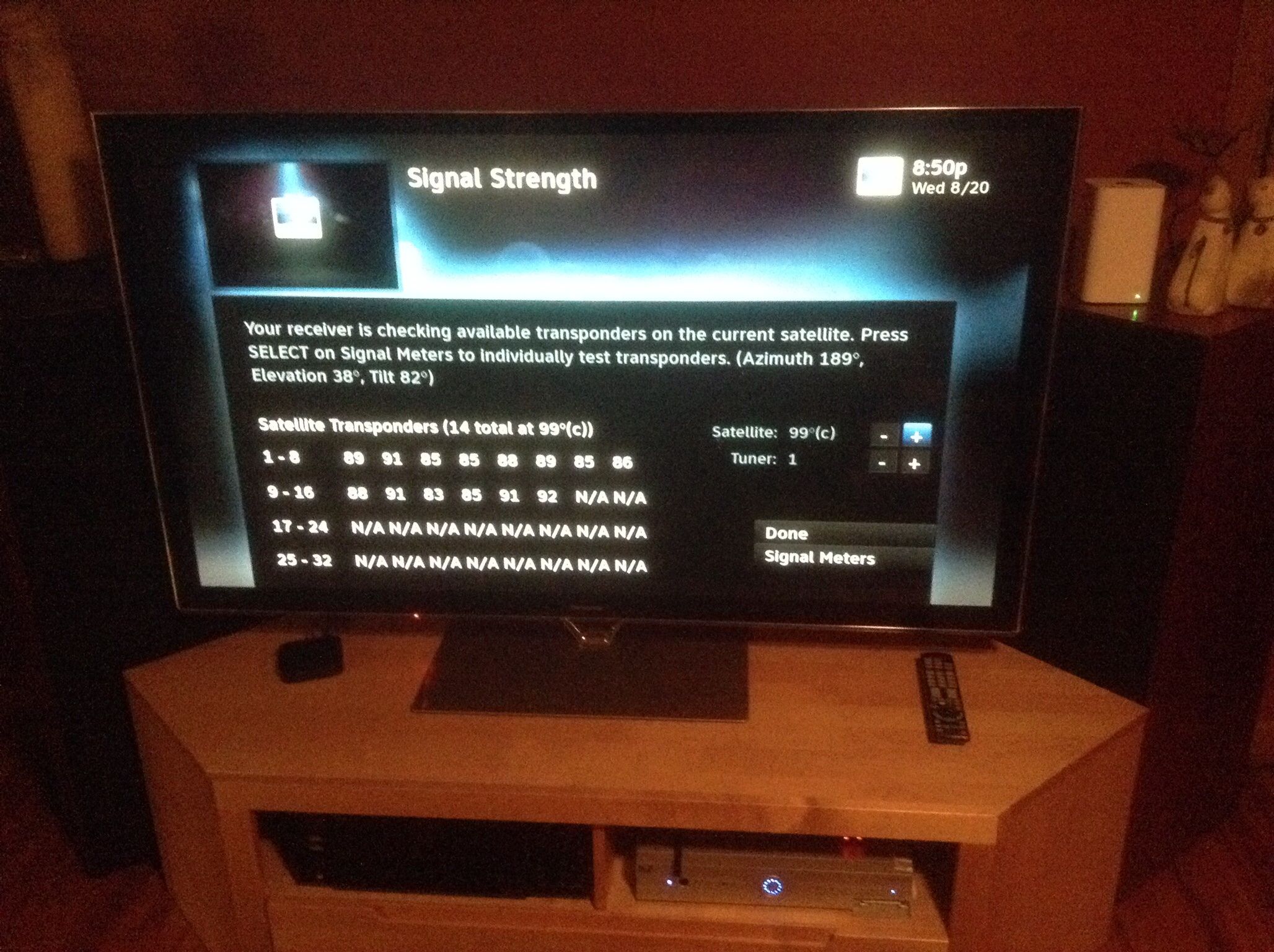

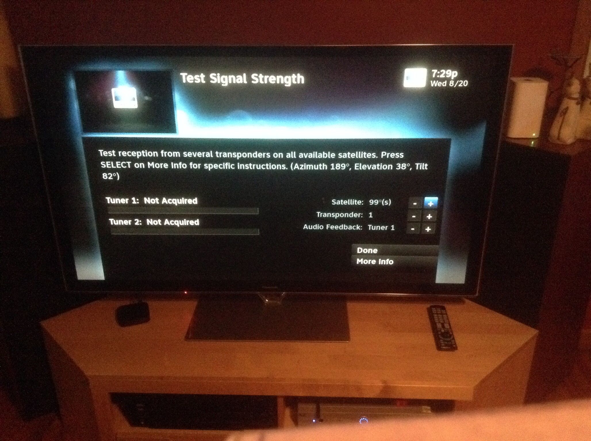

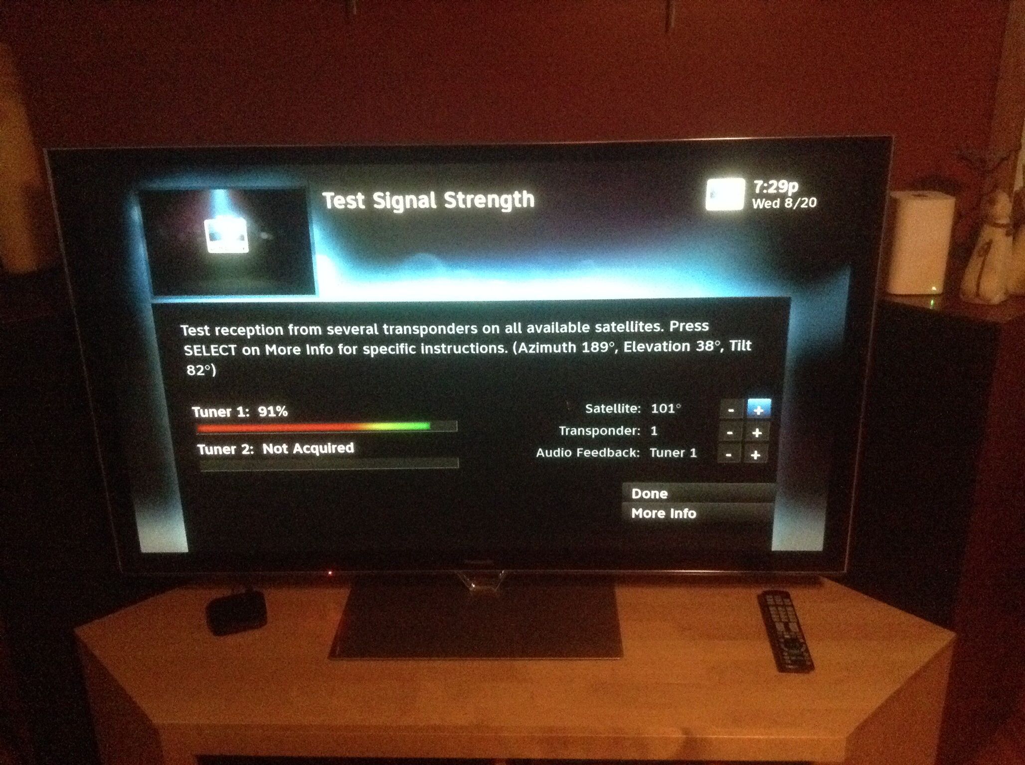

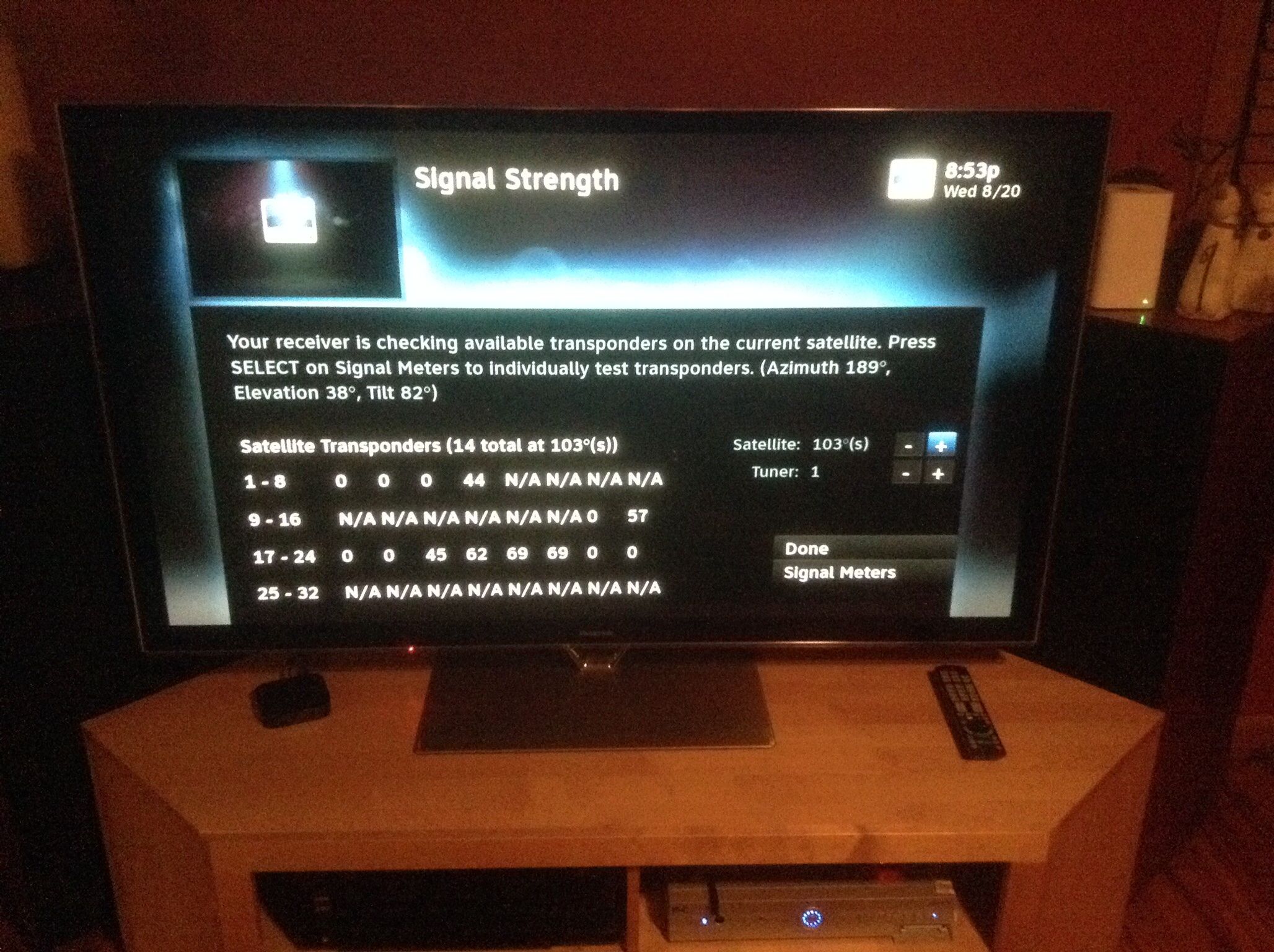

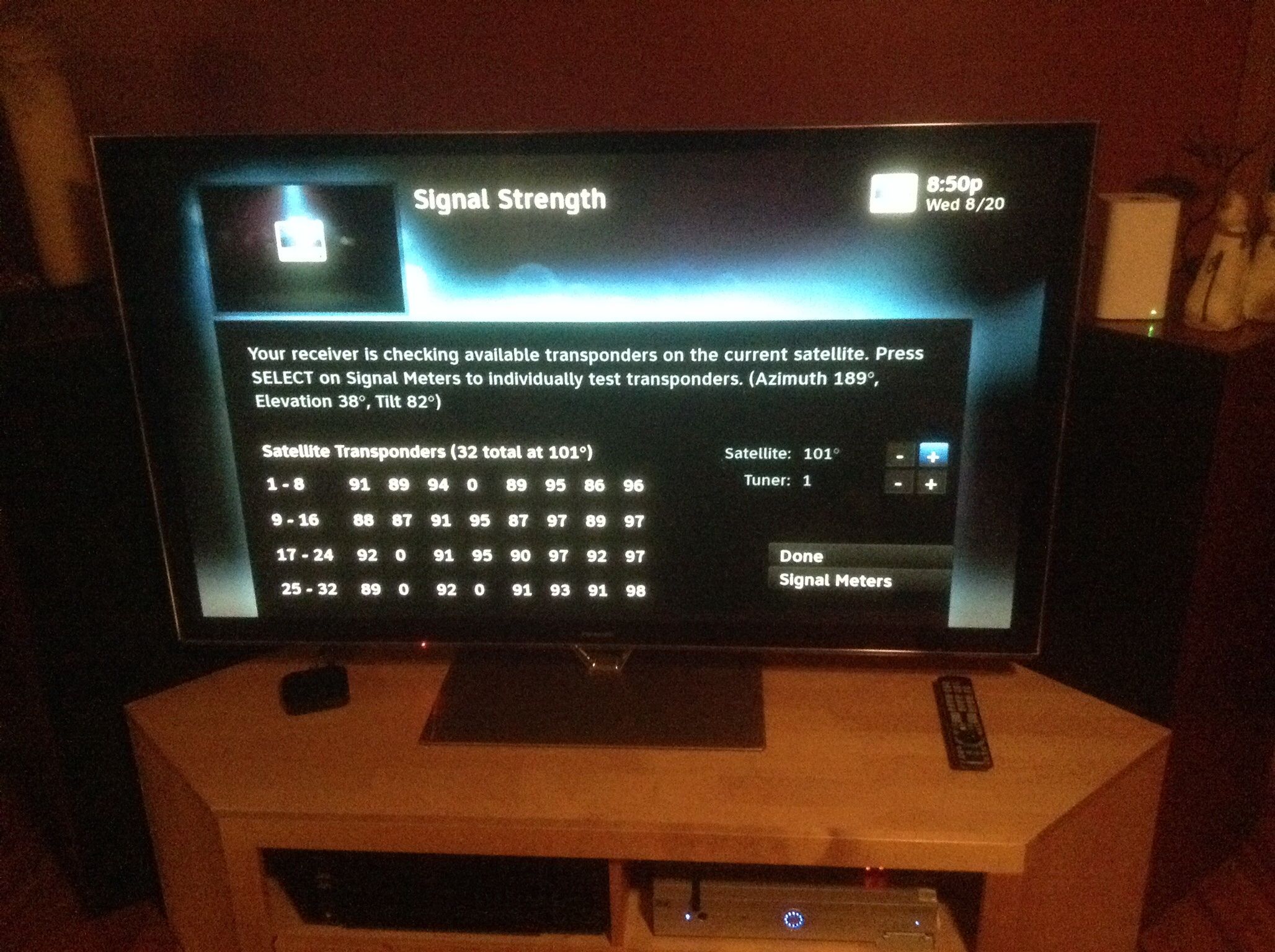

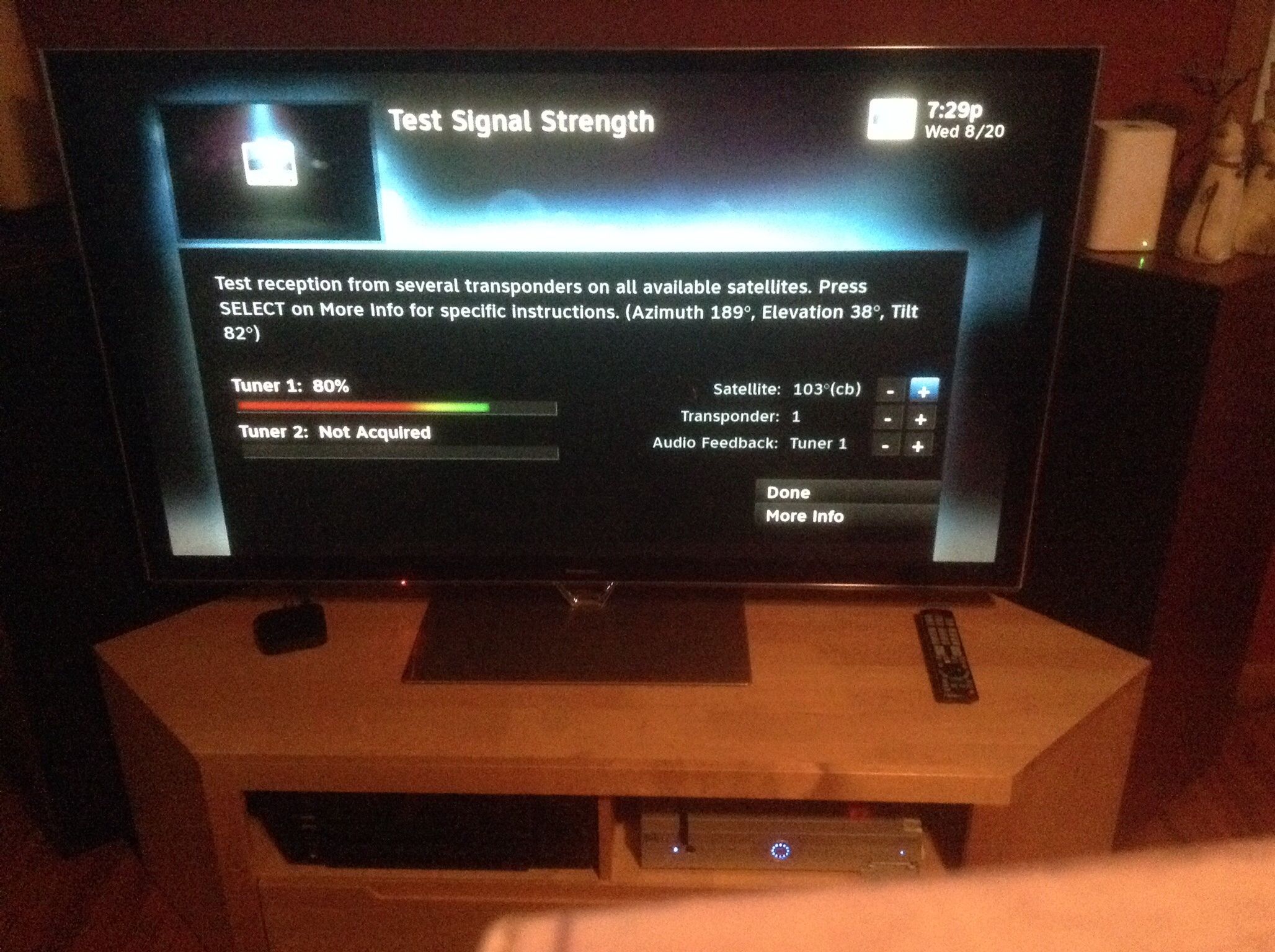

Ok here's an update. I took all the suggestion and this is what I found. The mast wasn't perfect, level, but not plumb - made the slight change and it's perfect now. I had a 5lnb and replaced it with a new 3lnb.
The result? Sadly after hours of dinking around it's still the same problem, no had channels or I should say very few. It did improve the signals on some satellites and none on others. Pics attached.
Is this a swm setup? If not, do you have two cables from the lnb? Did you redo the satellite setup and change the lnb type?
No swm. Yes, I did change the set up to a 3lnb. Yes, there are two coax cables from the lnb going to a hr-20 using b-band converters.
Also, I only have one tv. The set up couldn't be anymore simple
Try swapping the cables. If the no signal issue moves to the first tuner, then you have a bad cable or connector. Also, try using the other ports on the lnb. One could be bad, although not likely. Can you post the signal levels for all the transponders on 101, 99c, and 103ca and 103cb?
Those numbers aren't great, especially on 103ca/cb, but you should be getting all of your hd channels. The dish still needs to be aligned better. You may have a bad bbc or two. What about the signal levels on tuner #2? If they are essentially the same, don't bother posting pictures.
