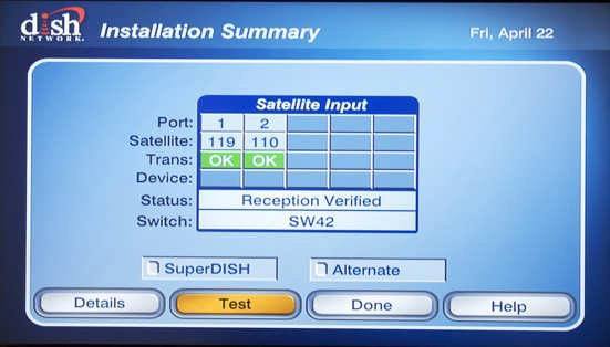

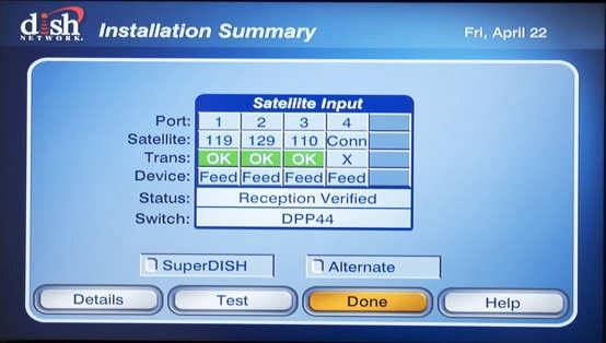

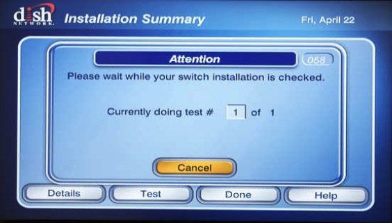

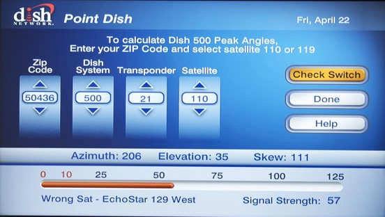

Are you talking about the switch test?
chkswch-step-04.jpg chkswch-step-05.jpg chkswch-step-06.jpg chkswch-step-07.jpg

MENU - 6 - 1 - 3 is what he's talking about. What are your drift numbers? Do you have any switches or just direct runs to the LNB? Try unplugging ALL equipment (switches/receivers) for about a minute, replug, run a check switch on the problem receiver (MENU - 6 - 1 - 1 - Check Switch - Test) then go back to Sys Info (MENU - 6 - 1 - 3 m) and hopefully box A should now say "Good."
