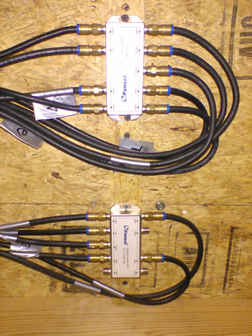

As the picture shows, I am using two switches. I have checked each satellite without the switch and it didn't do it hooked direct to the dish. However, I changed both switches when I rewired the dishes. I'm using 8 dishes, so running a movable dish for each room is kind of not what I want to do. I'd rather have all the dishes hooked to two switches. It's much easier for my wife that way.
Danristheman's suggestion earlier might be something I may have to try to eliminate the problem. :)
