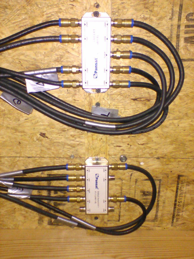

These switches are not powered. The STB supplies the power when a satellite is selected. View attachment 138709 This is the switch I'm using. Getting a voltage reading at the port or at the LNBF would be hard to do since it only loses signal for a few seconds. I'd never have time to get the cable unhooked to check it. I noticed on Galaxy 17 when the wife's watching Light TV, every channel loses signal.
It doesn't happen on one polarity or the other all the time. At this point, I am open for suggestions on what powered switch would be the best option. I assume with a powered switch, all ports would set up using a 22khz tone?? :)

Is that switch outside?
Yes, it's outside, but not in the weather. They're mounted inside a box. :) IMG_0008.jpg

Unfortunately, the signal loss is not consistent or predictable. I may not have been clear about the longevity of the signal loss. It can be reproduced by playing with both receivers, but the combination of circumstances may not be the same the next time. That's what so frustrating. I wouldn't have a problem purchasing powered switches, especially if it fixed the problem.
At this point, it's more of an annoyance than anything. It could become a problem if I start losing equipment, but so far, no problem with trashing equipment. :)

I wish I could be more specific about where the problem emerges, but when it happens, it doesn't last long enough to do any real testing to see what's going on. I've checked between all 16 coax grounds to see if there was any sort of voltage present. I have also checked between ports on the switch to see if there was voltage present on the ports that should not be active.
I did it by leaving one dish hooked to the switch and tuned to an active channel, while checking the other 7 ports for voltage. Found nothing. I've moved that cable between the other 7 ports, and did a similar check on each port that should not have voltage present. Found nothing. I even checked all the cables that were not hooked to the switch during the test to see if there was voltage present on them. Still nothing.
After running a new drop from the breaker box to the room where the 2nd receiver resides, observing the polarity on the new outlet, the problem persist. The outlets for the receivers in both rooms are tied to the same side of the buss inside the breaker panel to avoid problems that could occur from being hooked to different legs on the transformer.
If Titanium recommends a particular brand of powered switch, I will order two of them and give it a try. Living in the country presents all sorts of obstacles when you get power from a company that isn't interested in maintaining its power grid. I've been fighting for over three years to get the supply line to the house replaced due to its deteriorating insulation. Their solution, tape the wires with the cracked insulation. They even suggested I do it. :)

Actually, I am not cascading switches, but there is one for each output on the dual LNB's. I'll go into setup and check the reissue DiSeqC command and see if that corrects the problem. I remember seeing that option when I set up the receiver. I did see a EMP-Centauri on EBay and it specified a 5db insertion loss on a 16 port switch, which is 2 db higher than the ones I'm using now.
For now, I'll go to setup and have the receivers resend the DiSEqC commands and see what happens. I appreciate the information. :)
Update: I went into setup and set the receiver to repeat the DiSEqC information, and so far, I have not been able to duplicate the problem. Maybe that will take care of the problem. Thanks again. :)
