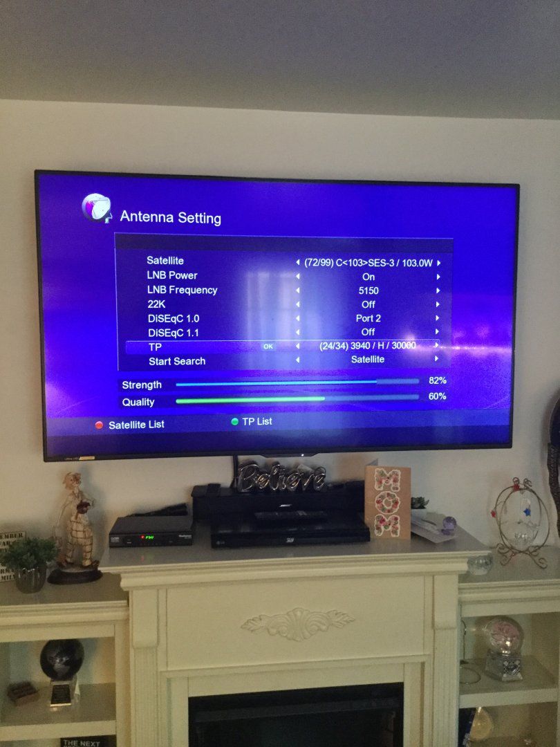

There both stationary dishes in the Manhattan reciever it has lnb power on or off and gives you a drop down menu for the lnb settings as far as the readings go I haven't taken any measurements. Thanks for the response
I will give 103 a try as far as the skew I moved the lnb and adjusted it to the best
Quality
If your selections are: 13 or 18 or ON, select ON.
If you could answer the remainder of my questions from post #2, it would help knowing your system configuration and signal path for troubleshooting.

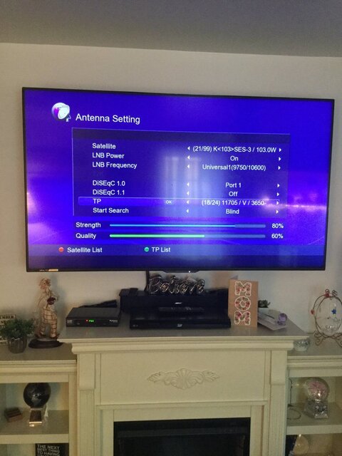

My list of transponder doesn't show 3972V14800, I have a 3650V11705 at 80 sig
Strength and 68 quality scanned the TP and nothing loaded also being a newbie
What is SQ
The Manhattan has a list of the transponders for each Satellite and a lot of them I see on the satellite channel charts aren't listed.
103w doesnt have transponders below 3700, so that tp is not correct. All TPs on 103w are between 3700 - 4200MHz. Ypu may need to manually add a TP if it isnt in the list or won't blind scan. How about on 4140 V 3000?

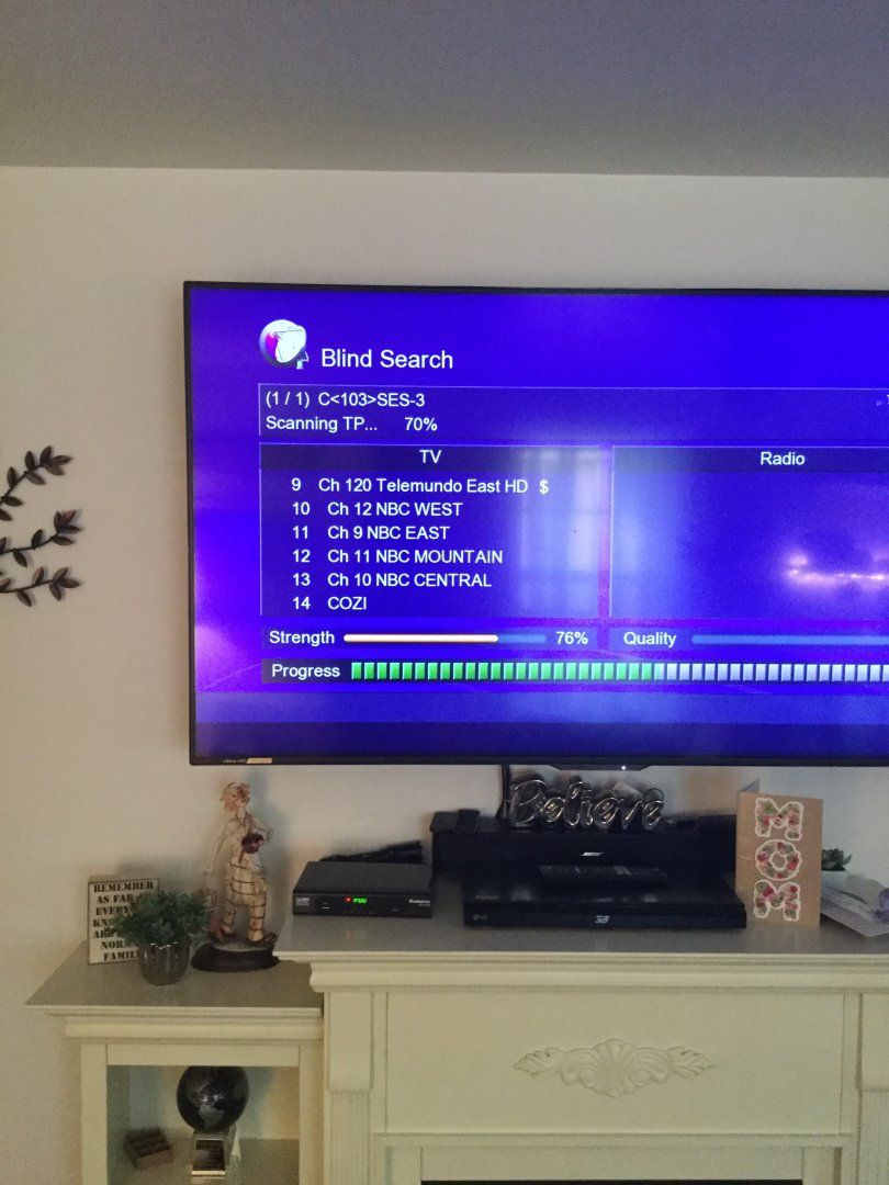

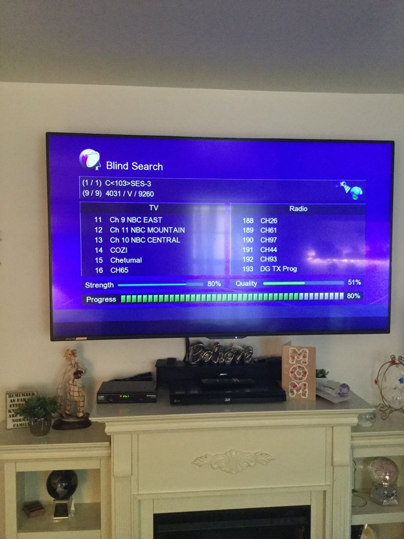

Do a Blind Scan of ALL not just FREE TV and Radio services. Are more FTA channels logged?

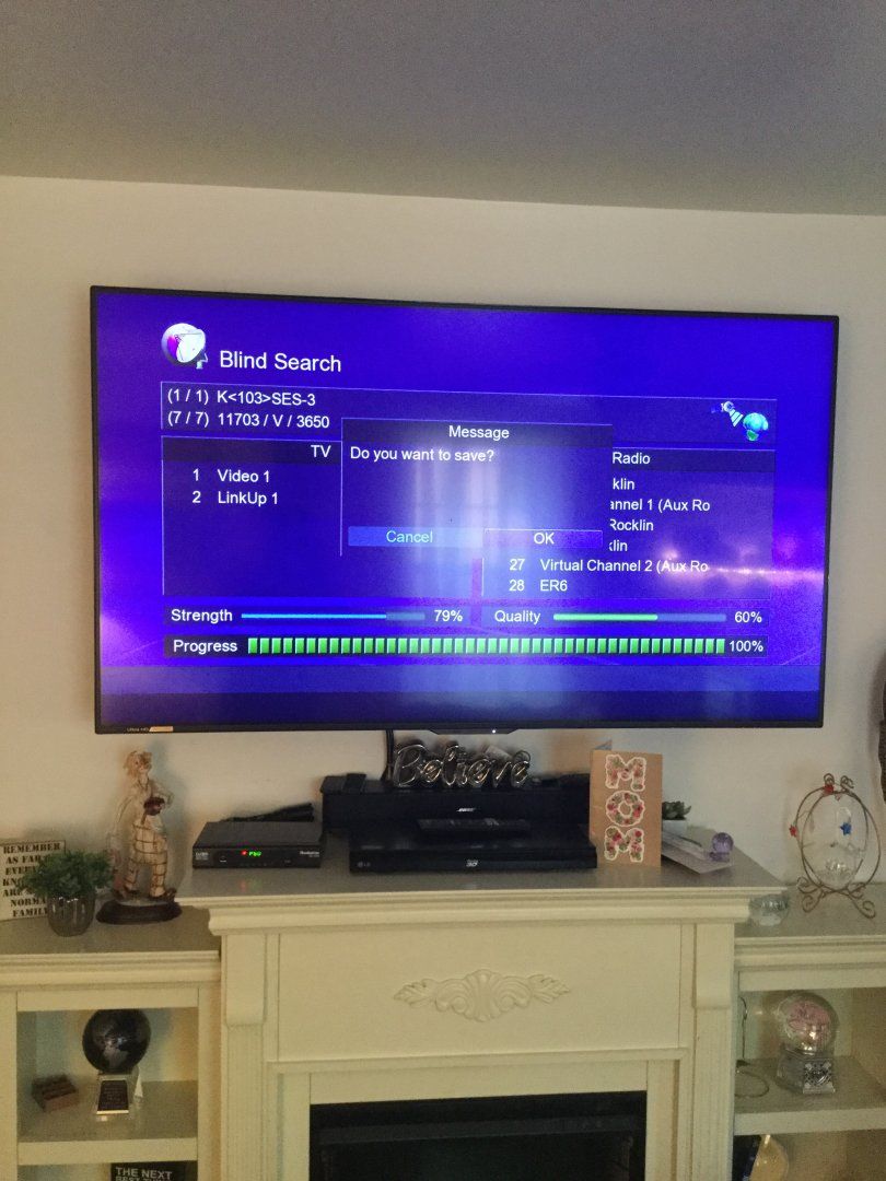

Are you sure you are on 103W C-band and 101W Ku-Band respectively? Can you give a list of those channels you scanned in, including the frequency and symbol rate?
The reason i'm asking is that one of the most common problems is that people think they are aiming at one satellite and are actually aiming at another, and of course are not receiving what they expect to receive...

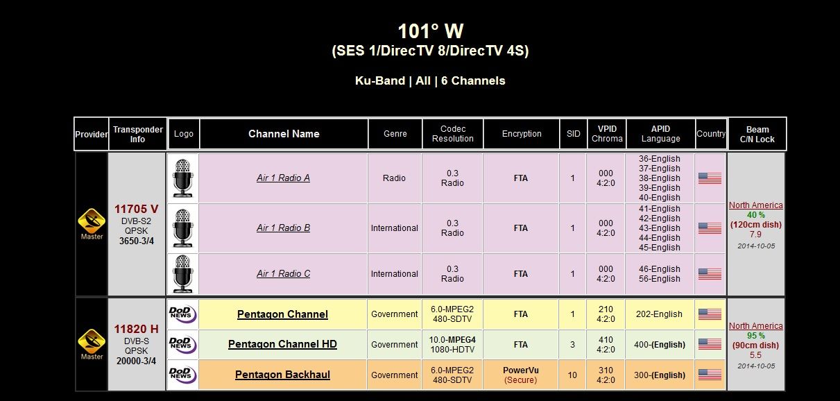

I have a 3650V11705
As Titanium mentionned, that's outside of the C-Band range that we would find in that region. However it might be a valid transponder on some of the Atlantic satellites, but those are far from 103W... Another possibility is that you got C and Ku mixed up and are actually looking at Ku. But i'm not finding anything that matches that Symbol Rate. Can you double check that you gave us the right numbers?
He's reading it backwards, AND that's 101W. Also, that's RADIO only. Not sure about his receiver, but likely he has to switch to the "radio" side on the remote to hear it.
Make sure that when connected to the C-band LNBF that you select 103w C-band from the satellite list.
If you have any splitters or switches in line, remove and direct connect the coax from the receiver to only the C-band LNBF for this test.
