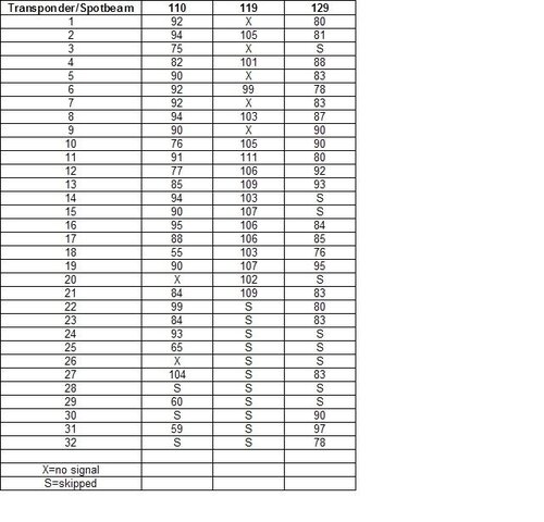

Finally after a few days of rain, better day came along. Tonight I checked my 622/1000 settings and recorded results I pasted in attached image (only way I was able to keep formating).
Let me know if this looks OK, normal (or not)...or if you guys need any other info.

leave it alone.....it's fine..you should thank your tech for being concerend with your home....
