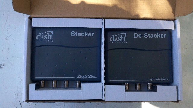

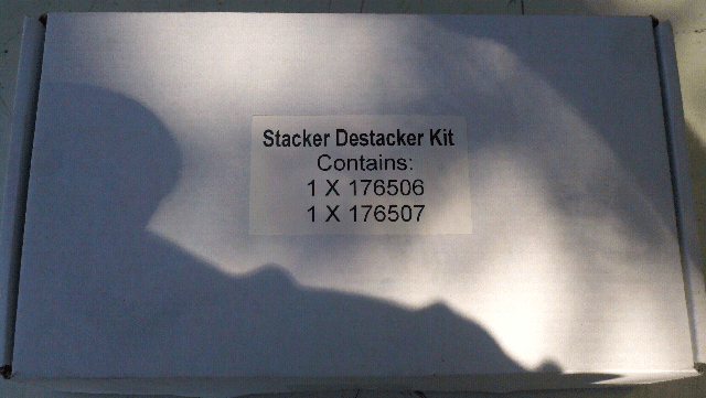

This is it

I have never seen a stacker/destacker kit (wish I would have seen one of these a long time ago) but from the sounds of it, it is the only option.
