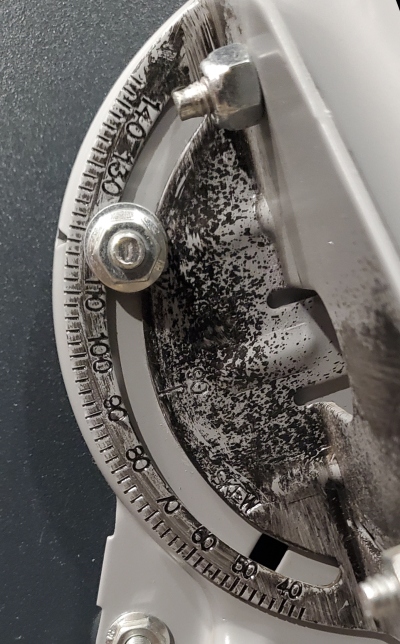

I decided to have a look at my 1000.2 skew scale. It runs from 40 to 140. That leads me to believe that I should use the app that gives me 3 digit figures for locations in central
Texas. ie DishPointer - Align your satellite dish where I input Lat & Long in decimal degrees and choose Dish 1000.2 (110W, 119W, 129W).

I would say that 120 is way more accurate, although it's 120 I Central IL, too. and here's an easy way to tell. The dish is reflective. From behind the dish, the "eyes" left to right are 129, 119, 110 - the opposite of how they are situated in the sky, where 129 is the furthest west and yes, I know, 129 is gone but for this example, I'm using it.
129 is also the lowest in the sky, 110 the highest, which explains why it's the highest at the dish. Reflective. So it skews to the right.
Eastern arc, just the opposite. If you're standing behind the Dish pointing to the 61.5 and 72.1, the Dish would be skewed to the left, or the lower number. For here, it's 70.
Unless you're traveling super long distances, you really won't need change the skew at all. In my work area I use the same skew in all cities and sometimes that can be a 150 mile radius (or 300 mile stretch) and I'm sure it would still be fine further than that.
