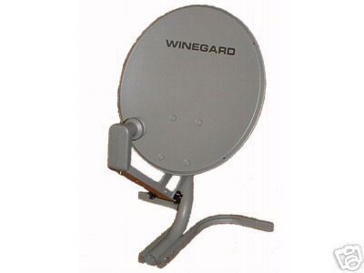

Wanting a Portable Satellite System for my Motorhome and not checking everthing out I purchased a Winegard model PM-2000 Portable Satellite Antenna and Tripod from Camping World. I left the small stand off the dish and installed it on the tri-pod. The dish is a single LNB. I finally got a picture after setting in the Skew, but with a single LNB is that needed? Could I have just been off on the Azimuth & Elevation? The dish did not come with a Skew setting so I just extended one of the tri-pod legs to tilt the dish. I also noticed in the Camping World Web Site that this Dish isn't recommended for the 500 Dish system, anyone know why? But at the store where I purchase the dish they said that this dish was all I needed.

Just called Dish TV technical support they said the Skew was still needed for Maximum Signal off their Satellite. Called Direct TV they said that the setting wasn't needed for a single LNB. Dish TV also said that you need a zip code to setup the Azimuth, Elevation and Skew, all three change with a different location. I asked Dish where I could find a zip code hundreds of miles out in the wilderness in my Motorhome, they didn't have an answer. Tomorrow it's out with Dish TV and back with Direct TV. I think I'll try the HD this time around also.

The only time you don't need skew is if you are aiming at a satellite that is exactly south of you. the skew is required because of the "skewed" view of the satellite as you turn the dish towards the satellite (with relation to the earth). You can either skew the dish, or just skew the lnb (if you have a dish/lnb setup that supports skewing the lnb).
If you bought an 18" dish with single lnb, then it wont work well for dish500 - which is a 2 lnb system that uses a larger dish to handle the less than optimal aim at two separate satellites. Of course, you can still get all of the content with one lnb/dish that you would get with a dish500, but you'll have to manually move the dish to view each satellite separately.
Single circular LNBF DOESN'T REQUIRED setup skew !

While it is true that circular signals don't require skew in the sense that linear signals do (which I admit I had neglected to consider since I don't ever work with circular sats), it is my understanding that an oblong dish (which the dish in question may or may not be) still requires skewing when not facing south. The reason is because the entire width of the dish is not realized unless the dish is skewed in relation to the direction of the satellite as the skewed view of the satellite in relation to the horizon from the dish's location.

Yes you can turn a circular dish 300 upside down and it will still get the same signal. Skew does not matter on a circular single lnb dish. If it was oval or dual LNB that goes out the window.

xMike's dish a a round dish with a single LNB. There is NO skew adjustment on it because there is NO skew needed. In your receiver menu, this would be called the Dish 300.
What do you understand to be a 500 Dish system as mentioned in Camping World? The Dish500 is a dish. It's DishNet's twin LNB oval dish, which does require a skew adjustment to maximize both LNBs signals.
Just about every Dish Network receiver will work with this dish. I think what the Camping World article you mentioned may have meant was, since Dish Network uses two satellites for all of their main programming, they don't recommend using a single LNB (single satellite) dish. Otherwise, you'll be bytchin and moanin about not being able to pick up <X> channel because it's on the other satellite. So you go retune the dish to the other satellite, re-run Check Switch, watch <X> channel, then try to flip to another channel and you can't get it because it's on the other satellite! :D
Bottom line is, if you're using a Dish Network receiver, buy a Dish 500 dish. It's just about as easy to align and there will be less cuss words coming out of your mouth. And yes, you'll then have to set the skew :D

The most important thing in setting up a dish is making sure the mast is plumb on all sides. Use a level, not your eyeballs. If the mast is off by an RSCH, or other hair, you will be several thousands miles off in space. Since you had to kick one of the legs out to get signal, I suspect your plumb was off to begin with, and then 2 or 3 wrongs made a right. :)

Before you take a trip, go to this web site, click on Search by City, and find the Zip Code for each of the Cities you may possibly set up camp in or near.
At the Point Dish Screen, Select Dish 300, put your Zip Code in, then select the Satellite and record the settings.
As previously said, I think I would replace a 18" 1 LNBF dish with a 20" 2 LNBF dish (Dish 500 with DP Twin). Then follow the same procedures above, but select Dish 500 and don't forget to set the Skew before anything else. Then do not adjust the skew, only the azimuth and elevation.
If you are still having a problem, drink a couple of beers and try again. :D
Once the "Mast is Plumb" it shouldn't take more than 3-10 minutes to set up.
Remember...
When you twist the dish on the mast left or right, moving it 1/8" could move it from the 110 satellite to the 119 satellite, so try to move it about 1/32", 1/16" at a time.
Also, it may take the receiver 8 - 10 seconds to recognize a change in signal when adjusting your dish. So it helps to have the Elevation set, then have the dish pointed close to the correct Azimuth using a compass.
