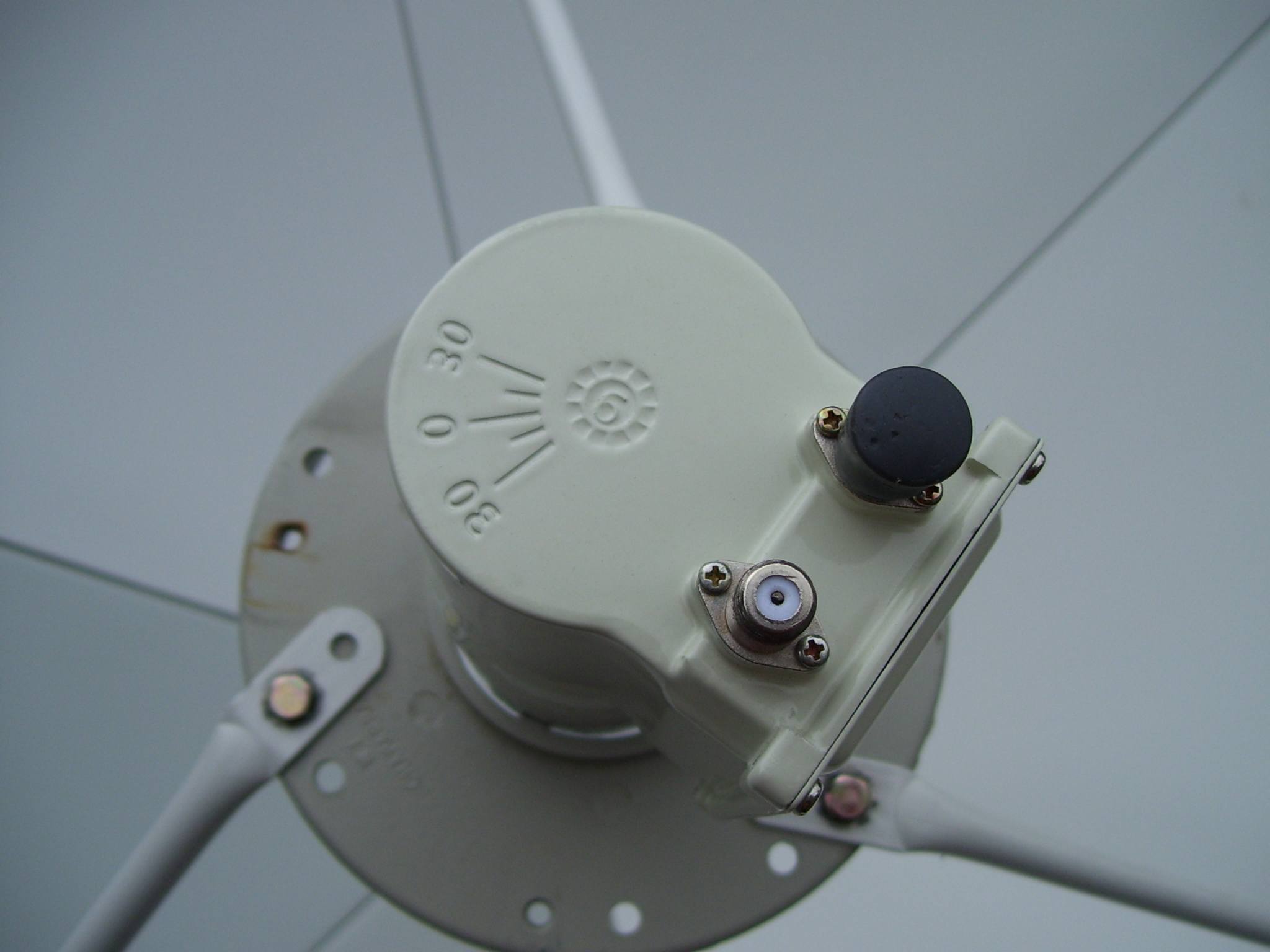

so 0 skew for me is at 9:00 or 3:00 (if like a clock)
below pic is set to 0 skew for my true south (well 91W...my TS is 93W but there is no C-Band there)

have you tried to blind scan? That is how I knew my 421 was off by 90 degrees by getting the H side on V and vise versa
open the cover and look at the probes inside. when parked at true south one has to be paralell to ground and the other one vertical. that is 0 skew for true south. if you selected them wrong then the TP's will scan in reversed (H as V and viceversa) but at least at maximum signal. you can then rotate them 90 degrees like Iceberg said.
