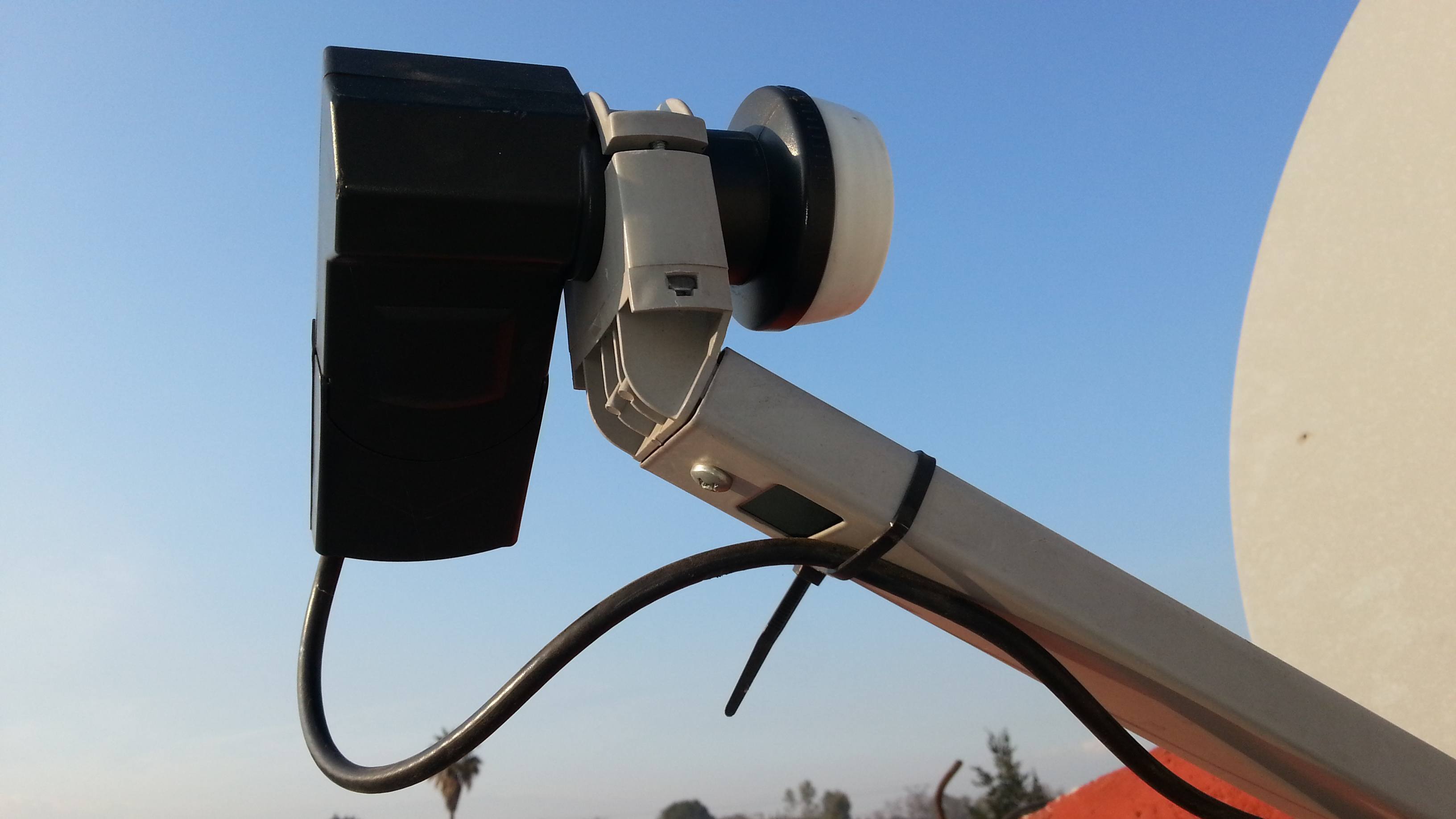

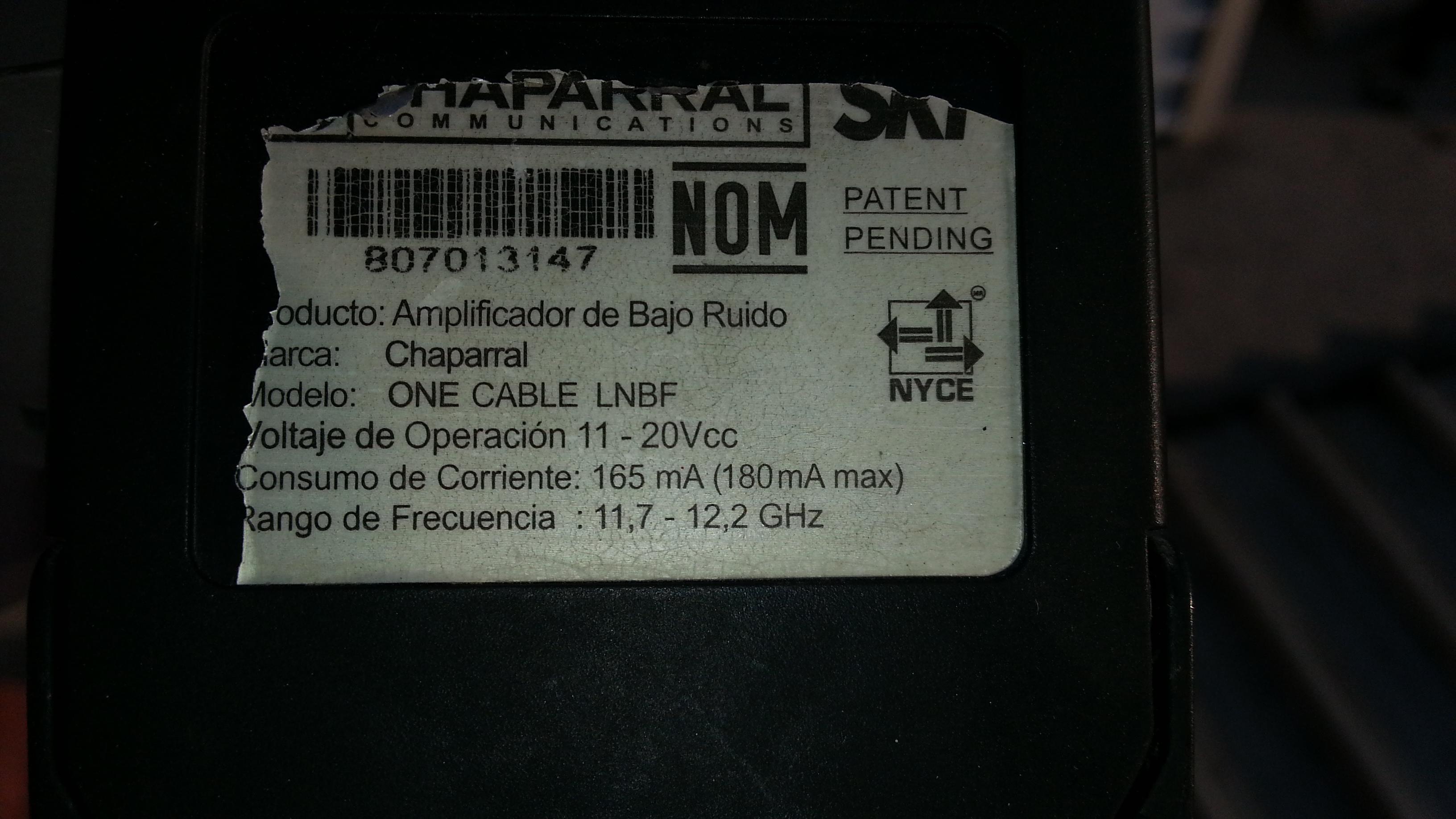

I was intrigued about why Sky Mexico would require a universal LNB, I received the attached photos from someone who has a Sky Mexico installation in Mexico City and you will see it uses a Standard LNB.
Maybe what Bryan said Universal was used in the past regarding of the old receivers and the installers does not whats going on..lol.. and still requiring Universal than standard..
I have used Standard set on 10750 and I can get Low frequencies signals like Hd in Fta receivers..To cascade your set up I prefer to use LNB Standard
