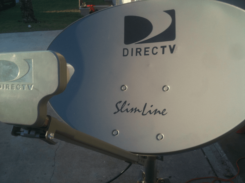

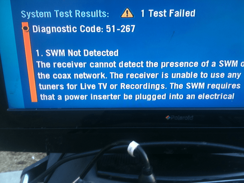

Just bought a Slimline 3 satellite for tailgating and will be using my neighbors H25 box as we tailgate almost everyweekend. I am getting 771a error and it says no SWM found and says I need a power inserter. Completely clueless. I have correctly setup the azimuth tilt and elevation but nothing.
Register to hide this ad

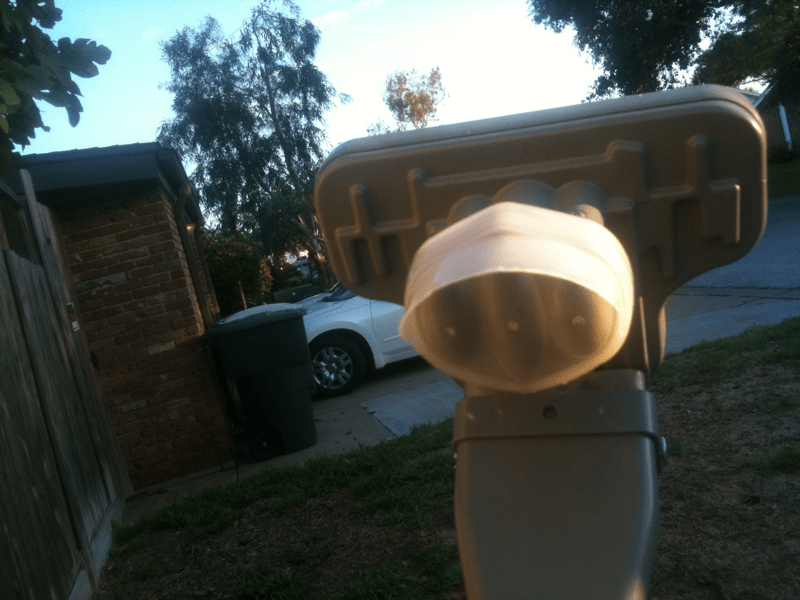

The H25 ONLY works with a SWM setup
The LNB has to have only one connection and you need the power inserter. If the LNB has 4 outputs thats the wrong setup and the H25 wont work with it

I was able to hit Satellite 101 with high 90's last night, but I was unable to continue after that, it would stay 0% when trying to update guide.

Yes, the bbcs are used to get signals from the hd satellites at 99 and 103, so without it you should be able to get sd channels. Are you sure you have a Slimline 3 and not a 5? How many pods are on it?

I could never exit from the guide update it would stay at 0% and not let me go anywhere from there and/or could never exit the setup menu's.
You would have to set the satellite setup to 18" round to get past that issue
menu
settings
system setup
scroll down to satellite
then repeat satellite setup
menu
settings
system setup
Iceberg you are the man, thank you sir!
