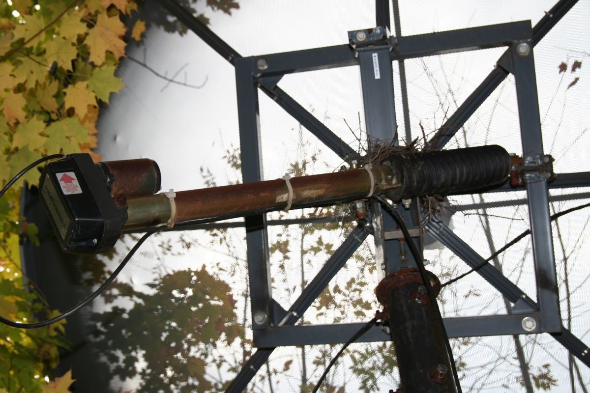

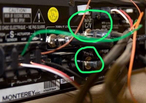

We are going to order Pansat2700, we may order the V-box at a later time. I took a pic of the back of the Monterey Receiver that has cables attached to both C and Ku coming from the dish, Does this mean or guarantee that the dish is both C and Ku capable?

No, that is the actuator on the back of the dish - it makes the dish move to point it. We need to see the front of the dish, and under the cover, where the coax hooks up.
Oops, I see I missed a page. BUT, NEVER trust a dish salesman to tell you if you can get KU band. AND there are PLENTY of FTA on C band digital anyway!
From the picture of the back of the reciever it looks like it could have ku. My idea is based on the fact that there is a red, white and black wire going into plugs that might say polarotor(it's not clear enough for me to to read). It could also be dual cband lnbs and the r,w,b wires aren't connected at the lnb. But it would still be better to get a picture of the lnb to be sure.
I agree with rv1pop, don't trust the salesman. It's in his interest to sell you something whether you need it or not.
good eyes SatPhreak :)
i did miss all the connections
