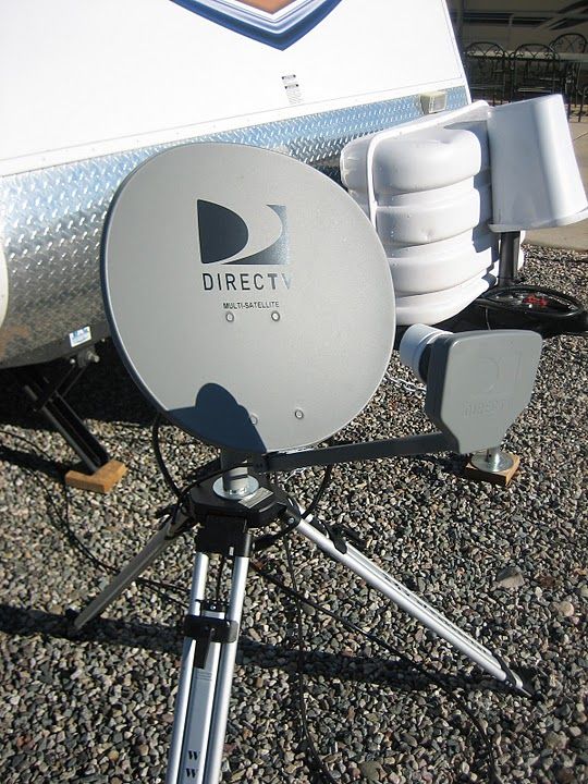

For a while I have been following a thread on DBSTalk where folks were experimenting with getting DirecTV HD from a smaller dish than the Slimline. It can be done.
You need:
DirecTV Phase III Multi-satellite Dish. Discontinued but can still be found. I got mine on eBay. This dish was originally mated with a triple LNB for the 101, 110, and 119.
DirecTV SL3 SWM or non-SWM LNB depending on your install. This LNB receives the 99, 101, and 103. Some installs require an SL5 as some Locals are on the 119. I don't know if an SL5 would work.
The SL3 fits the Phase III arm but you must cut a 1/2" long notch and drill new mount holes in the SL3. Some just force the LNB in and don't bother to bolt it in.
I also copied the TV4RV.com folding arm kit so this dish stows very flat.
Bottom line is that it works. I obtained the 101 easier than with my Slimline and the 99 and 103 were there too. You do lose about 6pts on the signal meter but I still got the 101 in the low 90's and the others in the low 80's.
I also copied the TV4RV.com folding arm kit who also makes the great tripod kit above. The thread is here:
How to Make Your Dish Arm Fold - Escapees Discussion Forum

BTW - I have been using the phase III/SL3 combo for a long time in a permanent setup & it works flawlessly! I chose to grind down the nub on the LNB itself rather than modify the dish arm.
