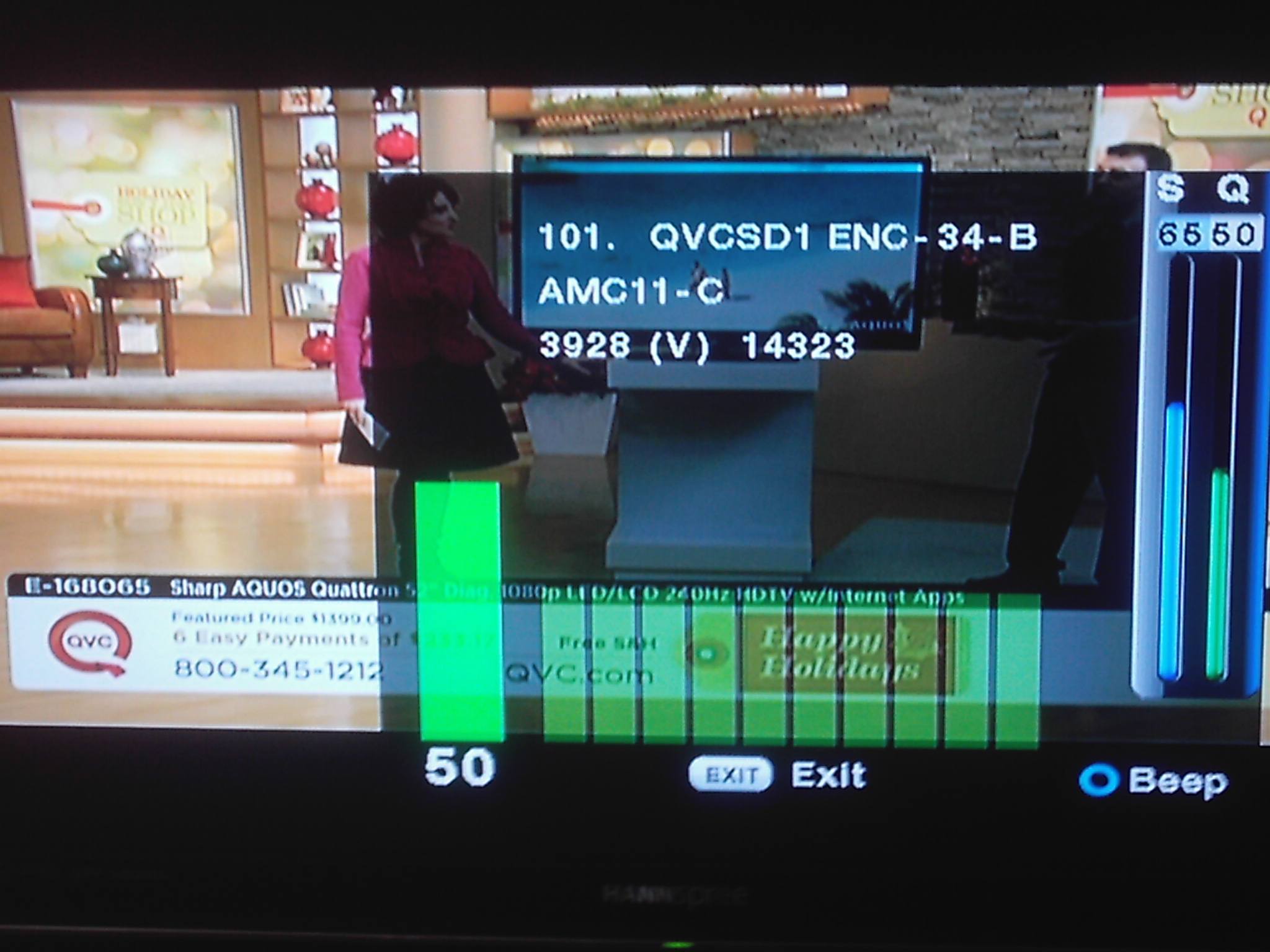

5FT C Band (AC3)
I used a 5ft solid metal dish set at 0.38 for my test. Geosatpro 1100c shows 50% Quality on AMC-11. Course it's audio is AC3 and I can't hear a thing unless I push it through a stereo. (One other thing.... you realize of course you are 'enabling' your Mom, by giving her that channel? ;>)
