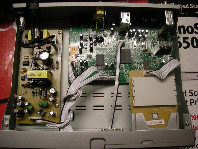

Here's a top view inside the Visionsat IV-200
The card reader is in the lower right of the picture.
It has firmware support for some cards, but none of the above-mentioned networks.
