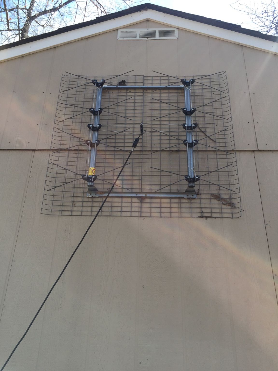

Below is my current UHF antenna at the trailer. About 39" wide by 3' tall. Similar to a CM4228, but not exactly. Facing 320 degrees.
I've been considering one of the Televes DAT-790 antennas. Would that be an improvement, once I mount it on top of the shelter, lets conservatively say, 20+' higher? Or just move the current one there?

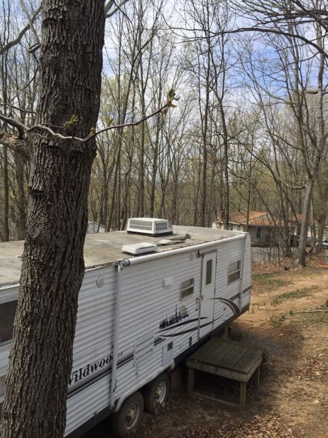

View from antenna today, at about the middle of the antenna. That is not my trailer, it's the one behind me and downhill.
On a tripod atop the shelter would still be thru some trees, but fewer trees.

Although you say it's not a CM4228, it sure looks like it, and I haven't found an antenna that works better than my two CM-4228's. I think if you raise it, navy chop, you'll be surprised at the results. Certainly worth a try before investing in something else.

My memory is that it is a 4228, but I looked at current pictures of the 4228 and it looks a bit different, and the size is slightly different.
