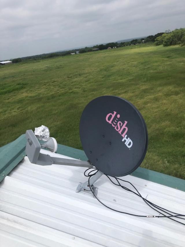

OK I guess I thought one LNB was for Sat 61.5 and the other for 72. But not getting a good signal on 61.5 but don't seem to be missing any channels
I only get sat 72 on one TV then I get 61.5 on the other. The reciver/tv on 72 work fine but nothing on the other TV/61.5
ONe dish
Foil is taken off that I was doing a test several weeks ago, someone told me that one was for 61.5 and the other was for 72
Once again, run a line from the dish to the 211 and do a switch test.
Run a line to the separator behind the 222 and do a switch test.
If the dish is properly aligned and the LNB is working then you're done.
Thanks I had a wiring error between running in the attic and back on the roof I missed something, thanks for your patience. But just to be clear each LNB brings in a sep satelite?
Reactions: JSheridan
The whole assembly is the LNB, feed horns and switch. The two feed horns each pick up a different satellite. All the switching is done in the assembly.
Just connect a wire from the LNB assembly to each receiver and you'll be good.
Each LNB receives a separate satellite but the LNB has a switch built into the LNB so each cable brings in both satellites from the two LNB's. That is why they are telling you to run a wire from the LNB to each receiver for a total of 2 wires. When you then do a check switch on each receiver you should receive both satellites. The 222 receiver needs a separator that connects the one wire to the 2 inputs since it has 2 tuners.
