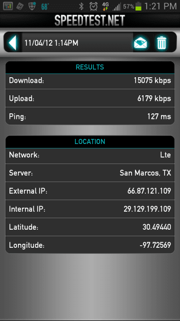

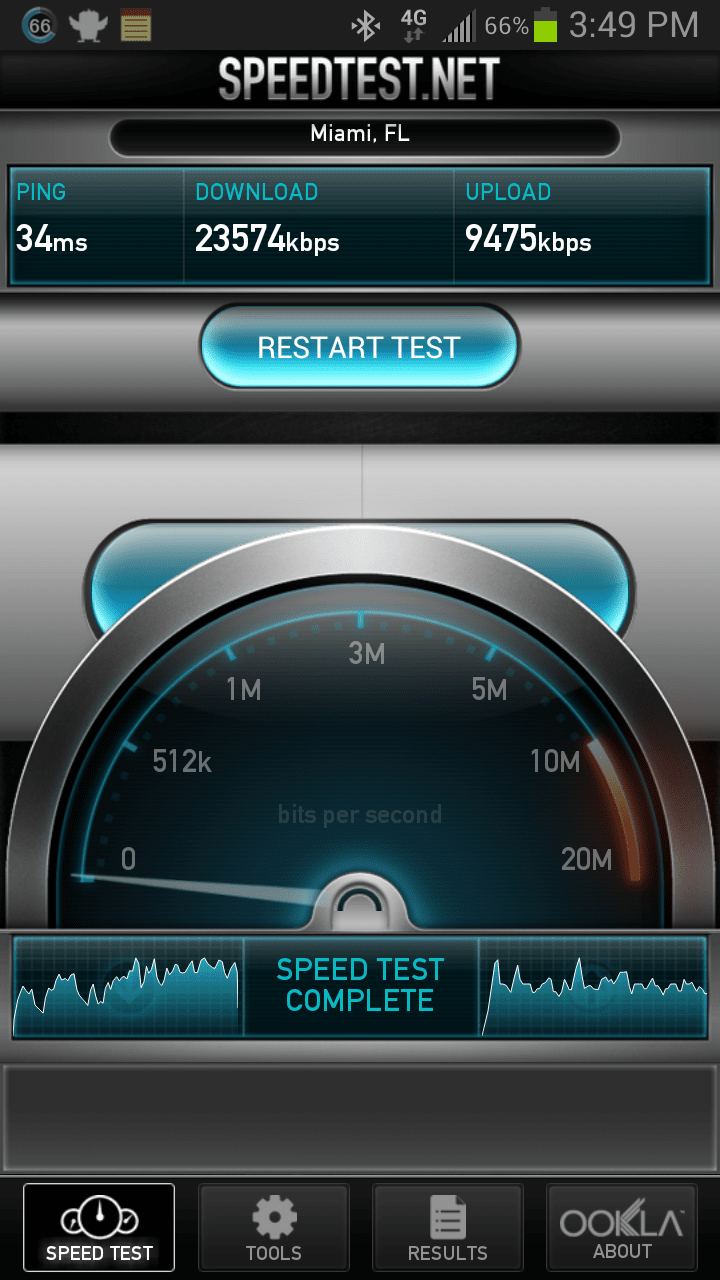

Sweet. I get decent WiMax (about 14-18 Mbit / second) here. No LTE yet on Sprint. I'm going to have an ATT loaner with LTE to test for a few days.
What type of speeds are you seeing? Hopefully Sprint added backhaul capacity too.
LER:
Of course they added backhaul, the old bonded T1s wouldn't cut it. They added 100 Meg connection to most towers. Some daisy chain via microwave where that kind of connection was not available. As each tower is upgraded they switch out the entire network equipment, 2.5g, 3g, add 4g, and add voice/text on the 800mhz band. LTE will be added to 800mhz next year. There will be a lot of LTE capacity since every tower is getting it unlike the other carriers. So less people will be on each LTE sector.
