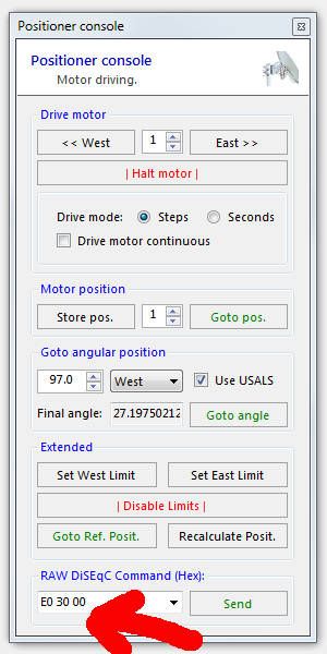

The STAB motors require external commands to reset. STAB manufactures a programming device (MP02), but it shouldn't be necessary to buy if you have a compatible receiver, USB / PCIE DVBS/S2 tuner. Most receivers have the ability to drive to the saved reference position. I would verify that the "00" reference position has been corrupted by using your receiver's USALS motor installation menu screen to "Drive to Reference". If using a USB / PCIe DVBS tuner, EBSpro has a "GoTo Ref. Posit." or issue raw DiSEqC code E0 30 6B 00. Does the motor return to the correct "00" mechanical position or is it still 8 degrees off AZ reference?
Some receivers have had the ability to send the reset code (example: Fortec Star Lifetime Ultra and Pansat 1500). If you have a USB or PCIe DVBS tuner, the DiSEqC controller applications often allows the sending of a reset or raw DiSEqC commands. The EBSpro software can be used to send the raw reset code E0 00 00 or E0 30 00 with the unit parked at the "00" position.
