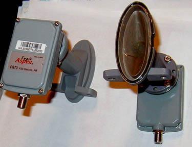

Or the elliptical horns (probably good for an 84e (assumption) as shown below.
...and I think the ones below should bolt right on... (?)

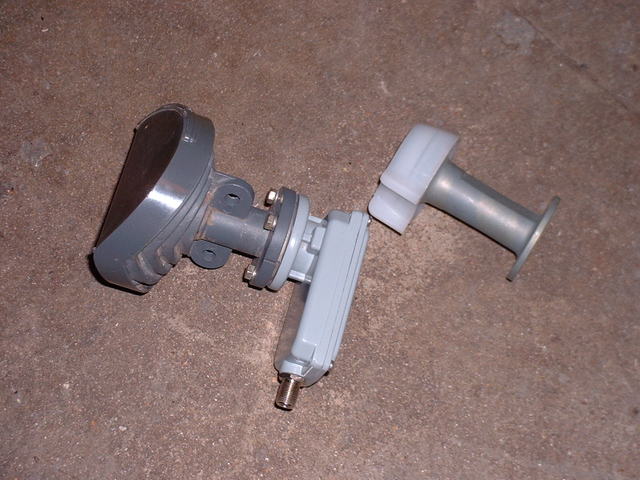

Oh, and of course, you may be ablle to bolt-up these EagleAspen/Dish LNBs to your existing horn, too.
Pix below are:
- 105 Dish LNBf
- elliptical horned Eagle Aspen (or Dish) LNBf
- Dish LNB bolted to Primestar feedhorn.

I have a Dish stacked FSS LNB bolted onto the feedhorn of my 1 meter Channel Master dish (same dish as 1M Primestar). That same LNB should also mount perfectly on the feedhorn for an 84E and the 75cm Primestar as well.
I have at least one of each. :D
Then as Voom, Tron, and I mentioned, and showed in the 3rd picture, just bolt the stacked LNB to the feedhorn that matches each dish.
Should work out fine.

I didn't know that the feed would bolt up to any other lnb. That is great to know. If fact, I wish I had known that earlier. I have thrown away a couple of the original primestar lnb's that either H or V side would not work. I could have at least saved the feed horn.
