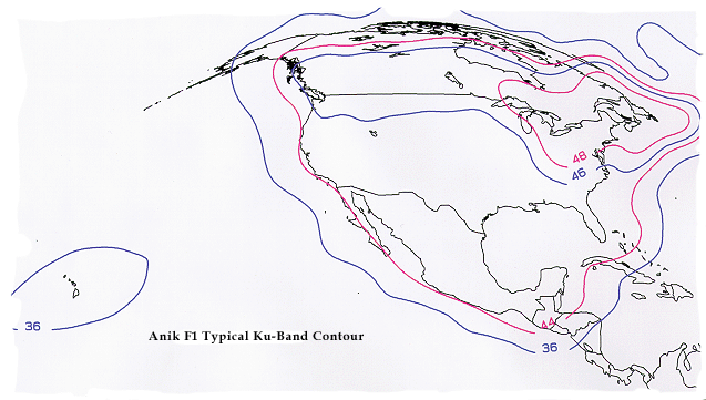

The footprint for Anik F1 shows 46dbW EIRP in florida, it only increases to 48 where I am.. So, a 60E should work for you.. may have some rain fade, but it will definately work.
Sounds like you just have the dish pointed wrong.
