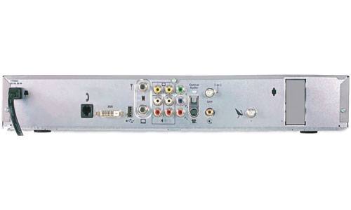

Just got my SC DSR505
I plan on hooking everything up this weekend, and then call the broker Monday or Tuesday for programming. One thing I noticed is the User Guide says "DSR500 Series". The layout shown of the output connectors is different from that of the DSR505. One example: there is no "TV Pass Card " slot on the DSR505. Is there somewhere on the internet I can get a picture and description of the connectors on the DSR505?
from the SC website :)
looks like my Voom box
  • dsr505_specsheet.pdf
What is the phono connector directly under the F-type connector labelled "UHF" used for?
