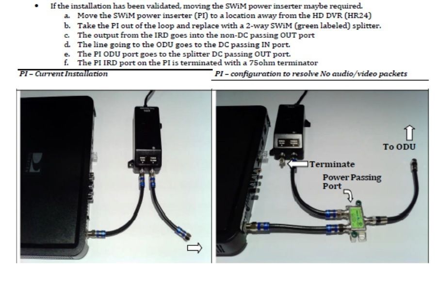

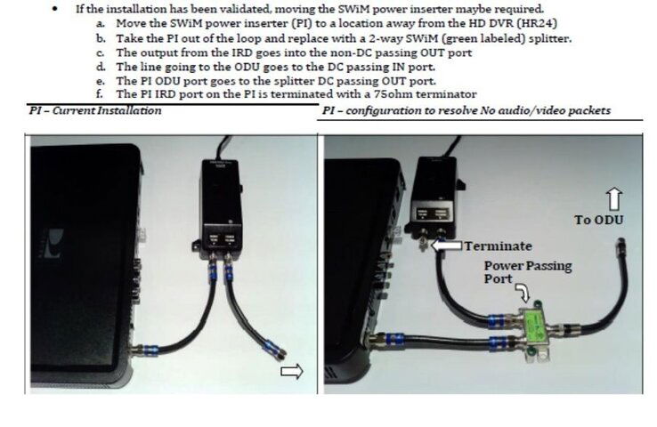

SWM Power Inserter rewire[64].jpg try hooking it up this way as it sounds like your PI is blocking some communications.
HIFI, thanks for the tip, I tried it and no success. Bottom line if I take the splitter out of the system the 5 tuners in the Genie show a good strong signal on all sats and transponders, as soon as I put a splitter in any configuration into the system the signal goes haywire on 2 of the 5 tuners. When I unplug the PI and plug it back in I guess it resets the LNB and the bad signal will show up on a different tuner(s). I'm stumped, I want to keep Direct, the tech hasn't been a lot of help but this is not acceptiable. jWhen I built the house I got talked into having all my av equipment in one location, thank goodness I ran some CAT 5 cable to all tv locations, that way I can run a hard wire IR repeater if I wind up having to go with cable.

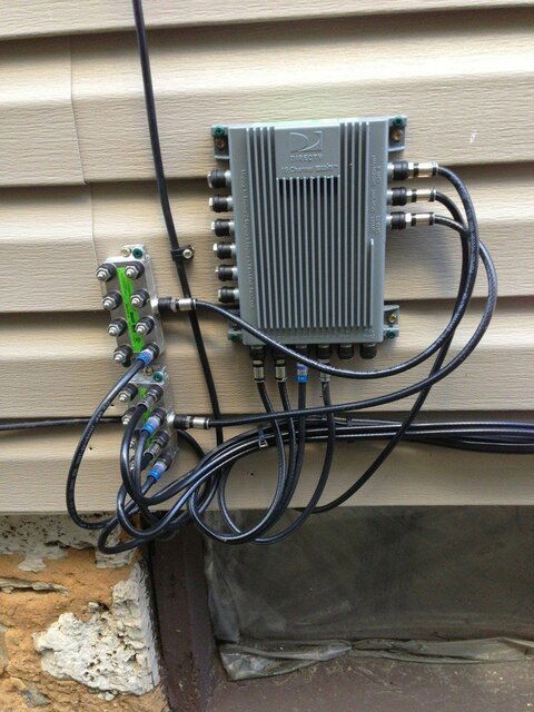

Here's my outside setup
