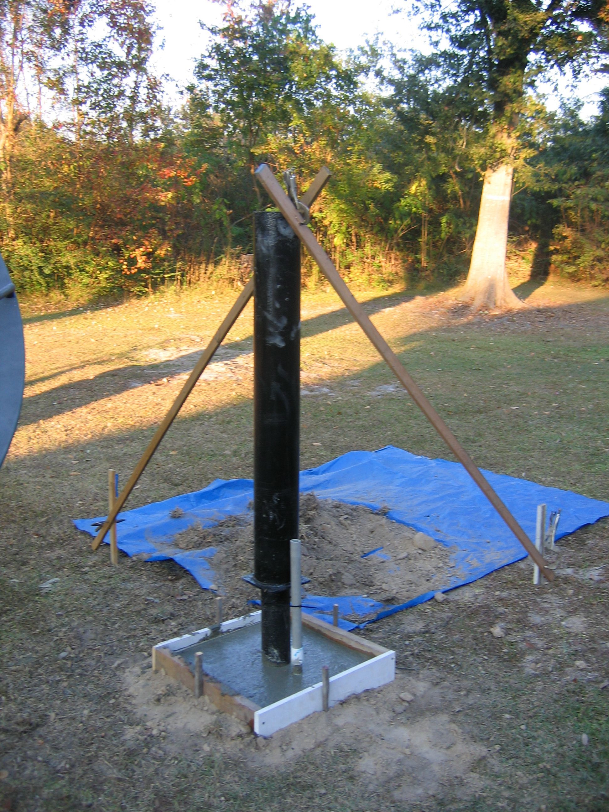

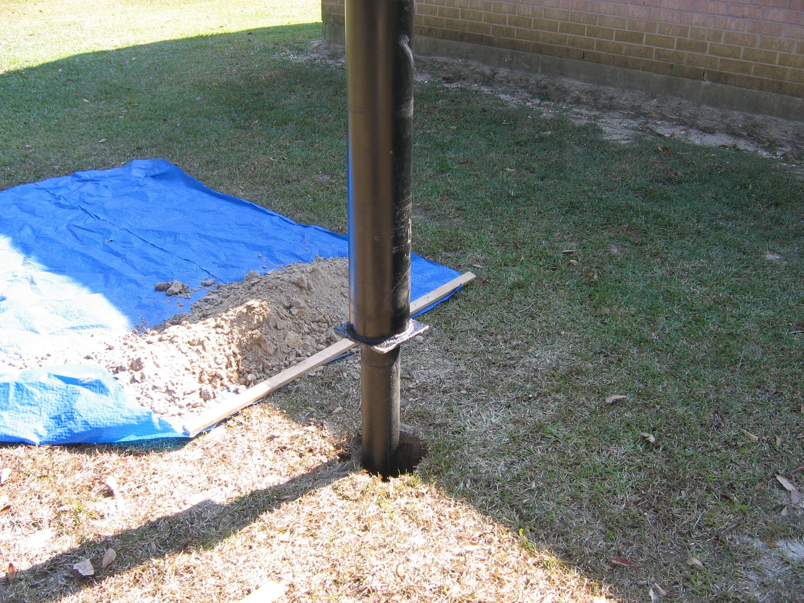

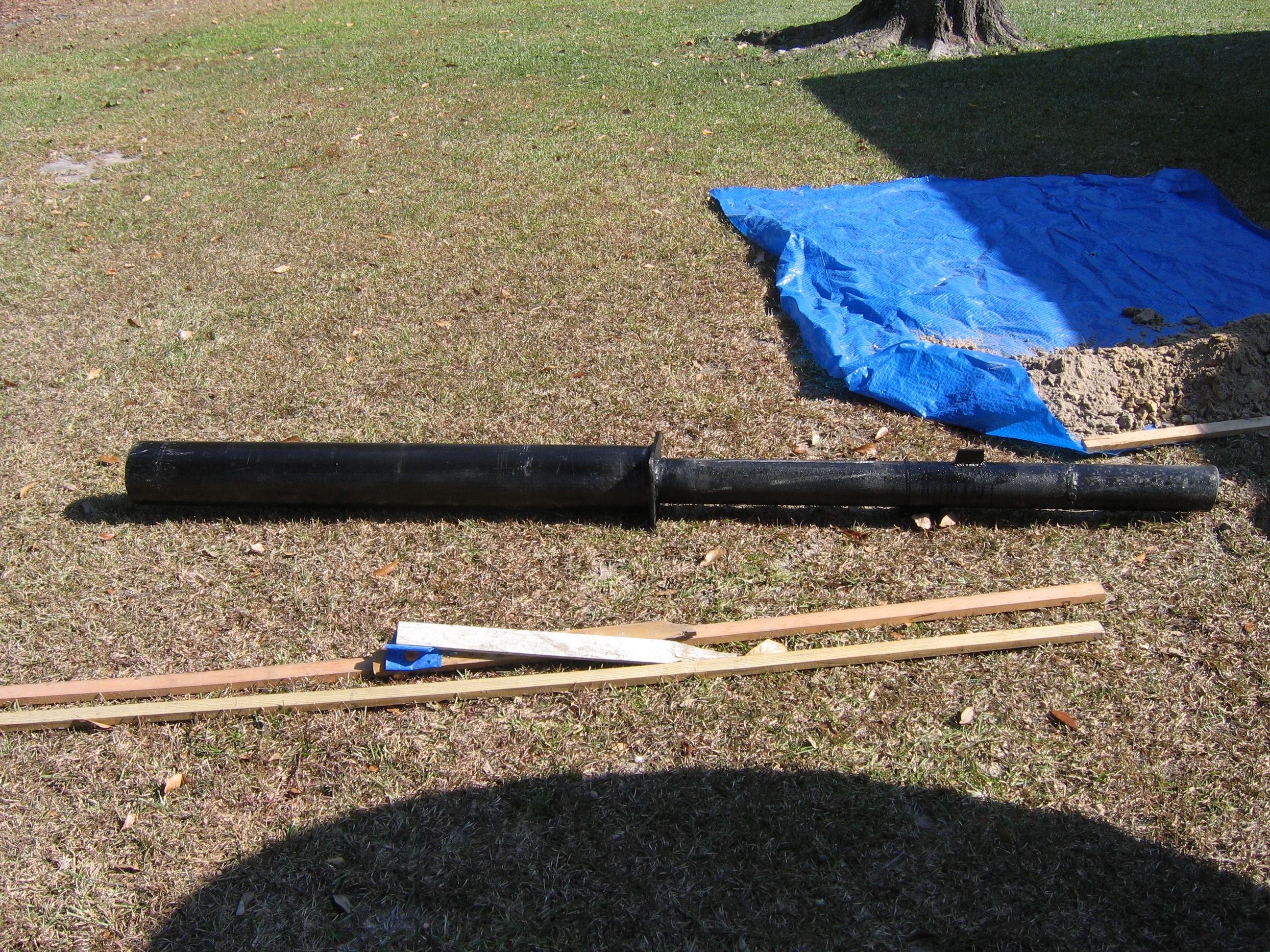

Linuxman and I were talking on the phone the other day about the solution my welder came up with to add on to the B'view 6" pipe to make it workable again, he asked for pics of the finished product, so....

Well, there's a 1m P* right next to it that can see from 55w to 148w, so it should be fine. The last picture was taken facing Northeast, so my back was to the arc when I was taking the pic.

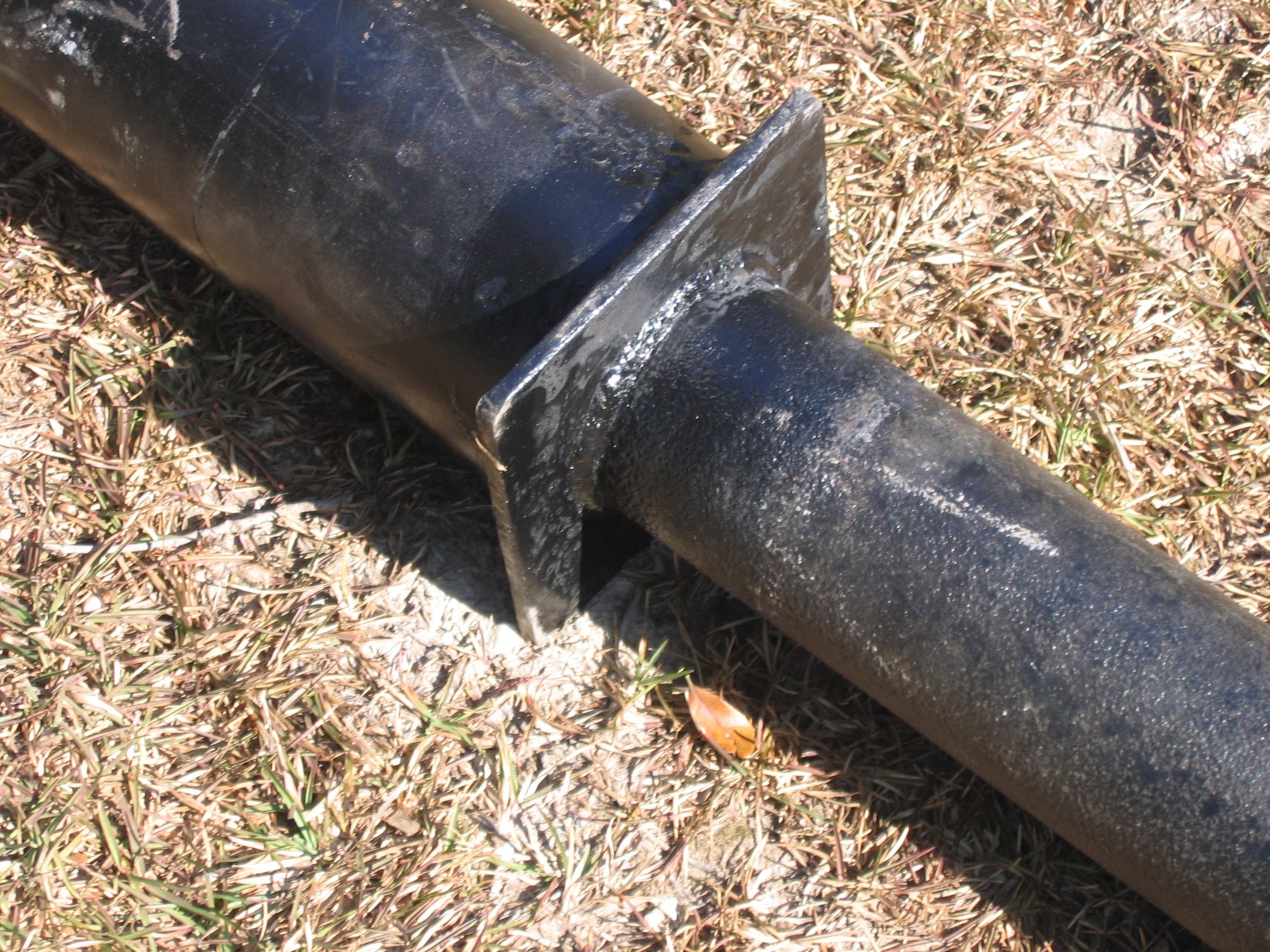

Swampman cut the pole off, and I had to cut some more of it off because the bottom was pretty corroded. I ended up cutting off about six inches, and I added four foot of 4" thick wall pipe to it with the plate assembly. I could only dig about 33 inches down the ground is so dry here, but the Paraclipse pole isn't as deep or as big as this one and it holds up fine so I shouldn't have problems. There are four 80# bags of concrete total in the project. The Paraclipse pole took three.
I would guess the LNB at TS will be about 8-10 feet off the ground, if I HAD to take a guess.:)
I don't know exactly how much pole is above the ground right now, I'd say about 5 feet.
Thanks for the kudos. :D

I see you didn't talk the welder into the gussetts! :)
Looks real good and should hold fine.
How far is the top of the pole from the ground?
In a way, similar to mine. My first BUD pole was a 3 1/2 incher. it went through the eaves of my roof. I chopped a not too deep hole in my side concrete walkway at the bottom of the pole, put three rebars in the bottom, "L" shaped. I filled all 18 feet of it up with concrete and filled in the bottom hole up to the walkway surface.
When I got the 6" Birdview mast, I put it over the top of the 3 1/2 incher. But I only had six feet of it, so under the eaves it's still 3 1/2 inches and over it's six. The bottom of the 6 foot Birdview mast basically sits on top of my roof. I cut a ittle port in it near the top and worked it full of concrete.
I think mine is more prone to move than what you have there.
I think what you have will work better than what I have.
We talked about the gussetts, and knowing what I know about metal, that, done correctly, the weld is stronger than the base metal, we decided that they just weren't necessary. Each side of the plate has two passes all the way around the pipes. That 6" tube will collapse before that weld breaks.:)
Top of the pole is about 5 feet from the ground. I went back outside to show she-who-must-be-obeyed what I did today, and it is about eye level to me, and I am 5' 5" on a tall day....LOL

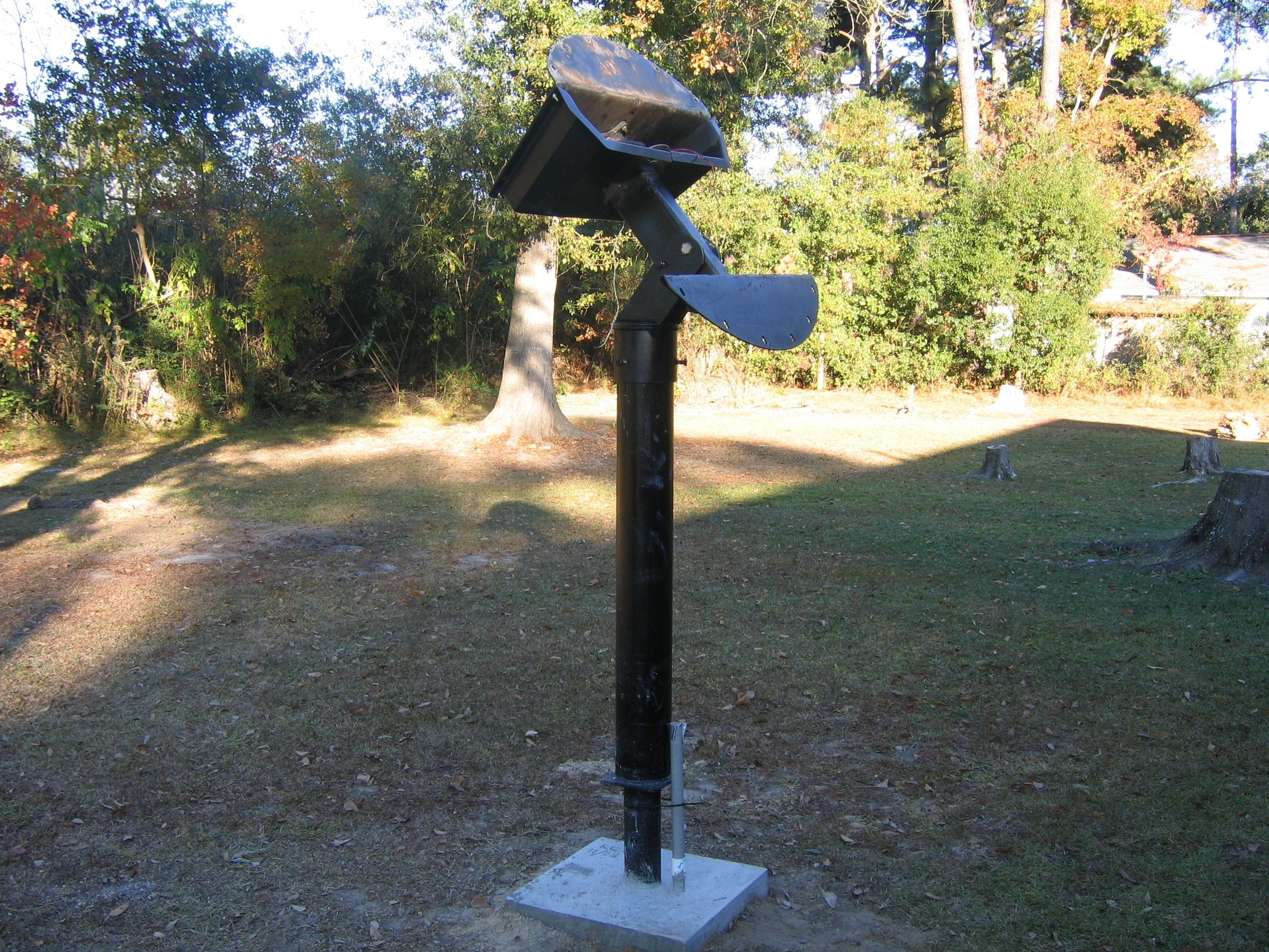

Its Coming along....
Took my Uncle's tractor today and set the motor on the pole.....also pulled up the 1m dish that was right next to it and got rid of that....

Stogie;
Sweet!
I like the pad with the pvc conduit, nice touch. No rusting out of the pole base at your place.
One of the things I love about this site is the pride and workmanship that folks put into their setups.
