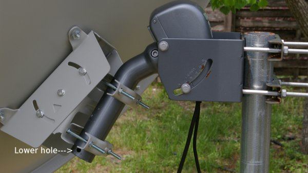

Hi, when I installed my WS9036 I noticed there was no mention in the instructions on how to align the dish mount to the motor axis. On my Fortec dish there is a bolt in the top of the mount that goes into the upper hole in the motor axis and locks it in place. The WS9036 does not have this bolt and I think it would be easy to mount it out of alignment and if this was done the dish would not track the arc. I ended up using a long rod to sight the alignment and to make sure the dish mount was 90 degrees to the rod. I even double checked using a index card (my speed square would not fit) to make sure it was spot on at 90 degrees.
My WS9036 is tracking the arc fine. Hope the pictures below help, DC
Edit --- Radar made a good point on the focal point. Let me know if you need some pictures of the LNB mount and arms. DC

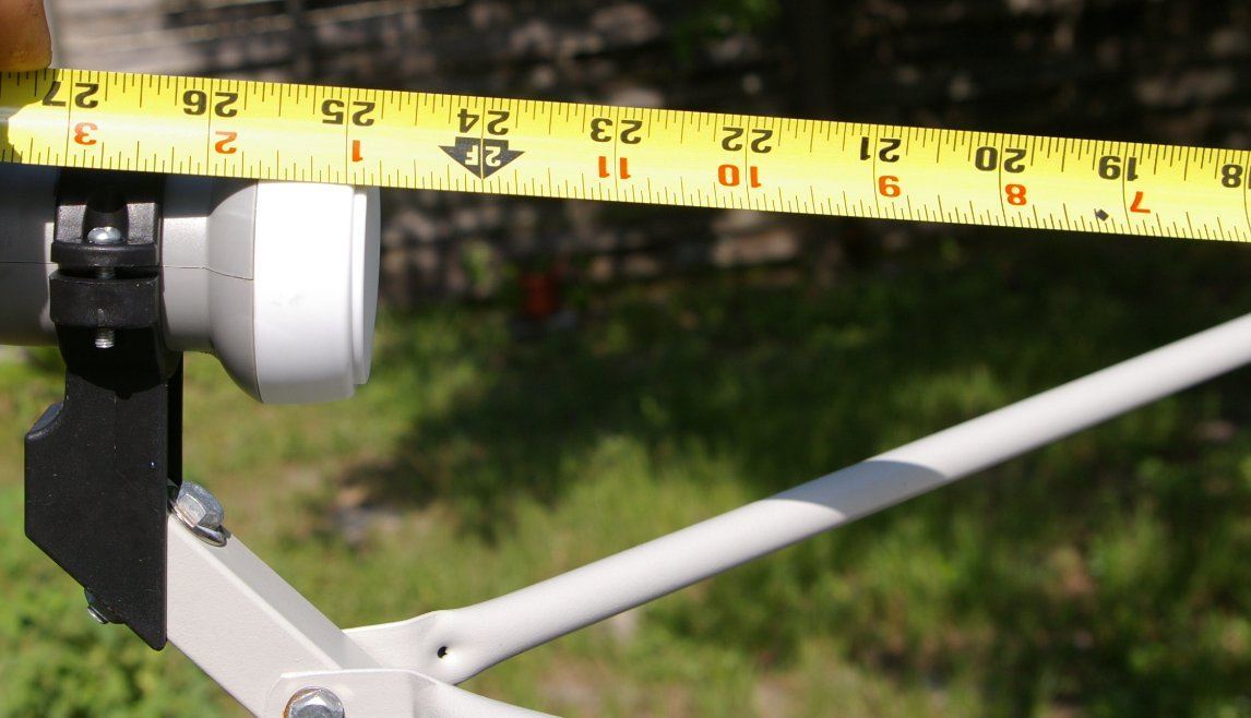

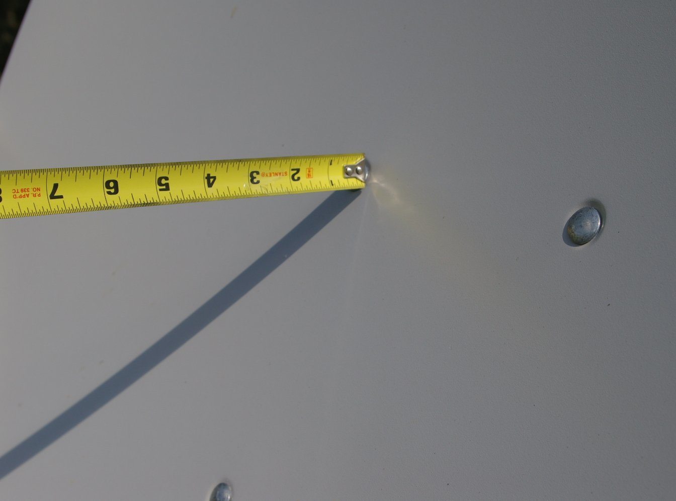

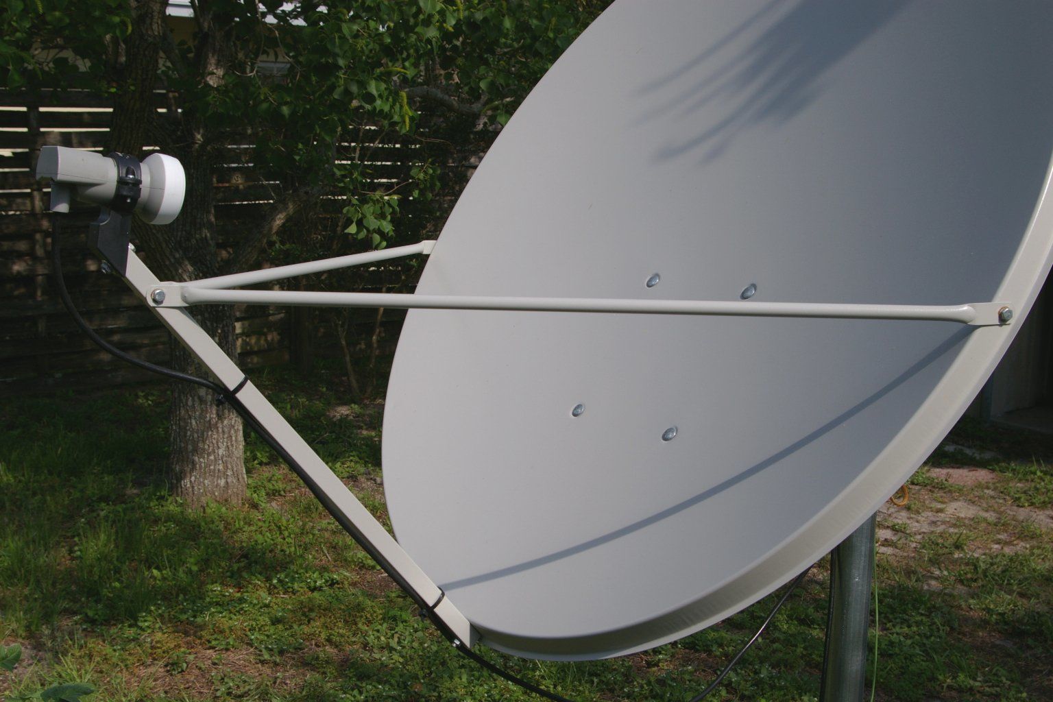

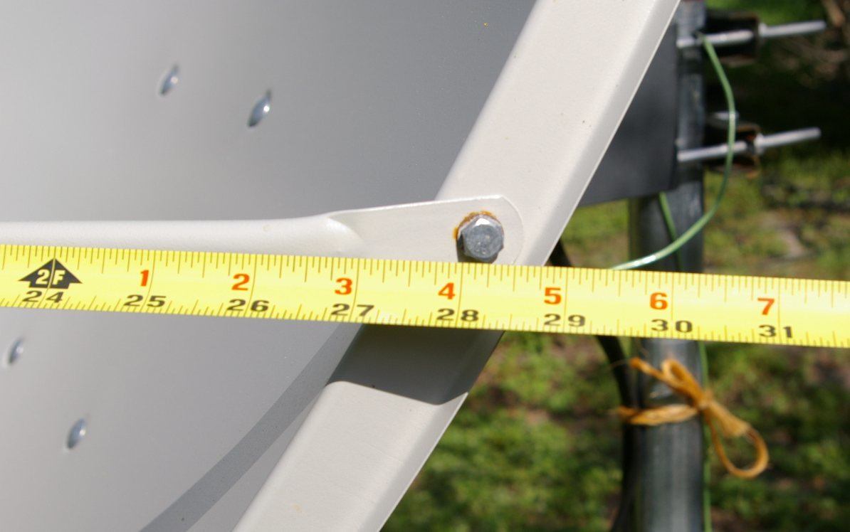

Hi all, if anybody wants to compare the LNB support arms and focal point here are some pictures of my WS9036. I think mine is spot on as I checked the LNB when I first installed the dish by moving it in and out in a loose bracket while listening to the audio meter on my receiver and could not tell any difference when peaked on a satellite. The signal quality has been as high as 85 on my Mercury II (breakup is below 30 on this receiver) The picture of the LNB arm is showing the center to center of the mounting bolts measurements. On the picture of the LNB the tape goes to the face of the top left bolt.
Please post a follow up if anybody finds a difference on there dish.
Thanks, DC

Yes, the website states 24 inches; that's 25 inches as you measured it from the upper bolt. That's what I have now.
The website states that the focal length is 24". Is that what you're referring to? The measurement pictured in the 2nd and 3rd picture above does not represent the focal length. That would be measured to some point near the bottom of the dish, near where the lower LNBF arm attaches. Actually, there is no universal way to know where to measure this, as there is a good chance that it may not be a point on the dish, but instead a point just off the dish, however measuring to the bottom of the dish is pretty close. Ideally, it WOULD be a point off the dish, since the goal is not to have the LNBF block any of the signal, and if the center of the parabola is actually on the dish, then you'll be blocking signal.
The measurement to the center of the dish is really meaningless, other than for comparing one dish to another, and it SHOULD be greater than the focal length.
24-inch focal depth
Thanks for your comments, BJ. My measurements are the same as what delta_charlie has photographed, and that's the optimal setting for me too. The distance from the upper bolt (as in delta_charlie's picture) is 25 inches. The distance from a central point in the middle of all four bolts is 24 inches.
