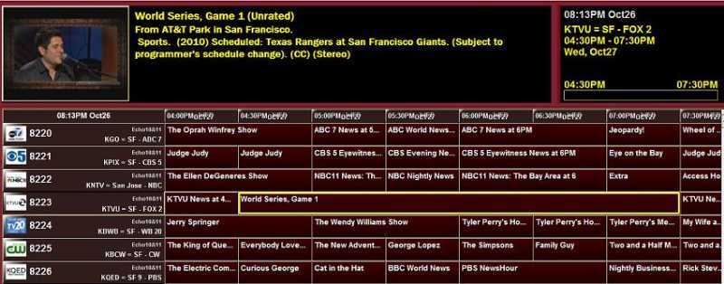

dvbDream Runs
dvbDream v1.4i runs well on a XP platform.
Plug in dvbEPG and grab packets for the FTA program guide of all channels.
Need proof .... how about Game 1 World Series Info
I wonder if you could be more specific as to how exactly you got a program guide and which satellites it will grab the guide for? Appreciate it. Merry Christmas
My guess is that DVB_Dork is probably getting the EPG from a Dishnet satellite for "all" channels that "Dishnet" offers. There aren't many FTA channels that have EPG and then they are only for a single channel. This would also probably require a circular LNBF.
DRCars
Yea, that's right. Only good for DN system.

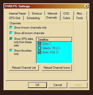

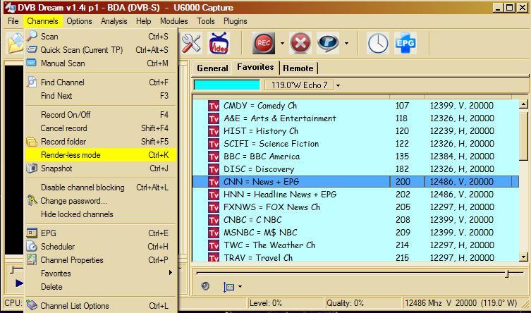

The DN "In the Clear" Electronic Program Guide (EPG) is available for a DVB-S card.
You can populate the 7-day EPG from Echo 7 , 12486 MHz or Echo 10 , 12515 MHz.
I run dvbDream with dvbEPG. There are other apps, but dvbEPG lets you display favorites.
