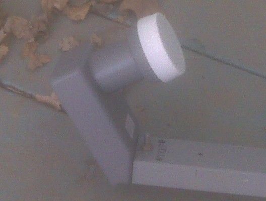

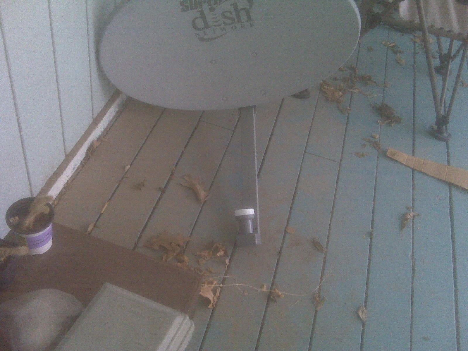

The Digiwave mounts right up on the super dish. I measured it all out and the Digiwave mounts and looks right down the same spot as the FSS LNB that was front and center.
I will mount up the dish soon and see how it works. Might make a decent fixed dish setup :D
What is the spacing on the original for the FSS and DSS LNB's ? I am guess it would have to be 4 degrees Since original DN setups for this area are 105, 110, and 119. I wonder if i can modify this bracket to add more Digiwave LNB's to the super dish?

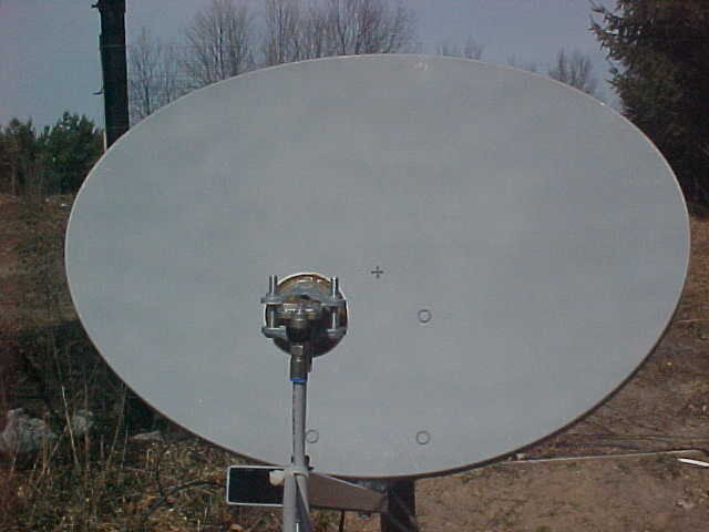

I just finished motorizing a superdish and am amazed at how well it works, BUT, in my application at least, I found that the actual "sweet spot" is not straight ahead as I imagined. I had marked the spot by sighting straight down the arm and it looked like that should be fine, but it produced disappointing SQ. I hooked up a meter and got max SQ by mounting the LNB using the right existing hole, but pointing the LNB left. Why? I don't know, maybe the arm isn't square to the dish, maybe it was designed that way? All I know is that is how it worked out in my application.

OK so I did not just repoint the current DN SD. It was a really nice day here and I felt like messing around outside. So I just took off the SD with the FSS LNB on it and replaced it with the one that I put the Digiwave LNB on. I was nicely surprised at how well it seems to be doing. I just pointed it at 97W my true south sat. I am getting quality readings on the AzBox of mid 60's to high 60's. Not too bad for 15 dollars on the LNB and some time :)
Oh and I did leave it pointing dead on like the FSS LNB was originally. I guess I might get a better quality by offsetting it like you did Skyscanner. But since it seems to be just fine I think I will leave it and maybe test the offsetting the LNB on one of the other super dishes.
