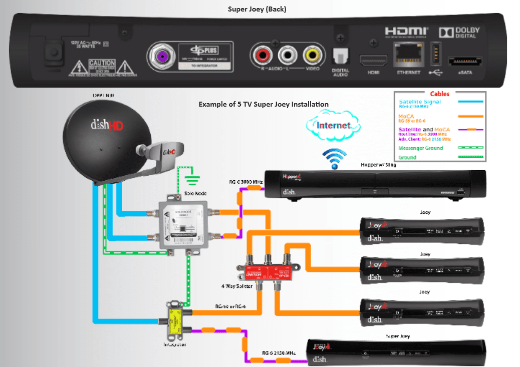

Take out the 44 switch and use this diagram. Then run a check switch on the Hopper
That's the setup i used, with DP lnb for each sat, to 44 switch, i am outside the US, have to use a larger dish, 3ft upwards
Ahhhhh, so you have 3 dishes. I'm guessing 102mm Dishes. So, you have to use port one out on the 44 switch to the power inserter and ports 2 and 3 out to the solo hub. Is that how you're doing it?
Two dish, 119 & 110, i never used power inserter, port 1 & 2 to solo hub, port 3 to the integrator, port 4 terminated, most of the time i used one dish and build a mounting bracket for the second satellite, i have installed over 10 Super Joey's before, never had a problem, going to make a shorter run cable
