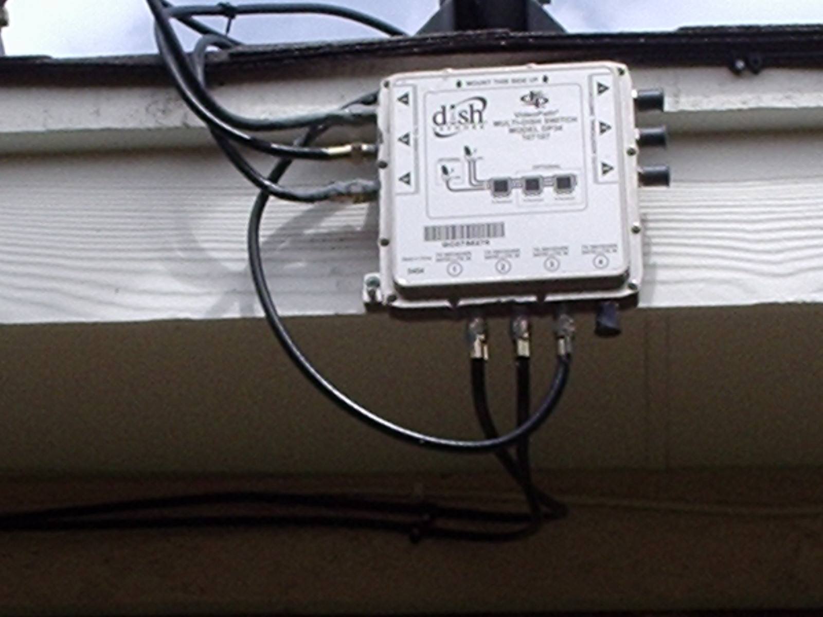

NOt work, I try again to download the file.
this is the switch that I am using
I will try to take photos (raining like crazy today) and post them here when I get a chance.
