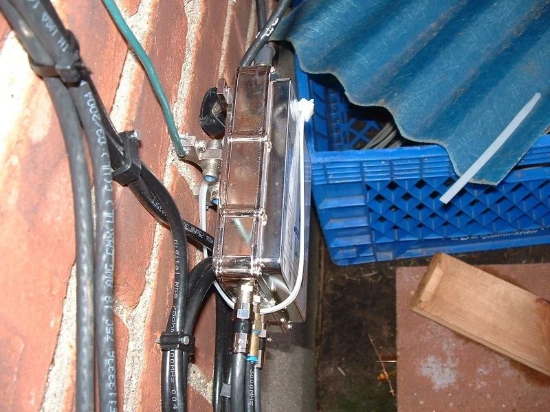

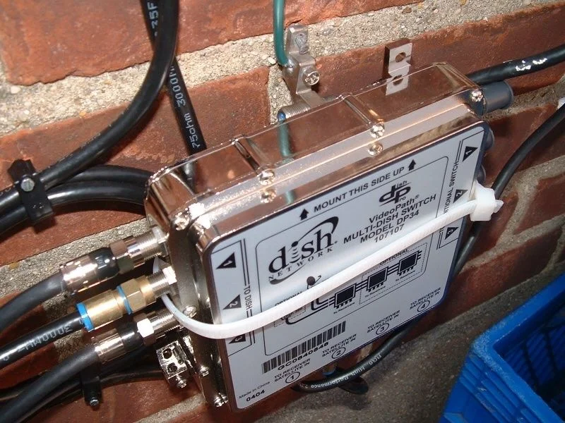

They also installed a DP34 switch, which they didnt even ground properly.
They tied it with a cable tie to an existing grounded connector.

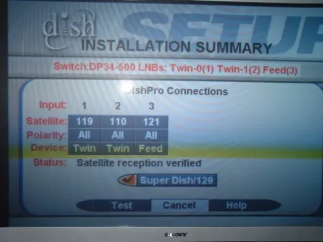

Unsure about the signal... for 105 standards it's good. Looks like the installer was lazy, used your existing dish and used the superdish for 121 only, making it a 2-dish system. The 34 doesn't need to be grounded, as long as you're grounded somewhere.

If I do a checkswitch on my 811
I took pictures of the checkswitch screen and the grounding if anyone wants to see.
what is the difference between TWIN and FEED?
the switch doesn't need to be grounded?
the way it is now shouldnt be of concern?

Yep, you should, you're not grounded.. maybe by osmosis, but that's it.
Just take the green ground wire and move it over to your SW34.
As for the two dishes.. if you don't mind, then I say leave it. If you want one down, call dish and have them take it down, and set the superdish up correctly.
It works, but it defeats the whole purpose of the superdish's 3 LNBF's.

I'm curious as to why that ground wire is going up instead of down - towards the ground. Is the wire really grounded?

Yes, it's grounded to a copper pipe.
