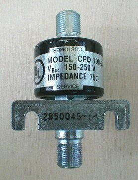

My favorite.....
And, they are UL listed to replace grounding blocks.
Sabre CPD100
