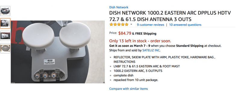

This is what I have, this LNB, one wire runs from this into the house, then to a switch, then to the 722k. Would it just be a matter of swapping out that switch and the receiver. Or would I need to go outside and climb the latter and do something else? Keep in mind I dont want a Joey or Wally or anything else

For a Hopper 3 you need an eastern arc Hybrid LNB for your 1000.2 dish.

I had the same question and thanks to JSheridan he told me I had the wrong dish for my hybrid lnb. I also like to own my equipment. I installed the correct dish and really enjoy the hopper 3 . Good luck with it !

Perfect, thats what I have, thanks for the information.
