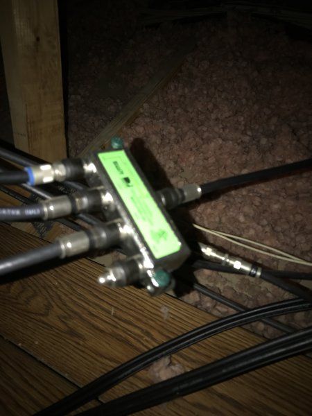

Depends on how it is hooked up. If you have a simple splitter setup, then maybe. Maybe you could take a picture or sketch out your wiring and setup. Do you know if you have one line from the dish to a splitter and then one coax to each receiver location?
Looks like one main in then split off to 3 receivers in the house.
The line from your HR54 has to connect on the splitter where it shows a red line since it supplies power to the lnb at the dish. If you move the HR54, you have to move the line to the splitter.

Yes as Raoul says, can you tell if the coax on the left side of the splitter (the one with the blue at the base of the connector goes to the location where the HR54 was originally?
The blue one does connect to the HR54
The line from the HR54 has to connect on the splitter where the red line is.
So i can't just swap the blue line one with the room I want to move it to?
The HR54 is what provides power to the lnb at the dish. It must be connected to the port on the splitter that has the red line on it. It's that simple.

Yes you should be able to swap the coax with the blue base with the coax that goes to the room that you are moving the HR54 to. The HR54 has to be connected to the port on the left side of the splitter. It allows power to pass back through the splitter to the LNB on the dish. The reason I asked if the HR54 was connected to the coax with the blue base was to check to see if you had a power inserter installed instead of using the HR54.
