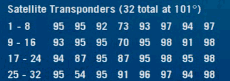

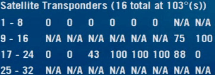

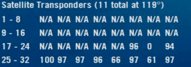

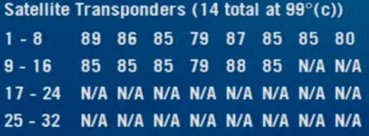

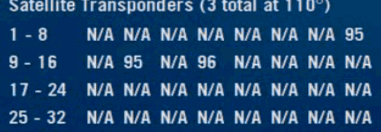

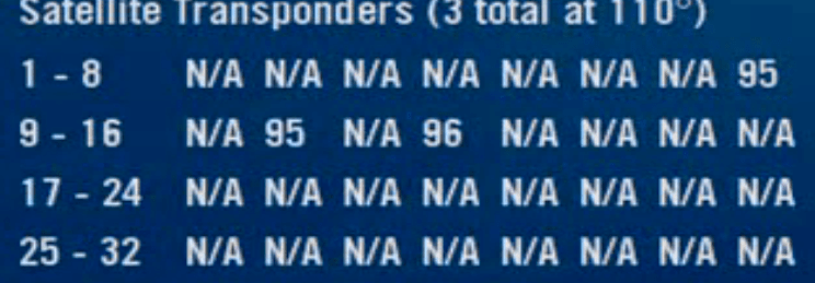

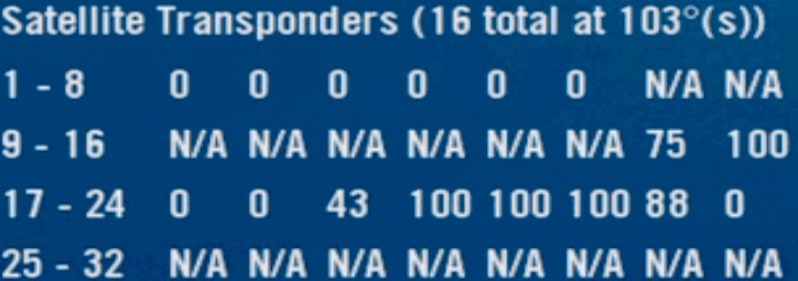

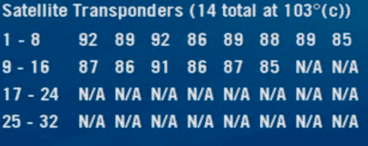

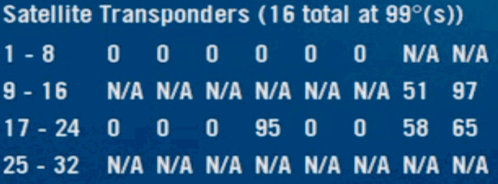

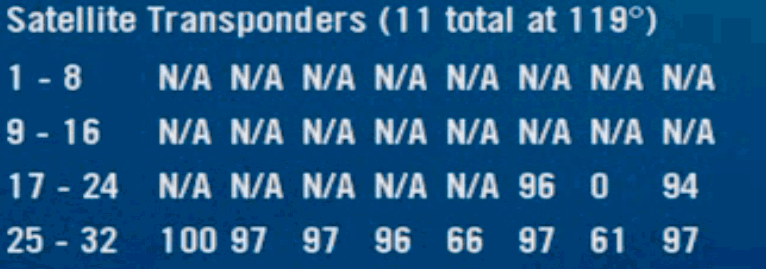

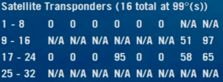

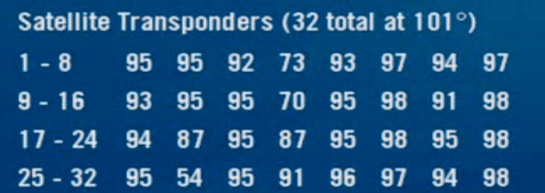

here is what my siganls look like right now (when these pic were taken it was cloudy)

I'd say you got had a bit. There's nothing wrong with the SWM-8 module technology and many of us use it quite successfully. However, because it's designed use is multiple dwelling unit installations like apartment buildings it is not installed in many single family homes. Locally the standard techs here have not worked with it and only now are really getting used to working with the SWM LNB. This is not the first time I've heard a tech or supervisor say that SWM-8 is not approved technology or they've never seen it before or some other excuse for not wanting to work with it. I'd agree your 99c and 103c aren't the highest but they're not bad.
