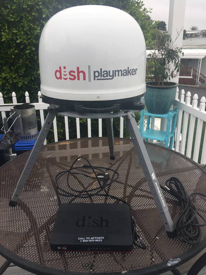

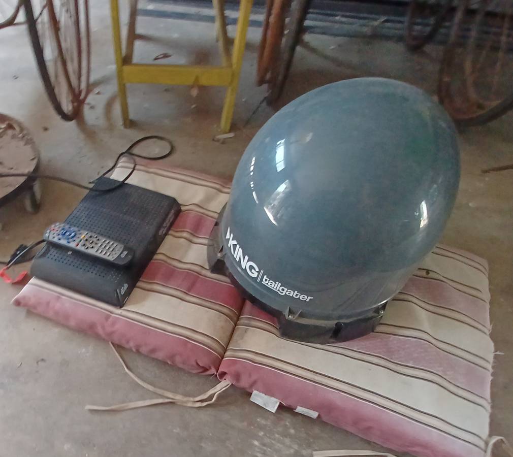

I need to replace a very old Winegard Traveler Minimax. I know it has two outputs and I am pretty sure its stationary. It has a VIP211K connected to it that was having a very hard time activating. Using my home dish, I was able to activate it. The dome is mounted on a 2000 Fleetwood Discovery pusher so who knows how old it is! The 211 fails to get any signal from the dome. The dish moves and does its grinding I tried a new coax all the way to the dish, but it fails to get any signal and fails to see the 64 switch. I am on social security disability, so money is beyond tight! Any tricks on getting the 211 to see the 64 switch? Or I found these two replacement options and heavily leaning towards the Winegard with the Walley? If so how can I tell if its a Playmaker 2.0 with the larger dish. I noticed you recommendation for the Winegard Pathway X2. I cant find any used in my area or price so might have to wait. THANKS!
I've never worked with a Minimax, and in fact have only ever seen one of them, so no help there. The Minimax is a western arc only dish though, so if that worked well for you and you're not changing locations, the the Playmaker Dual should work ok for you. Ask the seller for the exact model number to determine what he's selling.
I've never worked with a Minimax, and in fact have only ever seen one of them, so no help there. The Minimax is a western arc only dish though, so if that worked well for you and your not changing locations, the the Playmaker Dual should work ok for you. Ask the seller for the exact model number to determine what he's selling.

I'll have a perfectly good working Winegard Pathway X2 available if I can ever get my fixed dish and two wally receivers to work.
You probably should have gotten a DPP LNB instead of the DPH. No hookup issues that way.
