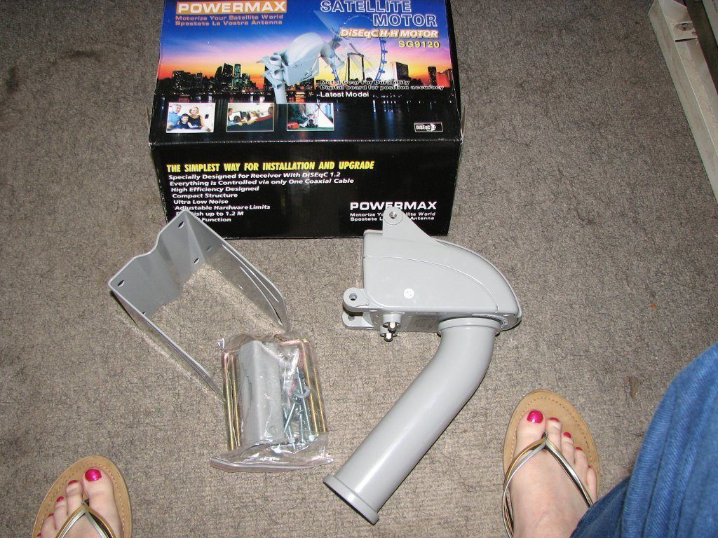

Oh, and my dad helped me buy a motor. :) I have it in the box but don't know what to do with it yet. I'll worry about that after I get that *big* primestar dish fixed. The one with the missing part. Then I'll get with you guys with pictures and seek your advice.
Speaking of dad. He wants to get a satellite tuner that can do the HDTV that PBS is in. He checked his tv set and he says it has two hmdi connectors on it.
So he would need a satellite tuner that hooks into hmdi. And that will run a motor dish. Any recommendations are more than welcomed! :) Oh and he doesn't know or care about the blind scan thing or cband.

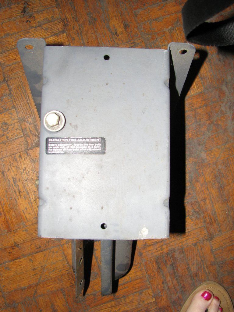

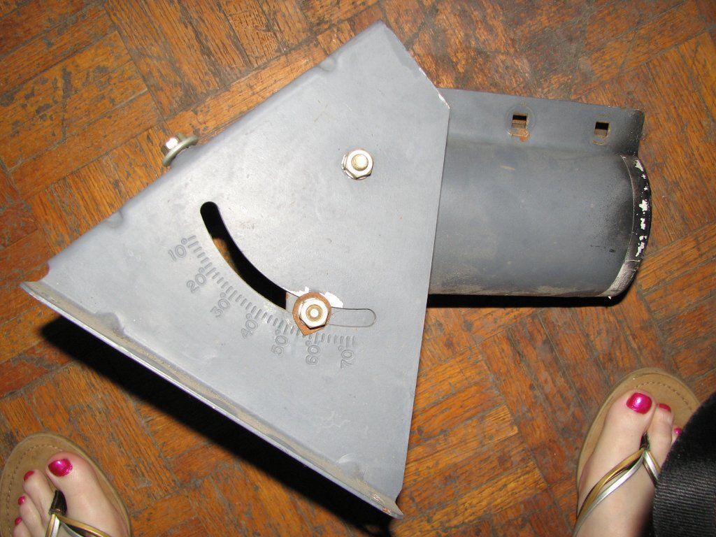

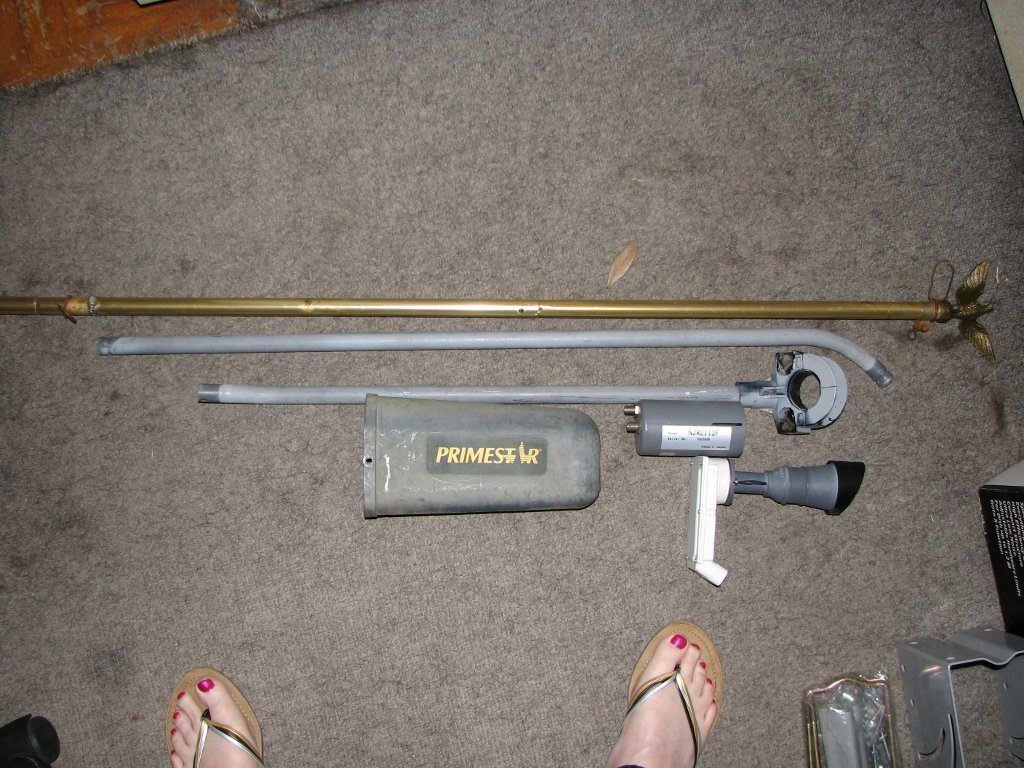

Ok, here's a picture of the primestar dish I want to put the motor on.
It's a 1.0 meter dish according to the printing on the back.
You can click the little pictures to see bigger ones of course. :)

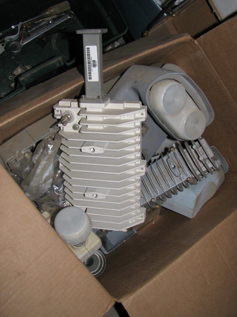

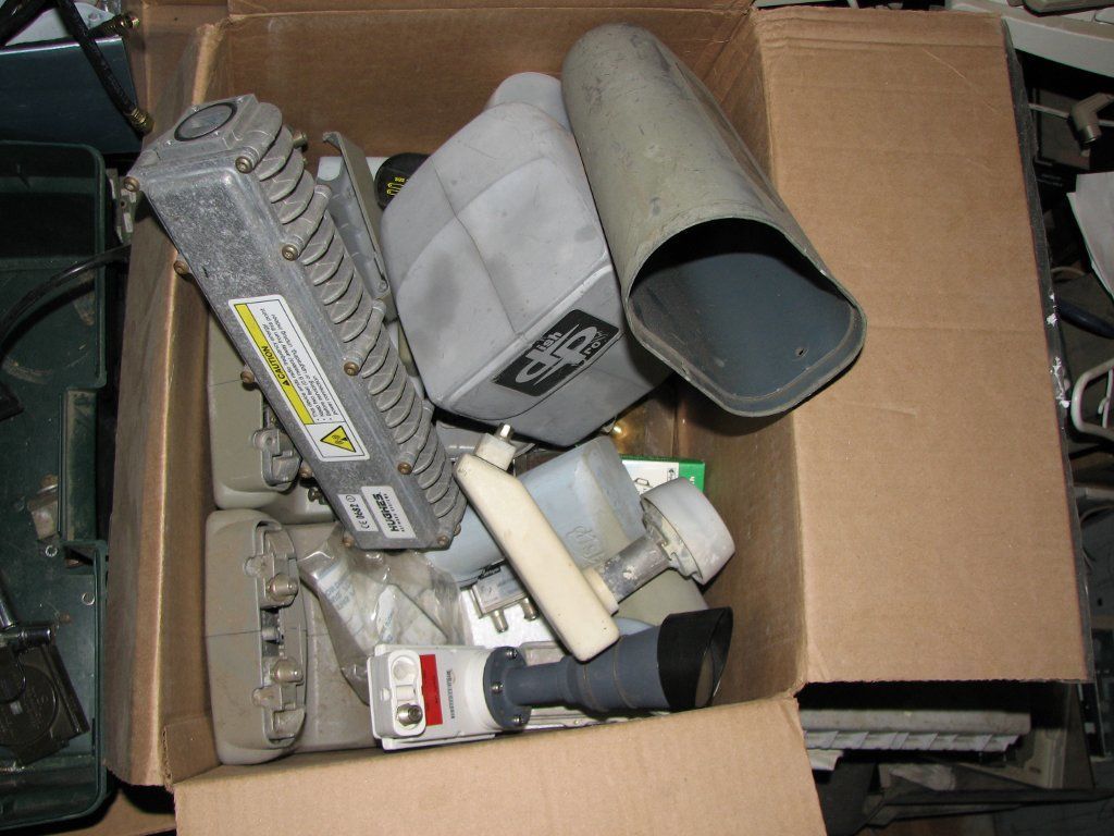

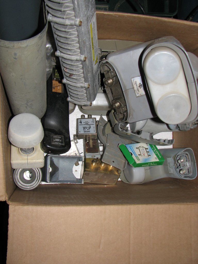

And I've added some more pictures of the misc junk and parts.

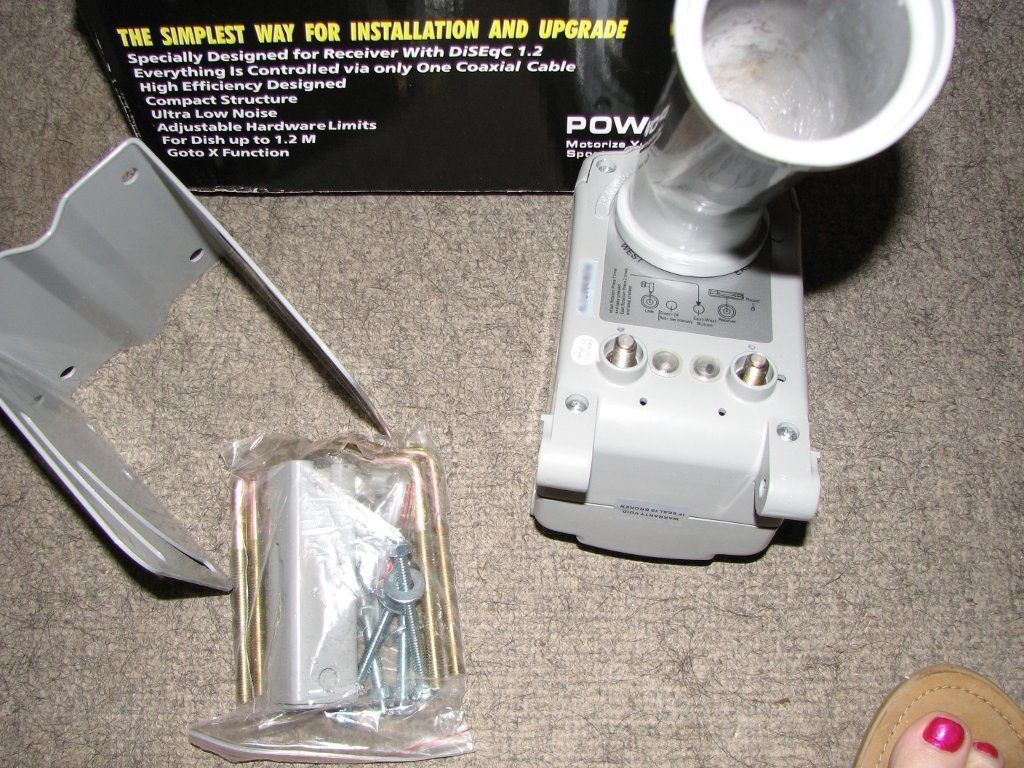

Also I added a few pictures of the new motor too. (that I have no clue how to use)
I found a little aluminum flag pole that is the exact right size around to use to replace the missing arm on the dish above. I need to get my dad to bend the thing for me because I'll just ruin it if I try.
I took some of the lnb parts and put two of them together and made a Frankenstein thingie. I have no idea if it will work or not, I doubt it.
I still think I would want to put one that gets both the ku kinds of satellites, not just one kind. I was just wasting time when I was bored because the things looked like they could be swapped around. Just for fun.
What I'm afraid of is that the big primestar will be too heavy for this little motor.
It says for a 1.2 meter dish and mine is a 1.0 meter but it's heavy and that metal thing for the back is really heavy. And how would I hook the dish to the motor?
Also can my pc satellite tuner run that motor? That seems like a lot of stuff going on, moving that big thing around all by my little pc. I'm worried about it to be honest.

Quite a collection dee, first 3 pics from left are the stock Primestar mount for a 1m-1.2m dish. You can see in the 3rd pic that somebody has pried it way apart-it would take some heft to get that bent back to where you could put the bolts back in it. Of course ifyou want to put the 1m dish on a motor, you won't need that mount. If you don't have the primestar pole, that fit that mount, you can get a chain-link fence corner post from the hardware store, for about 12bucks and stick that in the ground with some concrete around it. A 6' long pole is plenty, though I think they come in 7' long also. You could mow under that ok. For your lnb-support pipe that missing, I believe standard electrical conduit is the same thing, and it can be bent with a conduit bender (or a vise if you're careful). I got a 10' stick of that for 8.99 a couple of weeks back. The dish motors can handle that 1m dish ok, you'll need to fashion some brackets to hold it to the motor shaft, though some people have just turned that standard primestar mount upside down on the back of the dish, and "made it work". I wanted to save the weight on my motor by removing that heavy metal mount. There's a thread on here someplace where I posted a picture, let me know if you need to see and I'll dig it up in my computer again.
This is not a hard project, just step by step by step. First, make sure the pole is at least 2' in the ground, and use a level to make it perfectly plumb, might have to brace it with something until the concrete dries, 24hrs usually is good. If the pole isn't plumb, straight up and down all the way around, you'll have mucho problems tracking all the satellites with a motor.
Dee_Ann,
That's a pretty nice mix of cool parts you have there! The older PrimeStar and Channel Master dishes like the one you have are really great dishes. I have several like it and they are really nice. What is really great about these dishes is that elevation bracket, it has that nice fine adjusting elevation jacking bolt. This is a godsend for any dish, I wish they all had an adjustment device similar to it.
It prevents gravity from working against you when making minor adjustments. Otherwise, you may find out the hard way that, when you need to make a slight tweak, the enite dish falls all the way down and you don't really know where you started to put it back there! LOL With the "jacking elevation bolt", the dish can only move when you adjust the bolt.
The only drawback I can see is the same as you worried over, the weight of the entire assembly itself. If you are in doubt, don't spend too much time perfecting a glorious mounting system for it until you confirm that your motor will handle it.
See if you can find a spec for your motor regarding the maximum weight it can handle (as opposed to just dish size), then weigh the dish and brackets - everything and see how close you are getting to that spec. Or, set up the motor on a post and zip-tie or use some hose clamps and such to secure the dish and bracket to the motor tube and simply just test it first hand. You don't have to align anything at all, just hook it up in a fairly natural manner and see if the motor will drive east to west and back repeatedly without stalling or "growling" at you while moving very slowly.
If it moves fast all the way from one extreme of the motor's travel and back consistently, then you are A-OK! :)
Testing the motor's capabilities first hand like this is your best avenue, then you really know for certain.

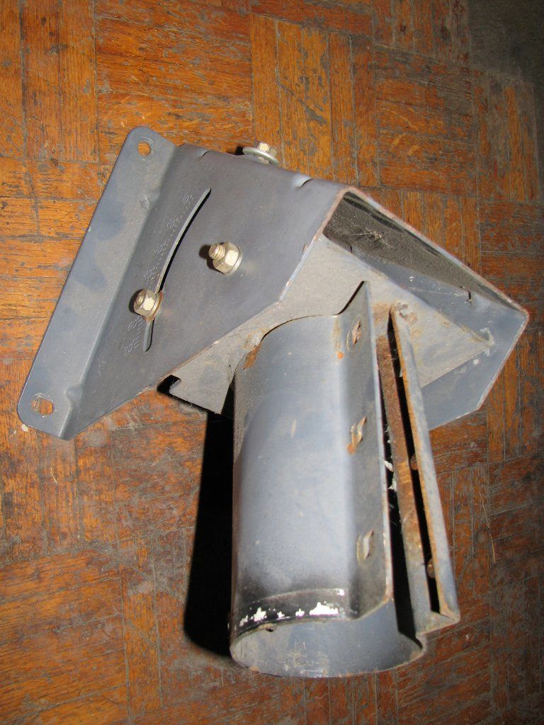

I see from the pics that your 1 meter Channel Master is missing one of the side struts. That is going to be an easier fix, since the one that is missing is a clone of the one on the other side. The center strut is the different one of the bunch. Also good news that you have the original LNB holder. That will save you some calculating and fabricating.

... You can see in the 3rd pic that somebody has pried it way apart-it would take some heft to get that bent back to where you could put the bolts back in it.
Easy as pie. Just get a couple big "C-Clamps", and use them for the leverage they give you to crank the mount sides back together, and then insert the bolts, and put lockwashers /washers/ & nuts on them loosely for now.

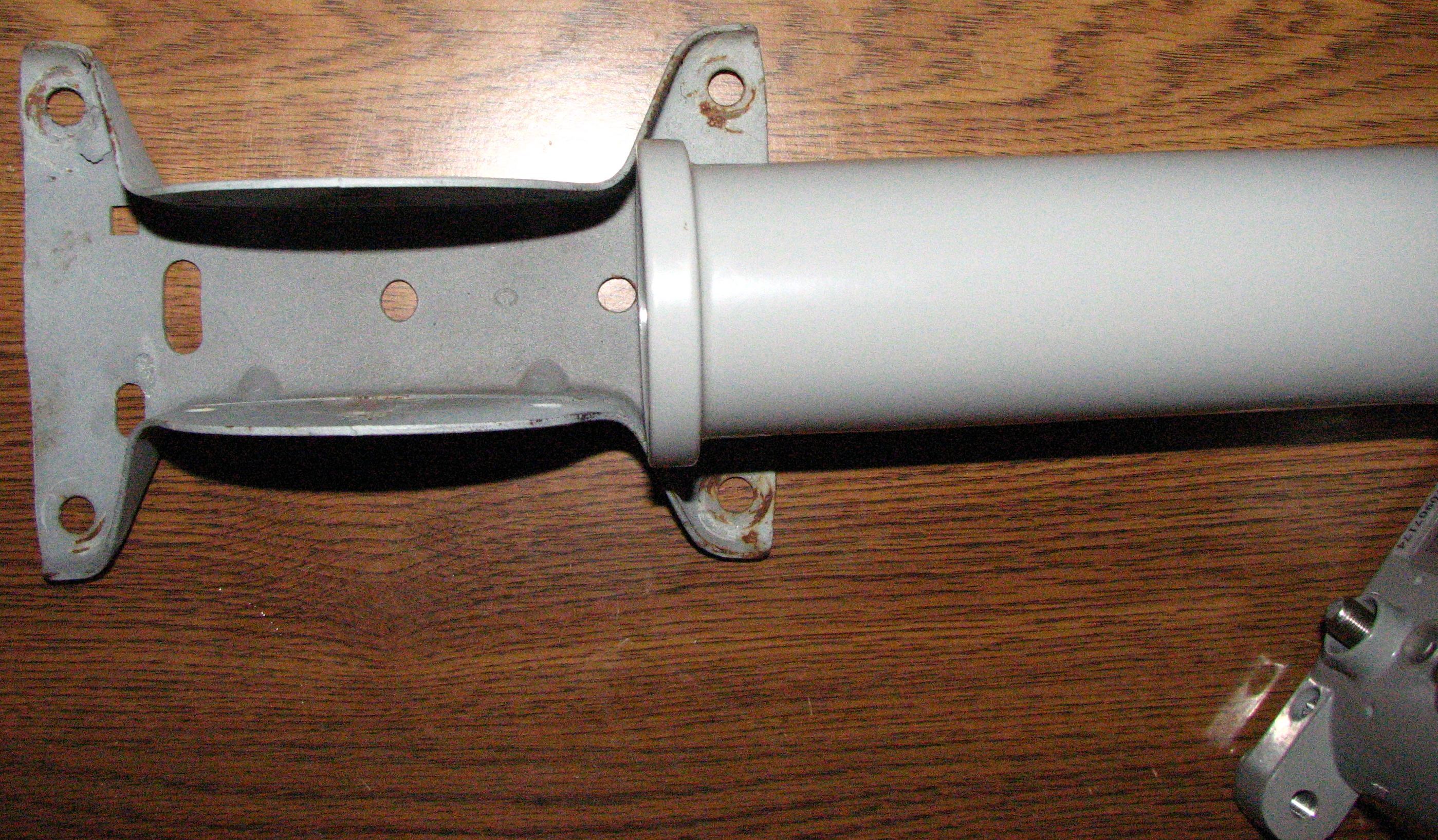

I was looking at some of the threads where you guys adapted parts from other old dishes to motors.
Well I dug through the junk here and it's all too small.
Like that bracket you bolt to the side of the house, it's too small for that tube on the motor.
That motor tube won't even come close to fitting in that thing. :(
You are on the right track.
What you have is probably a standard (small) DishNetwork or DirecTV post (tube) and foot (the bracket for the wall/roof).
Bigger dishes have bigger posts and wider foot/brackets.
Look for one off a Dish Network SuperDish (that should do it), or maybe one off a Primestar.
If the foot is wider than necessary, you can always shim it a bit with some washer.
This all comes to mind, because I read about it in one of the threads on the forum, circa 2006 or so! - :cool:

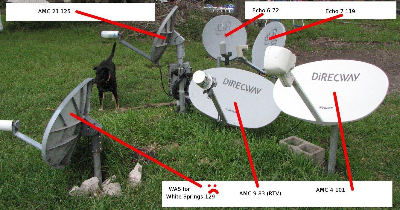

Awwwwwwwww... Thank you! :o *blushes*
Ok, let's see if I can keep things in order here.
I do have my dishes in my yard. Unfortunately I have a nasty mess of them out there left behind by the ex. I had taken them all down and was moments away from throwing them away when the thought struck me that I should check first to see if I could reuse them for anything. Some googling brought me here.
I've attached a photo of the little beasties as they are currently looking and made notes as to where they are pointing.
As for putting a dish on my roof, I can't. I don't want to. Trees are in the way, that's why the ex put the dishes out in the middle of the yard way back when.

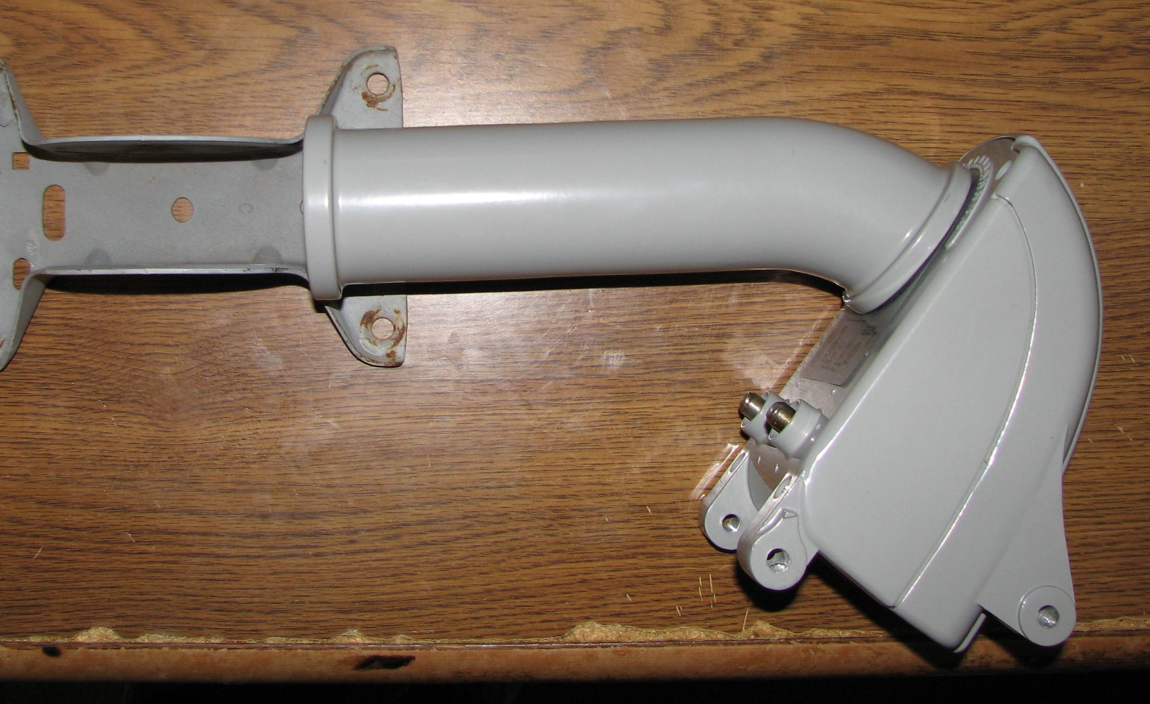

What I was attempting to do was see if some of the parts that are around here could be adapted to mount the nifty new motor thingie (that my dad was so gracious as to buy for me) onto that BIG 1 meter primestar dish I found on the side of the garage.
I was thinking I could do something similar to this,
http://www.satelliteguys.us/fta-shack/190432-hh-motor-primestar-oval.html#post1984996
Sadly, the tube thing on the motor is much larger than that wall mount part so that's not an option. I suppose my only option is to have my dad build a special adapter for me. He's quite handy with tools and machines and stuff.

It also is missing one of it's arms but I found a little aluminum flag pole that is the exact right diameter to use it as a replacement for the missing part.
Only problem is is that it needs to be bent. I don't have tools for that but my dad does, I've seen him bend little tubes for electrical wires like it's nothing. He has all sorts of gadgets for that. I dare not try it myself, I would ruin it for sure.
The gold colored tube on the top is the one I'll use to replace the missing part.
I'm still not sure what lnb to put on it, I want one that will get all the kinds of KU, so like I can get RTV on AMC9 or ION on echo7 119 or whatever, all on one lnb.
Someone said something about some combo kind but I can't remember what it is.
Also, in the right hand photo I was playing around with that box of parts and I noticed that the primestar lnb comes apart. So I took the funnel off the end and put it on a direcway lnb that looked like it had the same holes in it. What the heck, right? Not that it would work but I just wanted to see if it would fit, out of sheer boredom.

edit: PS. I measured the tube thing on the motor. It seems to be 55mm or 2 1/8" around. Or something like that. However you measure it.
I don't see that this would make any difference BUT, I found that the tube that goes from a directv wall mount to the dish, that slips into the motor tube but is very loose and wiggly. No good. I found a piece of white plastic pipe that says "1-1/2" CRESLINE PVC DWV ASTM D 2665 SCH 40 330 PSI" that fits SNUG inside the motor tube.
Maybe my dad can find a metal pipe that would fit inside the motor tube he could weld to a metal plate that bolts to the dish? If that makes any sense. :confused:

Dee, check with the vendor you got your motor from and see if they have a 42mm tube available for your motor. That it what is in the pics of my setup you referenced above.

I have had my 1.2m Channel Master dish setup as shown in your pictures using a SG2100 motor for the last 6-7 years and it has been working perfectly.
