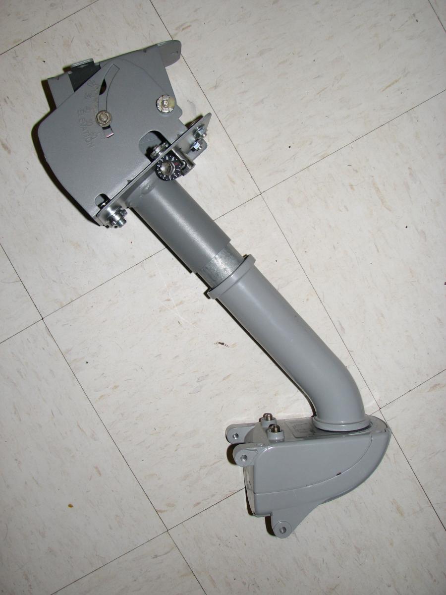

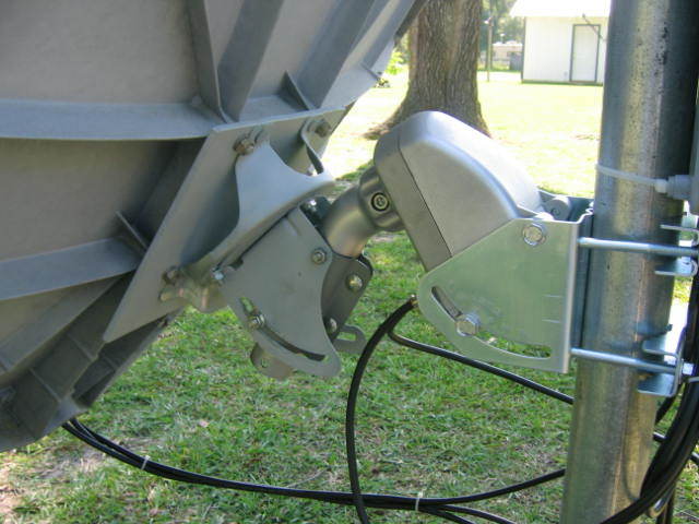

Digging through pictures I had archived, I ran across this one.
It should give you some ideas.
That's an aluminum plated bolted flat onto the back side of a Primestar.
The fancy metal work appears to be a mount off a small DirecTV dish, with the parts turned around.
(but the mount off a Dish 500 is very similar)
And it's easily adjustable, though adapting one of those big elevation booster screws from some of the pictures above, is still a useful improvement.
Everything here is well within your skills.
I look forward to your personal touch, in coming up with something suitable. - :up

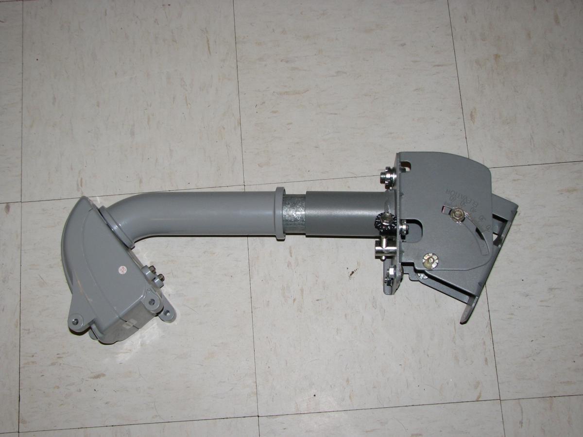

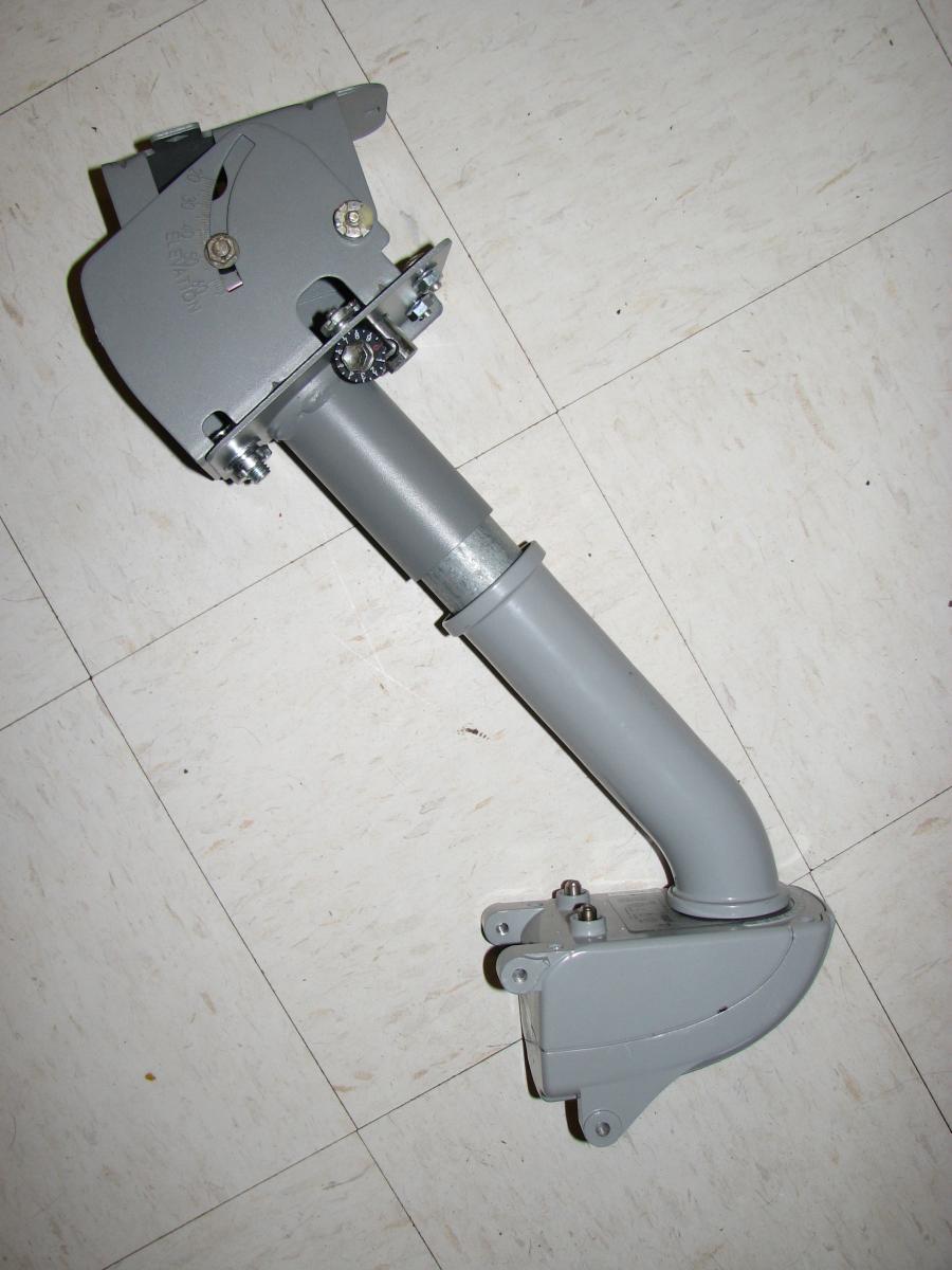

Well, after spending several weeks pouring over a multitude of photos of things you guys have come up with and then scouring ebay for about as long, I *think* I have the solution.
I found this thing that *looks* to be sturdy enough to do the job.
It was cheap and it should adapt to the motor I have.
It is called an at9 slimline az/el. Or something like that. Maybe that's what it fits.
My dad sad he can make a thick aluminum plate the bolt it to which will match up to the dish bolts. Dad says it should be easy to adapt it and it looks highly adjustable and very sturdy so I have high hopes that this will take care of it.
Please tell me I didn't make a mistake.. :eek: I already pair for it and ordered it but it's not due in for another week or so.
Besides, we are in for another round of torrential rains for the next two days so anything done outside is just not happening.
I still haven't been able to put the tv atenna up on the roof, I need help with that. My roommate's new boyfriend is falling all over himself to help with things around the house but I don't know or trust him yet so I will probably try to enlist the help of Dad again for the antenna. Besides, Dad like's building stuff. He really, really likes building stuff. Kind of kooky if you ask me but at least he's harmless. I think. On second thought, Dad does do some pretty shoddy work at times. Hmmm. I better think on the antenna project a bit before I get someone involved in it. Dad would just try to duck tape some wires up there and totally discard my lovely vision/design for a very fashionable antenna made of chicken wire, clothes hangers and towel rods. :rolleyes: Hmmmmm... What to do.. What to do...
Oh well, take a peek at the attachments and see what you think on my idea for the big dish to the motor. I forget what the name of that big beastie is right off hand, I'm tired. It's almost 4am, been on skype with my guy down under, my brain is running on emtpy right now. edit: Oh yes, it's the 1 meter primestar. Sorry, I'm so tired. :o

Yea, I recall: 1 meter Primestar, with three LNB support arms. Great choice! - :up
The ideas posted above were to save weight.
The mount you found is absolutely dandy... if it's not too heavy.
Also, it looks to be meant for the top of the pole, so not sure how that'll work out with the motor.
Possibly just turn the mount upside down.
I don't have one, and as you say, it's late, so I'm a little too dull to flip your pictures over in my mind and envision how they'd work.
My original goal, was for you to dig an otherwise useless small Dish or Direct mount out of your dish-pile.
This could wind up as a great alternative.

oh yes, I do intend to invert the thing in the same manner as I've seen in most of the examples. I looked at reusing some of the junk already here but it was all too flimsy and all of it too small for that large tube on the motor.
I measured it a few days back but I forget the measurements but it is far too large to fit anything I had here but too small to fit the BIG part that originally belongs to the dish. Besides, the original part is very heavy.
The part I got appears to be very sturdy, probably much lighter than the original and much closer to the proper size to fit the motor tube.
I did consult with dad first and he did say he can make an aluminum alloy adapter plate to adapt the new part to the old dish. He said that will be simple.
The end result hopefully will be some thing very much like the last picture you posted. :)

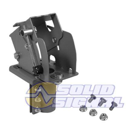

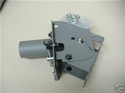

This "thing" looks like a brand new mounting component of a DirecTV Dish. Where did you buy it separately - it may be a good general choice for stationary older dish mods?
After a LOT of digging around on ebay I stumbled on this thing, then being the typical cheap b***h that I am, I checked on google shopping and turned up this site.
DIRECTV AZ/EL MOUNT MAST FOR KA/KU "BRAND NEW"
They are giving them away, you're paying for shipping, barely, and they throw in the part for free. It says the part is $9 with free shipping. But really, I think it's the other way around.
:D
Oh and also check here on google, slimline az/el - Google Product Search
Wow, Dee ! - That's some serious shopping. - :up
I'm close to the guy in Anaheim who wants $5 for his.
If I could pick it up for that, I might drive over. ;)
The $9 deal is dandy, too.

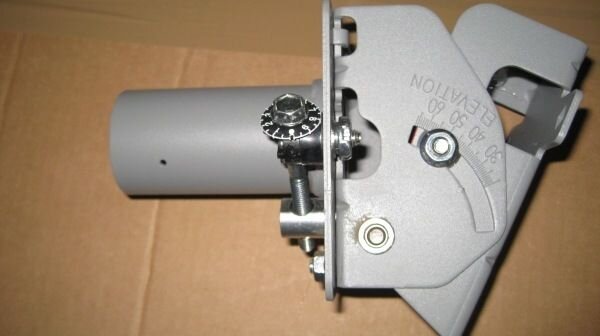

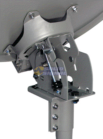

Look closely! It seems that the part I posted has a fine tuning vertical dish angle position adjuster, very handy whet trying to pick such a heavy dish, and your part does not. If that's the case, this small detail may be the critical key for you to successful and fan setup of a motorized dish.

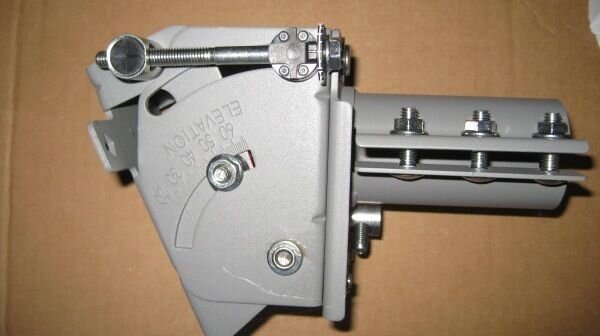

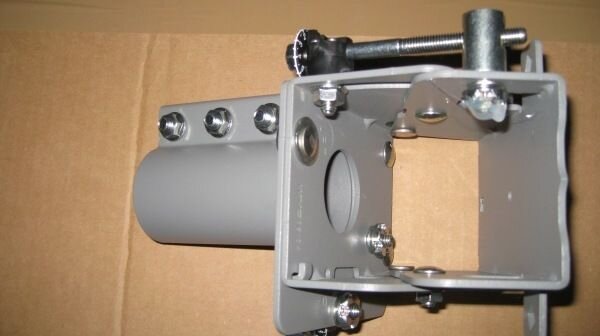

Looking through all the pictures of the mount on Brothers List, this one shows the elevation fine tune mechanism.

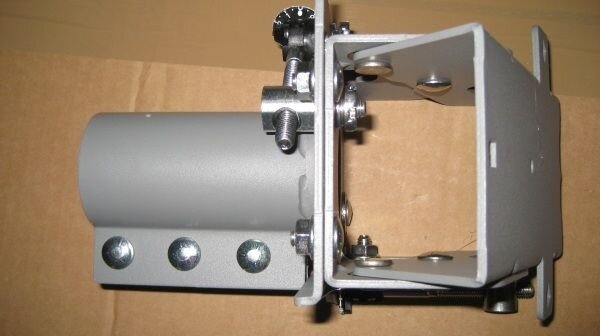

Likewise, this one shows the azimuth fine tune mechanism.
The mount tunes in the Ka-band satellites, and needs the delicate touch for peaking the signal.
The more I look, the more I like this thing! - :D
Dee
I think it does have that, it's just the camera angle they shot it at, you have to look carefully.
To Anole, what is the Azimuth thing for?
Dee -
In this picture you posted, that bolt mechanism, just left of center, the one with the calibrated dial, that does fine adjust of the DirecTV Ka dish east-west (azimuth).
Tuning up their dish on the Ka-band satellites is far more touchy than our tune-up on lower frequency Ku-band satellites.
(C-band is even sloppier)
When you are setting up your dish for true south, this may be of some help, just as the similar fine-tune elevation bolt (which also has a similar graduated dial).
Dee -
Ah! Ok, azimuth is the east to west adjustment. Gotcha. :)
So then it seems I made a good choice in picking this item, I assume. :D
I'm looking forward to getting that thing in, my dad said he'll make an aluminum plate to adapt it to the dish so to keep the weight down.

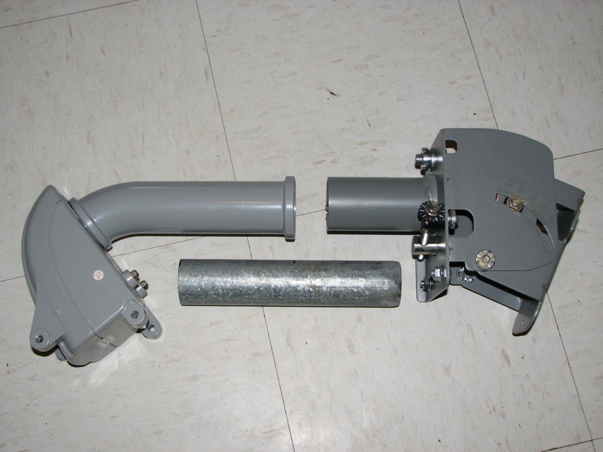

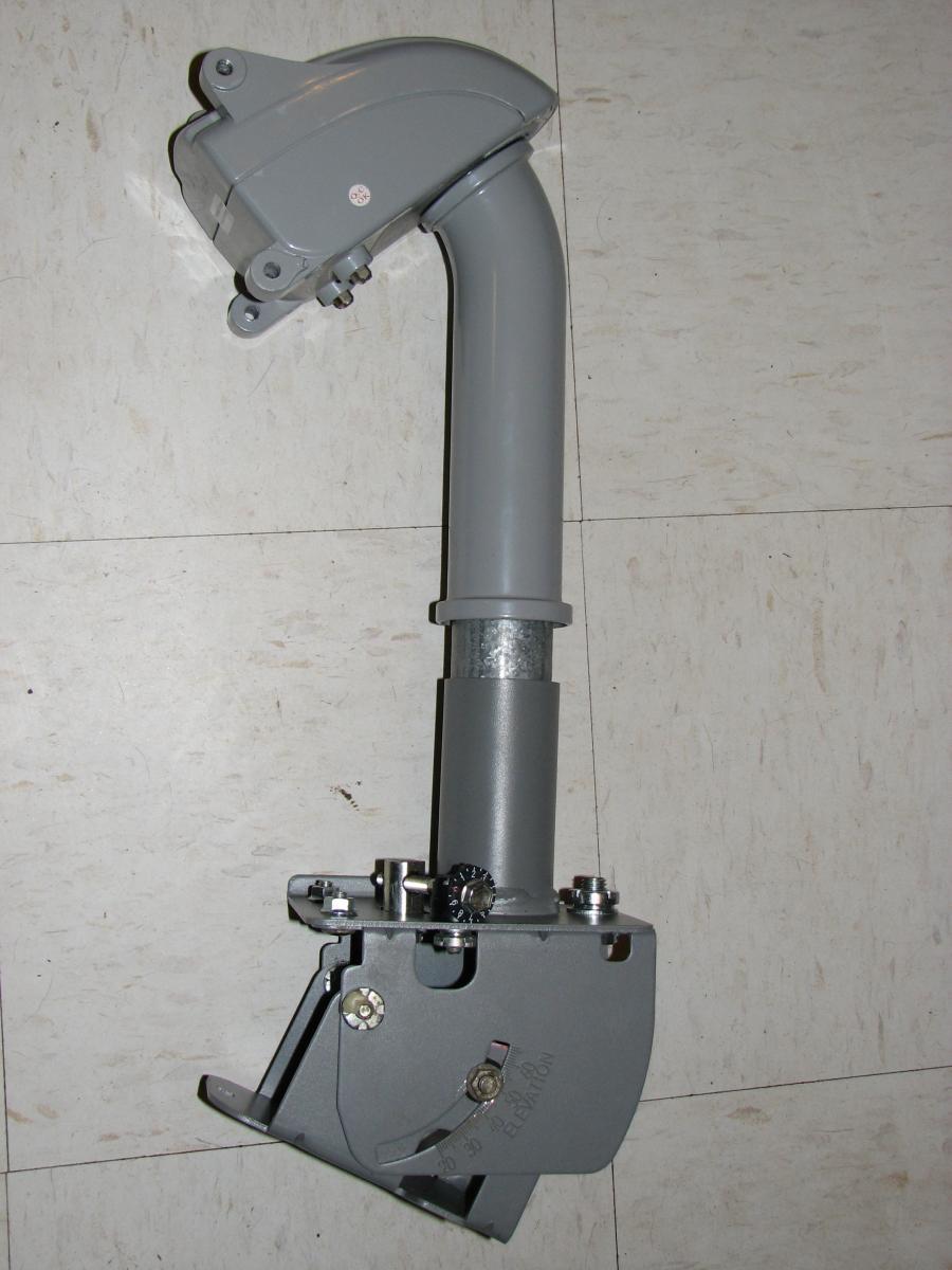

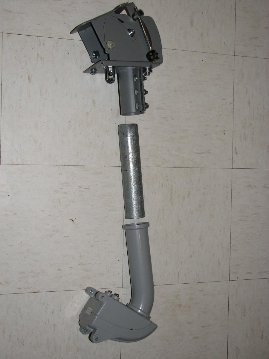

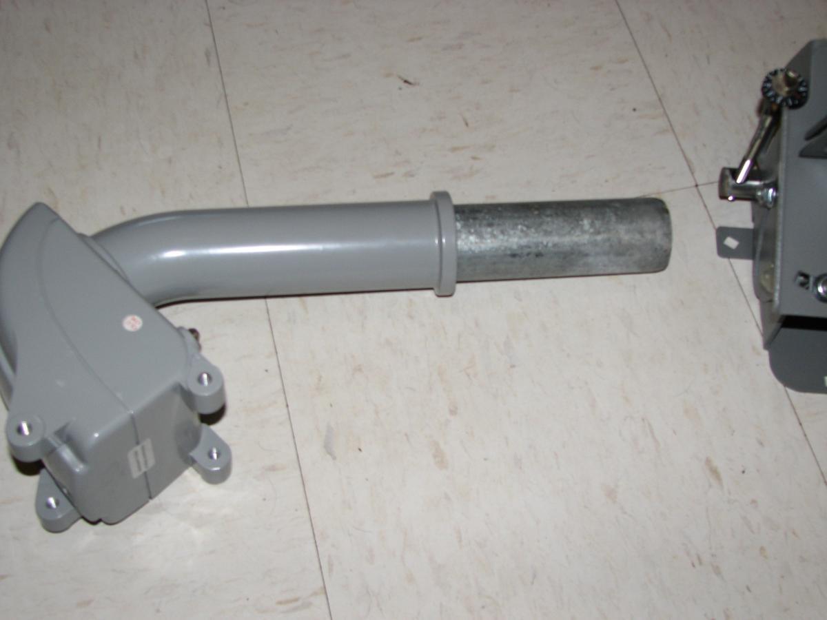

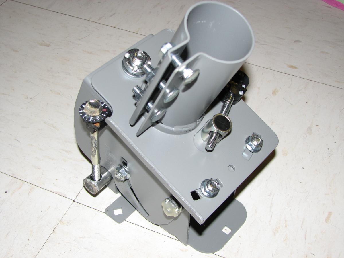

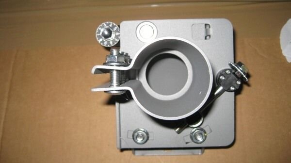

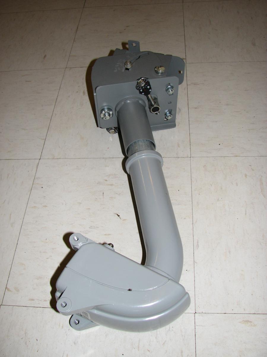

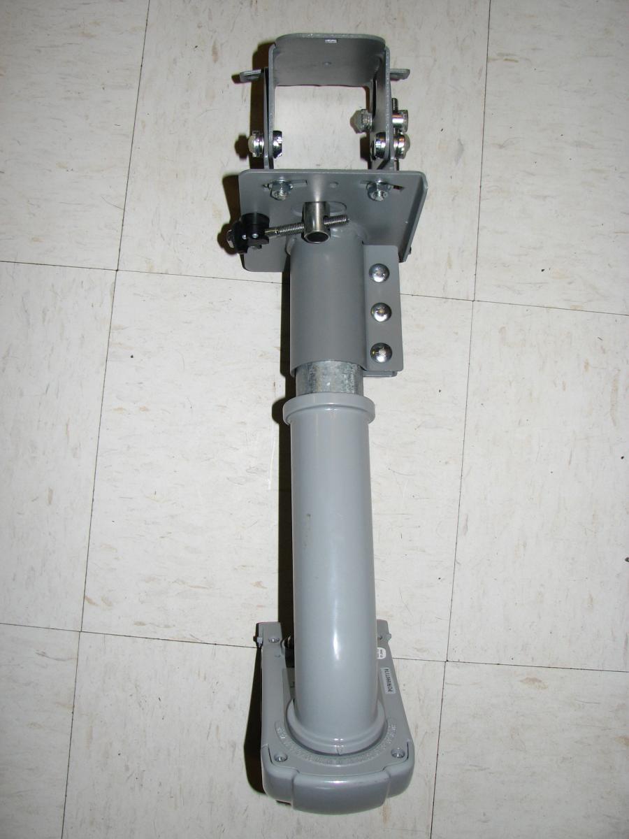

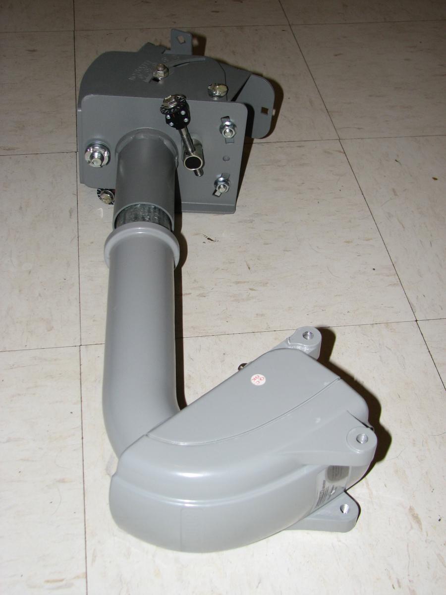

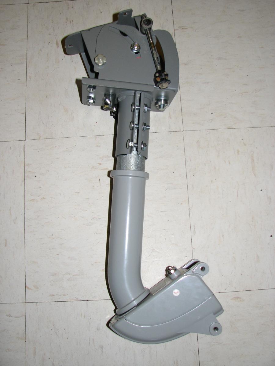

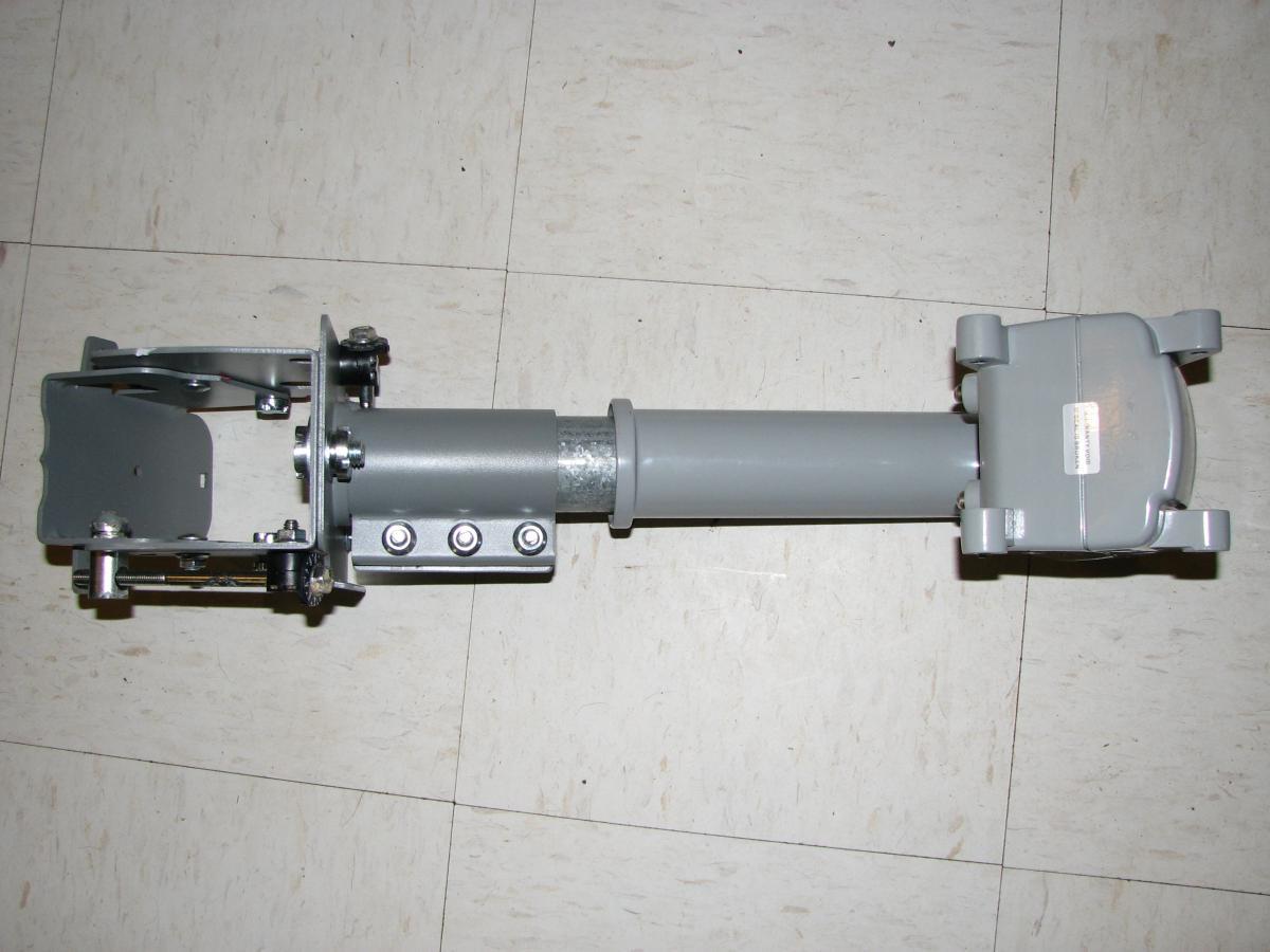

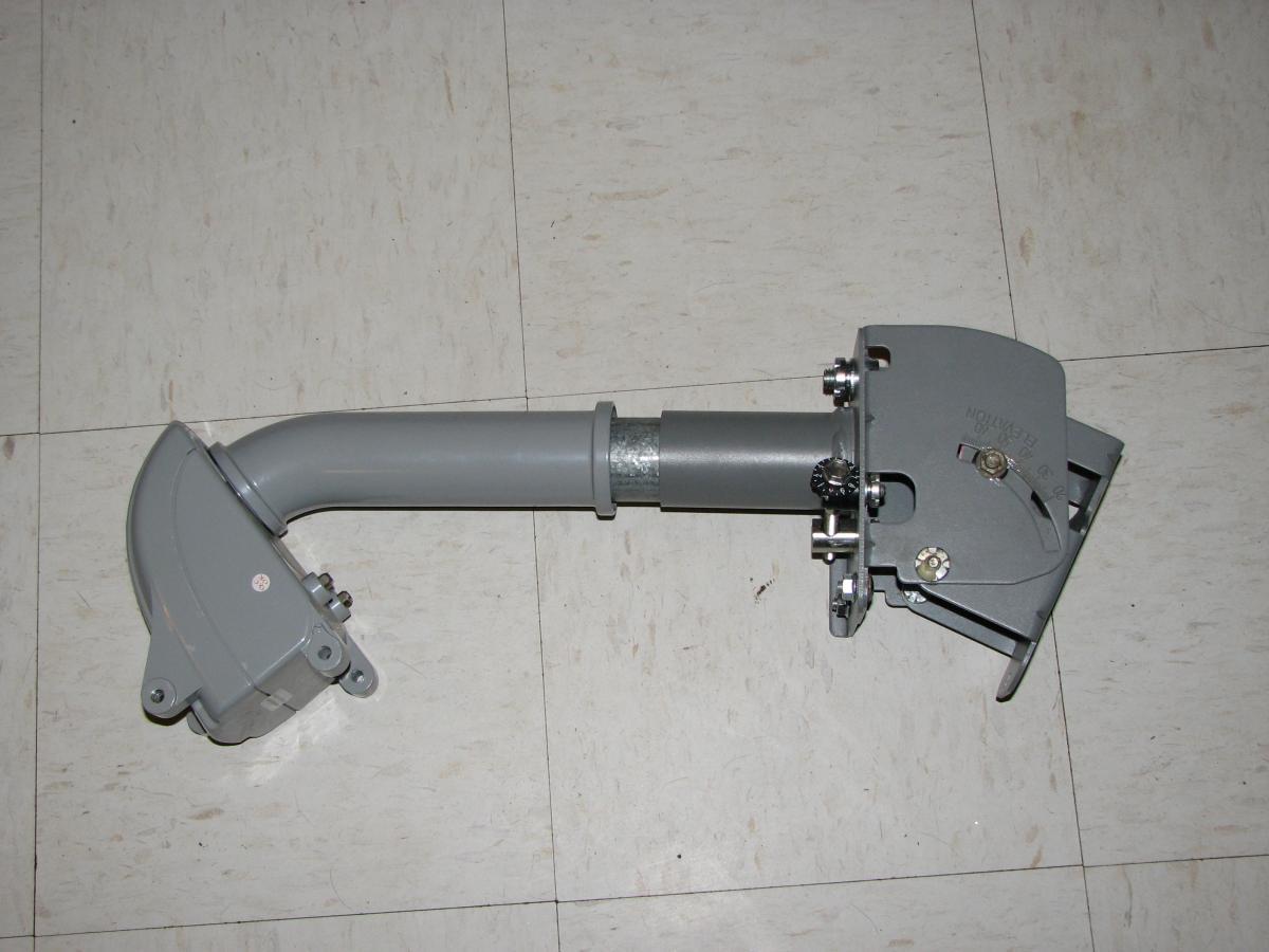

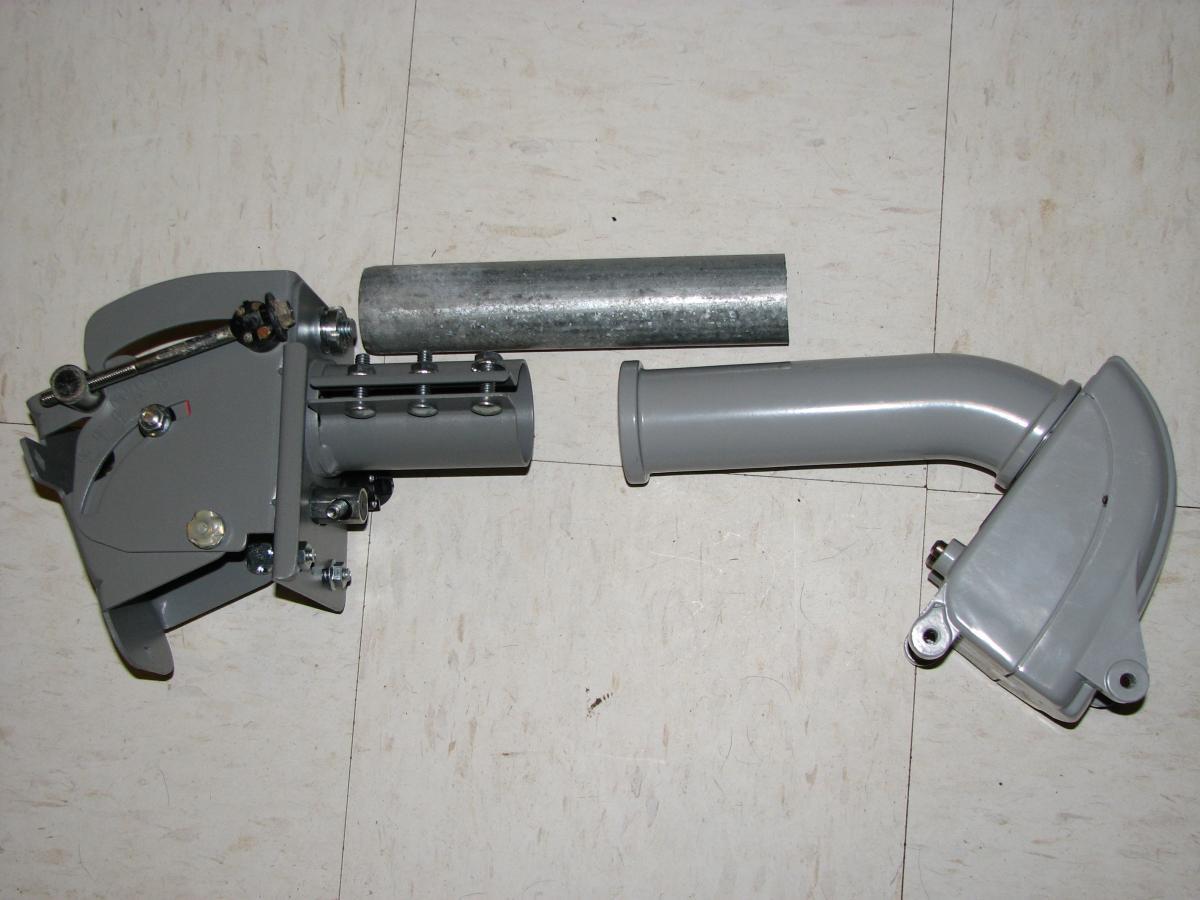

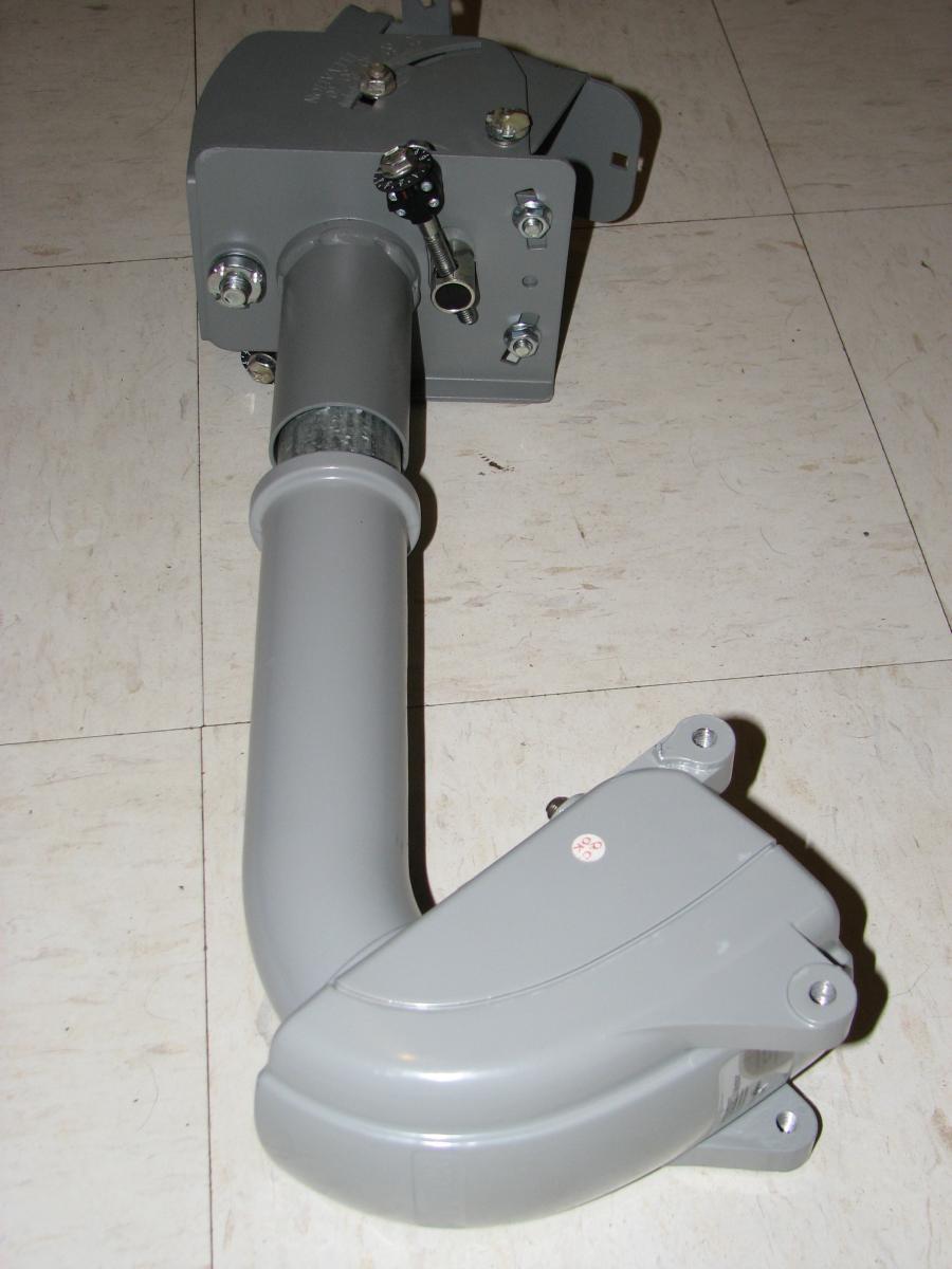

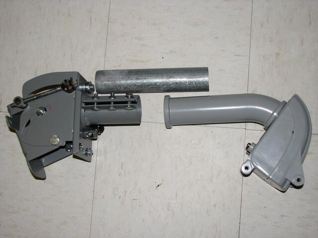

Ok.. Here's part of it. The part came in, still waiting on Dad to make the adapter plate for it. My neighbor cut a piece of pipe for me to hook the two parts together with, that was simple.
I think, fully assembled, the dish and all it's misc. metal stuff is going to be under 20lbs. I'm just worried it might protrude too much and put undue strain on the motor via leverage.
Here's a bunch of pictures I took of this part of the "lump" as you call it. :)
I estimate I'm still a few weeks away from having anything actually out back that resembles a working dish.
And there's always that one tripping point, I don't know what I'm doing. :o

Dee,
Usually one would unscrew the bolts and open circular mount wide enough to go around the motor mount. The wider end on the Motor mount is there to prevent free dish falling off the motor. Extra tube is not required. This particular part you bought seems to be not the best suited for this... :) The approach you're trying won't allow to reliably hold the dish on the motor, and also would create high excess loads on the motor due to higher rotation torque required under wind and dish weight, and higher shaft bearings load. Not sure, if it'll allow to follow the Arc either. You may want to look for other similar mount parts on the web, better suited for your task by their design. May be one of the site sponsors will supply you with a spare mount part from a regular 1m FTA dish?
That looks like a distinct possibility to me.
I'm having a hard time picturing just how the dish will mount to that bracket.
And I feel the same way zamar does.
