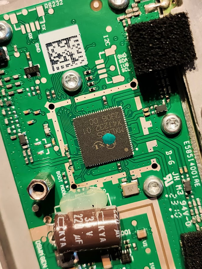

Would there be anyone over here with access to the MXL865 datasheet ? I opened the LNB to see what's inside and there is an MXL865 inside which can move parts of the 5 IF inputs to / or combined in the IF output, the chip has uart and i2c bus too, but trying to register to get more as the 2 pages product sheet is declined because I am not using an business email address ?
I don't have access to that datasheet. It probably was a proprietary chip made for DirecTV, I suspect it is the heart of the SWM functionality, which under control of the DirecTV receiver, switches one transponder on a specific frequency, LHCP or RHCP on one of the three feedhorns to a specified SWM channel on the coax. The SWM channel 0 is tuned to Ku Band, 101W TPN 27 that provides the slow program guide to all receivers in low data rate PID/SCID streams in addition to the A/V streams there. Each of the other tuners in each receiver are assigned a SWM channel to use. SWM channel 0 is centered at 974 KHz. I am attaching a SWM frequency chart that I developed 15 years ago.
If a SWM LNB is powered up without being connected to a DirecTV receiver, and therefor receives no commands, it puts out a signal tuned to a transponder on the center (101 Ku) feed horn. It could be on TPN 30 which previously was the guide data channel. This signal can be used with a simple meter to align the dish (here in the US) with a process called "dithering" to get the much sharper Ka feeds from 99.2 and 102.8 W aligned.
Reactions: PE2BZ
