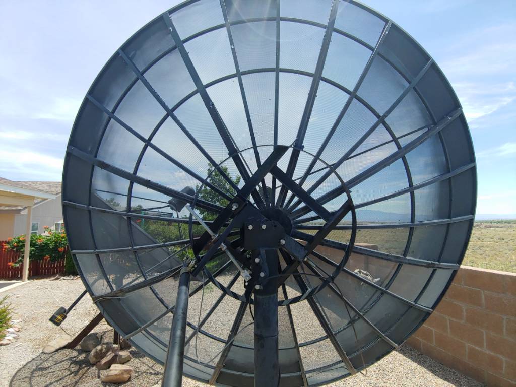

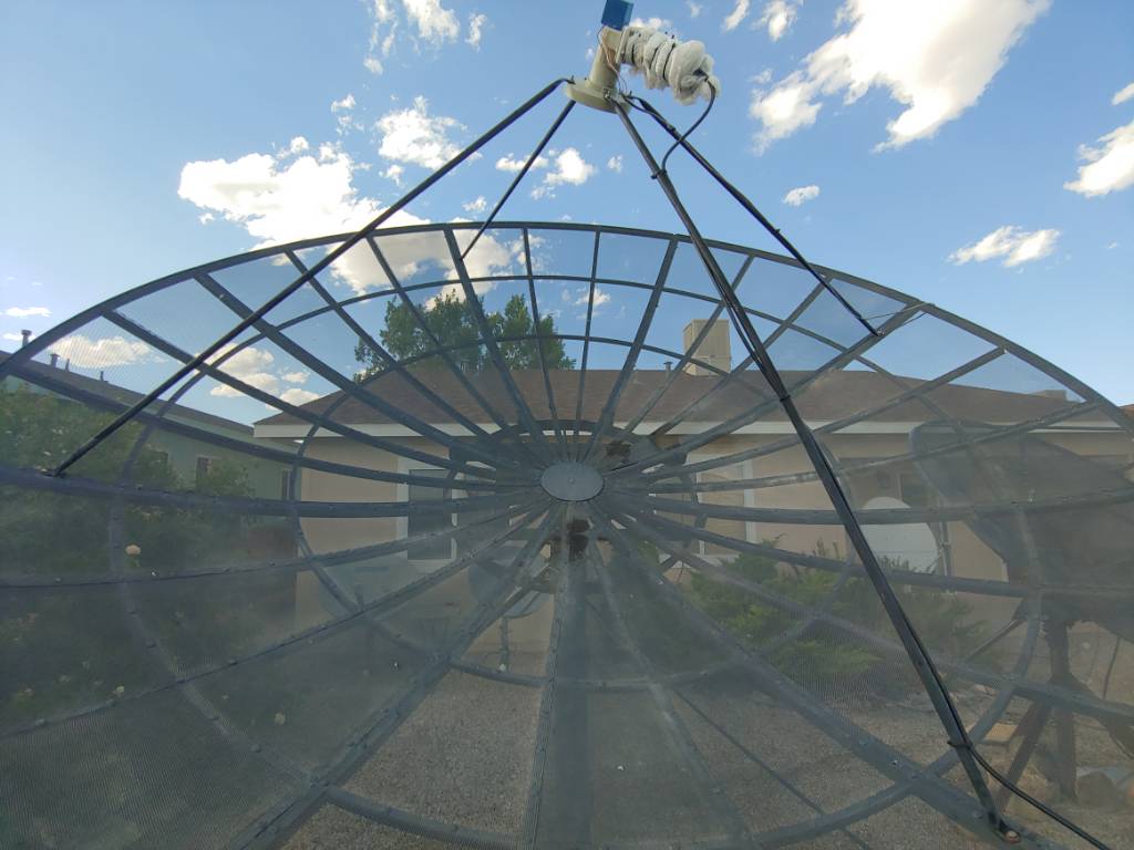

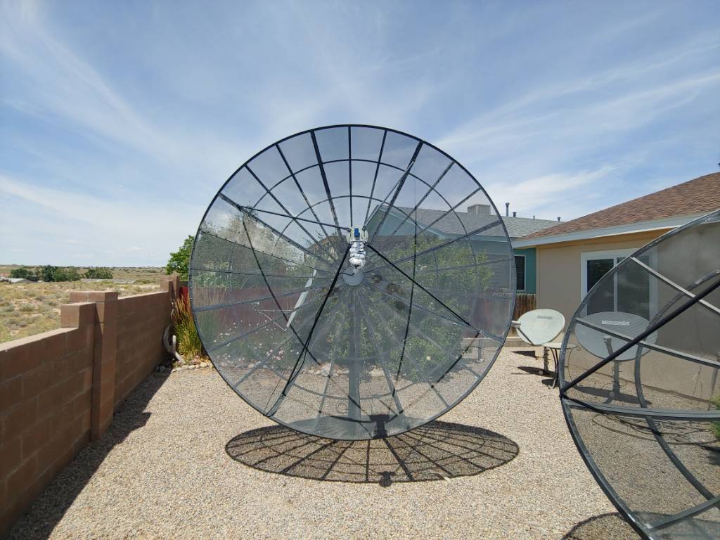

What was your final adjustment on the rods? How far from the end? When my dish is on 45 47.5w (dish goes right to the south in this picture) it looks fine but on 105w it looks like the picture attached.105w is my South sat here in NM
I imagine the rods need moving but where so it doesn't look like it's all crooked?

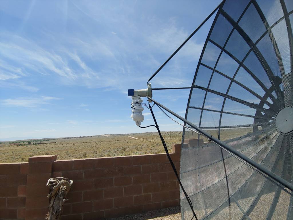

Bag around the lnb is just too protect it in the summer hot months since the cover doesn't fit the dish with a norsat.
Bag around the lnb is just too protect it in the summer hot months since the cover doesn't fit the dish with a norsat. View attachment 146225

Does the back have clips to support the dish, if not look at the very inside ring all of the dish SHOULD BE TOUCHING IT; OR YOU HAVE A HUGE ISSUE OF it egg-shaped even at tiny bit will screw up BIG TIME
The inside seems to be touching the ring. I don't see any gaps. Do you think the right side of the dish is just lower? How does that get corrected ?

The LNB 'looks' crooked in the holder but it might be the camera angle. It's critical to center the lnb in the holder and make sure it's equal all the way around the circumference. IE if on the top of the lnb it extends a half inch beyond the holder and on the sides or bottom it's more or less than a half inch the lnb isn't centered properly.
I have not changed where the rods attach to the dish since the initial install when it was determined that the instructions that came with the dish were wrong.

Top bearing needs to be tightened, put the dish at the zenith, lift the bottom rim. it should NOT MOVE, IF IT DOES PULL the cotter pin from top bearing and tightened the nut don't go crazy then recheck if the bottom of the dish is ok find the next hole the pin goes in, and put it there, recheck if the bottom bearing is OK what wears them out "wind th dish is always being pushed by wind 24/7
I hope that fixes it but before you do anymore string the darn thing both inside and outside need help ask me

String complete. Dish doesn't move. It's tightened up. LNB looks to be top right of the center point . I show f/d of 40 on the lnb which is straight in the holder.

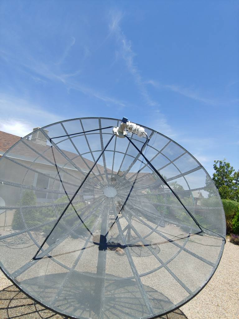

I dropped the dish down to 43w. Here are pictures . can you tell what needs to be moved from these shots? Dish seems to not be warped.

I have moved the f/d. It's about 41 actually. Wheh the dish is up high the lnb looks off centered. Is that normal?

Sure doesn't look normal to ME!
Are you sure the scalar is screwed down TIGHT to each rod, AND, measuring at several points from rim of dish to rim of scalar, is it centered, for SURE? Perhaps some fat flat washers can help strengthen the 'scalar to rod' connection, so it can't easily shift just from different sat aiming angles of the dish.

On your dish, the panels come together North and South. Mine are like at 30 deg angle maybe without measuring. Is that the problem where the whole dish needs to be redone and lines up that way?
