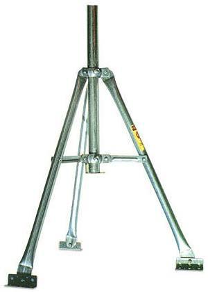

I was wondering what size Satellite Tripod to use with my secondary travel system? The setup Is identical to my primary system here at home and consists of a Moteck Digipower SG2100 motor, FORTEC STAR 80cm KU Band Offset Dish Antenna and an Invacom QPH031 LNBF all brand new. I have the pole mount that came with it with the extra supports.(Second Picture)
I will be using my Fortec Star Dynamic for travel because of the ease of use for everyone!
I was going to mount it to a wooden pallet, (I have a small one but big enough to support the 80 CM, my 90 CM is on it now!) lag screw it to the pallet but I really do not want to travel with a wood pallet! I was looking at the 3' tripods and the 5' ones. Other than the obvious in taller size does any member have either height tripod mounts and the results with setting them up and using them OR some other way for a fast travel system setup that would not be too complicated meaning some neat cool way to set a temporary system up without a tripod.

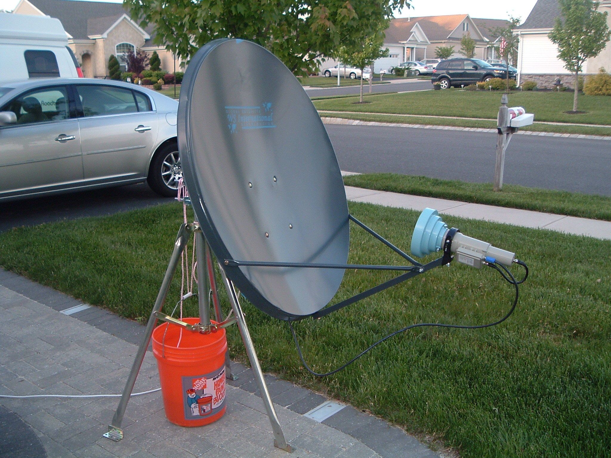

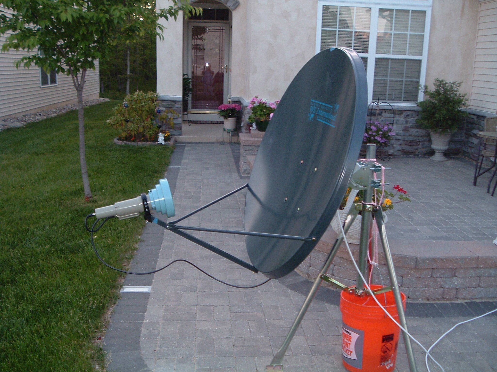

Since I live in an HOA community I move my FTA set up in and out of the garage and I lock down the tripod with a bucket of sand. It works fine; check out the pics. I lift the bucket of sand about an eigth of an inch off the ground and let it hang the weight of the sand in the bucket holds the tripod very well. I took the set up to my daughters house in NC and used their bucket filled with sand. If you go camping a bucket of water would work too.

Since I live in an HOA community I move my FTA set up in and out of the garage and I lock down the tripod with a bucket of sand....
Mike Lib
Great pictures Mike, looks like a 90 CM dish! Is that a 3' or a 5' tripod? Any issues with wind? I take that the sand is all you use for weight and nothing bolted on the feet of the tripod. Well now, since you have a tripod setup, what is your take on using one, or the Pros and Cons (if any!) on using it?
K E V I N
K E V I N
Yes that's a WSI 90 cm, and a 3-foot tripod and a Home Depot bucket with around 20 lbs of sand. I was playing around with C-Band that why the conical ring on the LNB. I usually use the Ivacom LNB that does both linear and circular reception. I bought the FTA motorized system from Galaxy Marketing a couple of months ago. Love the FTA hobby.

Yes that's a WSI 90 cm, and a 3-foot tripod and a Home Depot bucket with around 20 lbs of sand…….

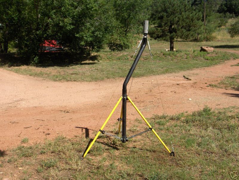

I am a full time RVer and have a Motosat D3 system with a Hughesnet 74cm dish on the roof. It is great but is useless if a campground has a large shade tree next to the camping spot. A couple of years ago I picked up a second Direcway dish at a dump. While looking for a decent tripod I came across this one (see attached) on eBay. I paid $80 for it (used). It is the perfect portable system. The feet have small spears to pierce the ground. Once assembled and the heavy Directway/Hughesnet dish is installed on it, the turnbuckles on the guy wires are used to make it perfectly plumb. Within a few minutes I am on the satellite and ready for the internet. The dish, tripod and all the wiring are stored in a Thule luggage carrier on top of my dually pickup. It also has the side lnbfs for Dish Network. The whole thing can also be used FTA.
Although I have never tried it, it should be steady enough for a motor. I don't know who makes it, or if it is still being made. It is extremely lightweight and without a doubt, the best tripod I have ever owned or used.
W:eek:W Elchucko, that looks like the Cadillac of tripods! :bow
The turnbuckles & guy wires on that thing is something else! That is the ultimate mobile mount gear! I checked out the Motosat manufacture site, really impressive stuff there for Internet Receiving gear and dishes. Be nice to find a used tripod like that one for sure! :up
It is a bit big though for just traveling around without a RV though. I really need something small enough to fit into my classic car trunk for easy transport to and from car shows. My trunk space on the old gal is 14.7 cubic feet with full-size 15 inch spare in there. Now on the other hand, it would be perfect for the barbecues and outside family reunions and such I attend all the time.
Might look into that for sure! This is what I wanted, the true RV people suggestions on that they use for they got to have the fastest and easiest way to set up dishes. But I also welcome any idea too! :up
The tripod is not really that large. It splits in two. The black pipe splits right above the yellow legs, making it only about 3 feet long when disassembled.
