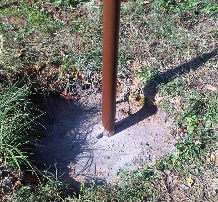

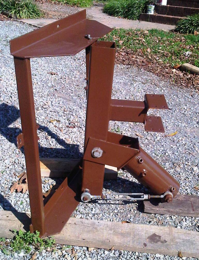

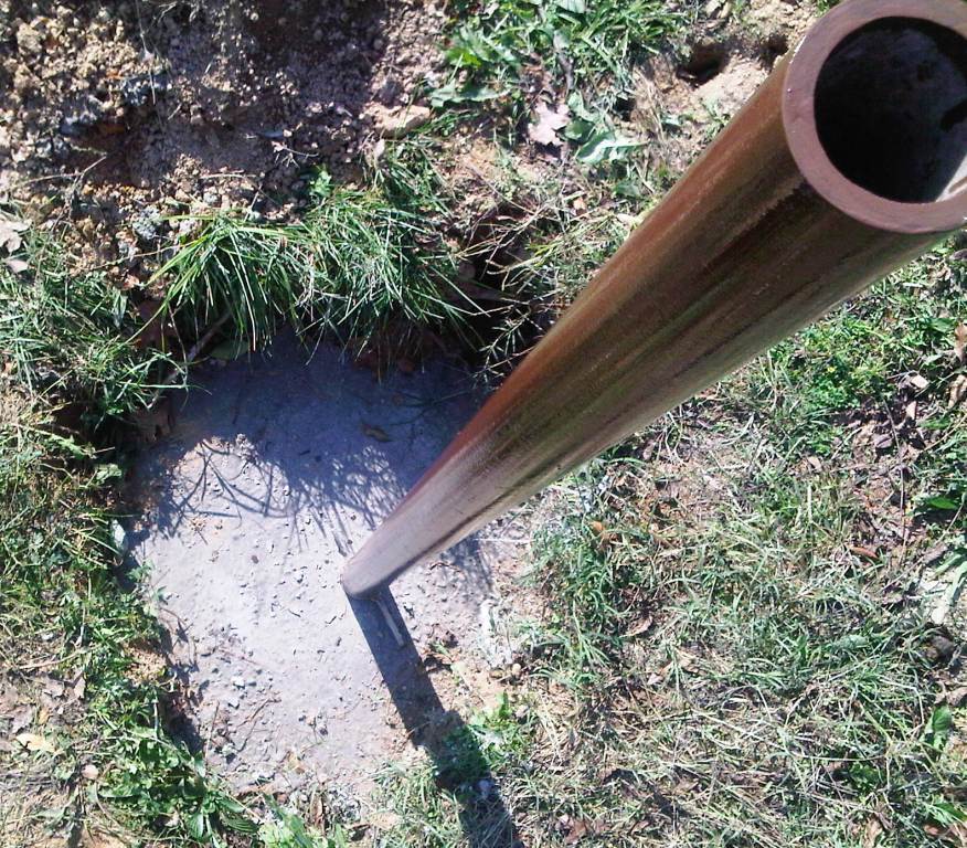

Well my wife, neighbor and nephew all shamed me into getting my C-Band dish up before winter. I think the exact quote from my nephew was "Hey, Uncle Charlie - - - didn't you dig that hole - - - like a year ago"
Anyway, this past Tuesday I spent most of the day getting the pole set in the ground. 13 - - - 80 pound bags of concrete - - - pole is 5 foot down and 5.5 feet up - - - - and yes it is completely plumb all the way around.
Painted pole dark brown today and also the support poles.
Dish goes up this week (Tuesday or Wednesday) - - some PIX so far.

Is there any particular reason that you chose to paint it brown over the standard black? The brown looks fine, just curious.
Looks good so far!!
I think maybe three reasons - - - I ran out of black paint, my daughter gave me a clue how she might paint this dish next spring (and I thought dark brown would go better than black with what she has planned) and I had plenty of dark brown paint in the shed.
The mount, dish, support poles and everything had been either black or a charcoal gray before. The back of this dish is very visible from the road so the back may eventually be painted differently than the front of the dish. If I can get my painters to come up with something creative.
Great job and I like the brown color.

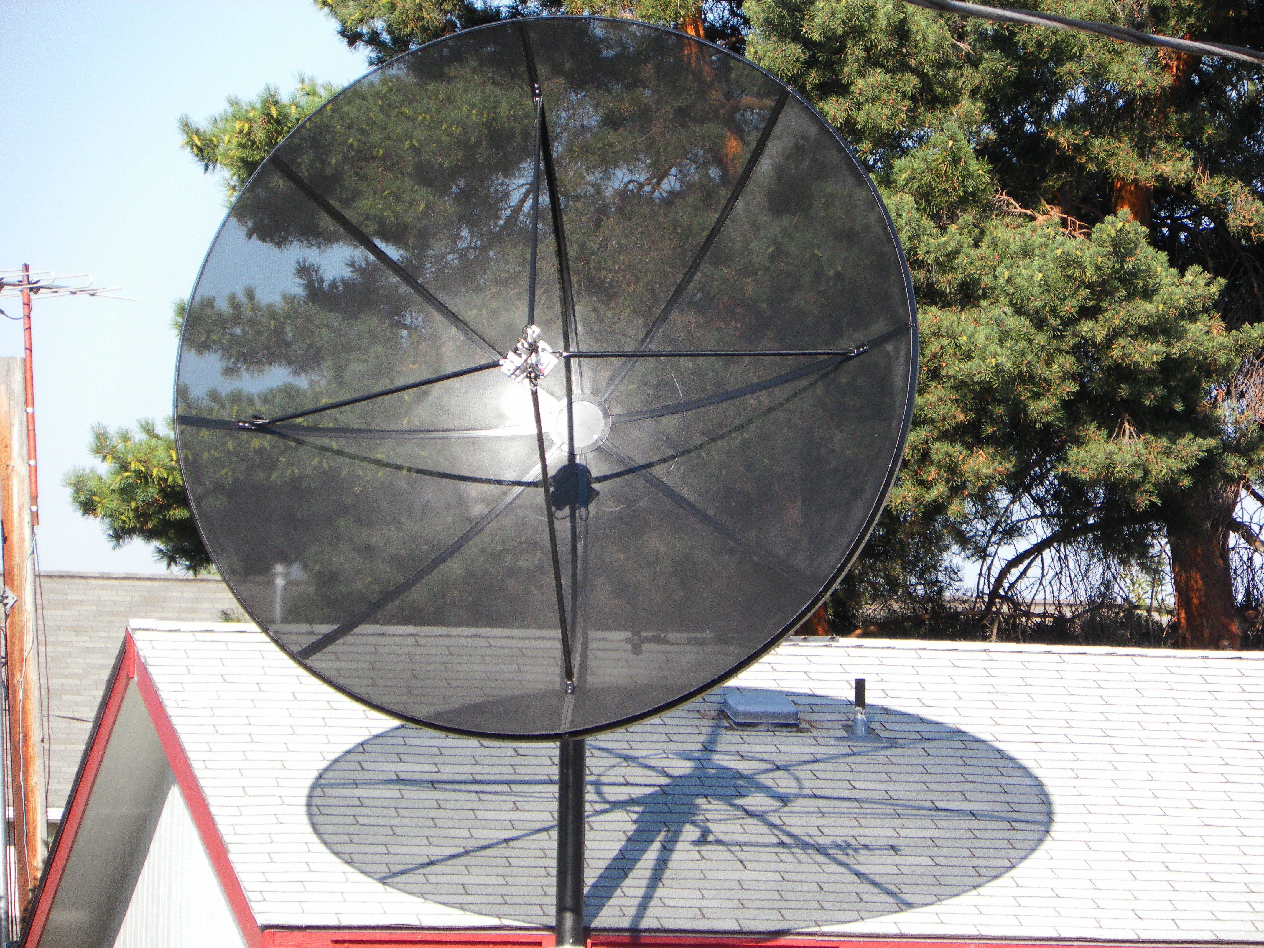

Not to change the subject, but I have a related question. Does anyone know the reason that most all mesh dishes have always been painted black or a dark grey color? I know that the older fiberglass dishes were usually white, I wonder why the mesh dishes were never painted white? Is there any technical reason?
Actually a lot of the Conifer Satellite Dishes were painted white.
White shows dirt and dust more. When the bolts holding the dish together rust, the rust will stain where the water runs off.
More importantly, black paint in the sun gets hotter than any other color, this keeps the snow and ice off of it.
Red, Green, Brown, etc all fade easily.
Black is the most fade resistant color.
Black enhances the see through quality of a mesh dish and white makes it hard to see through.

I hope you had a mixer for that many bags of mix.
Take lots of pics when you install.
Most important: Be safe when you put it up.
Unfortunately, I used a wheelbarrow and hoe to mix the concrete. I bought 7 bags and mixed all those - - - saw that was not enough and went back and got 6 more bags and finished.

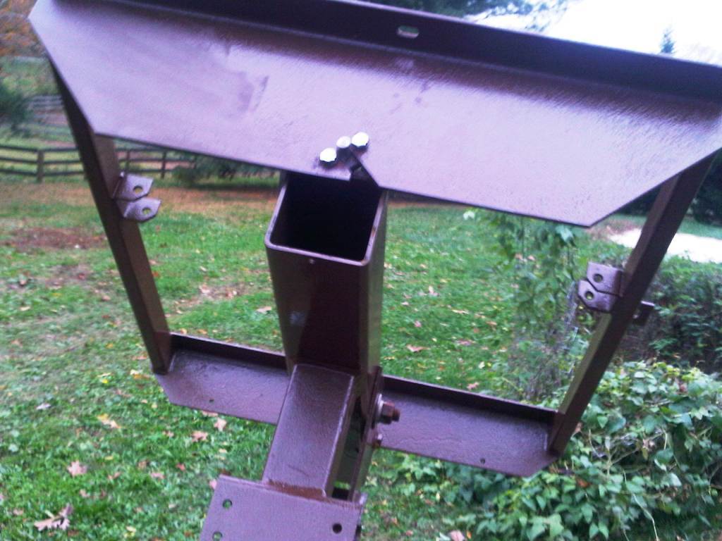

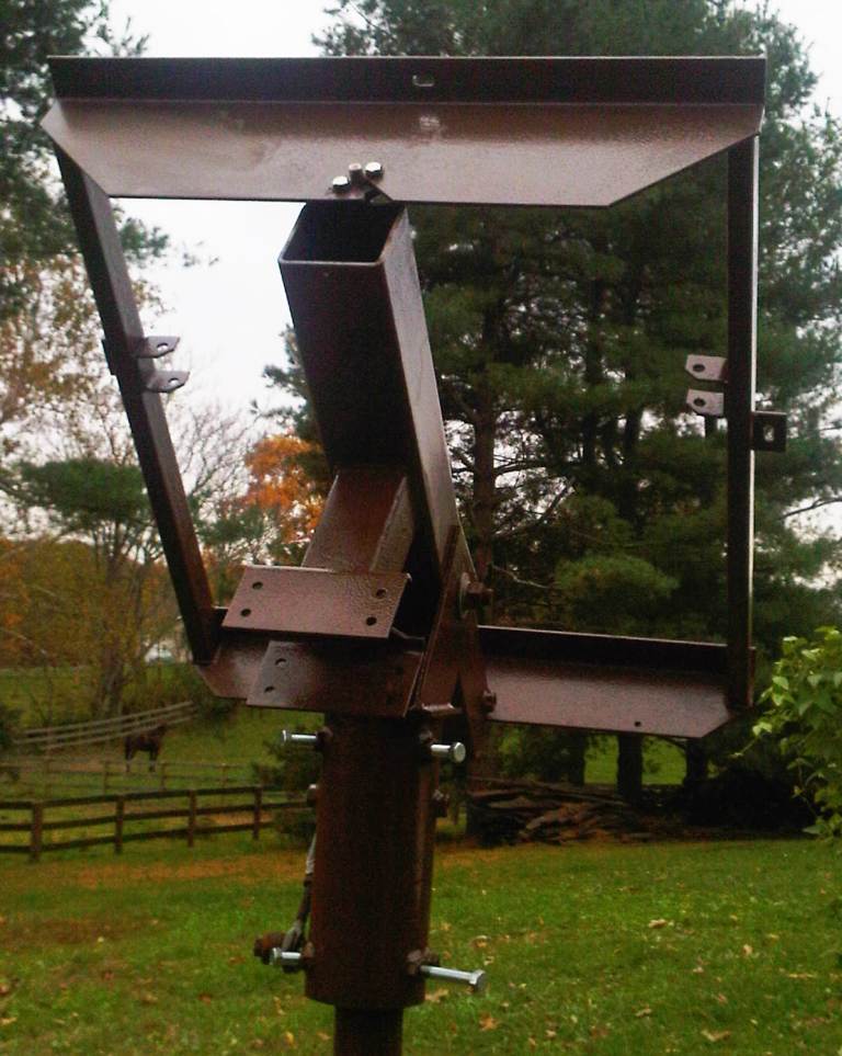

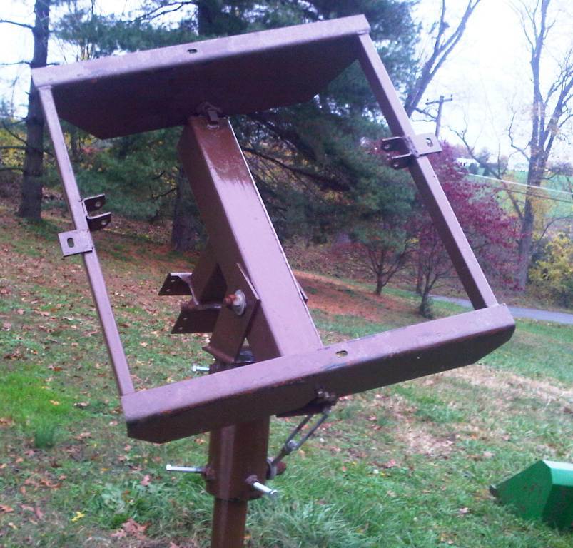

Mount Up
Came home from work a bit early today and put the mount up.
It was a bit harder than I thought it would be and I still do not have it plumb all the way around - - -that part may take some time - - - I get one side right and then 90 degrees from that is off.
Dish next - - - but we are supposed to get 4 to 6 inches of snow tonight - - - - so much for getting it up before winter. :rolleyes:
Here are some PIX
