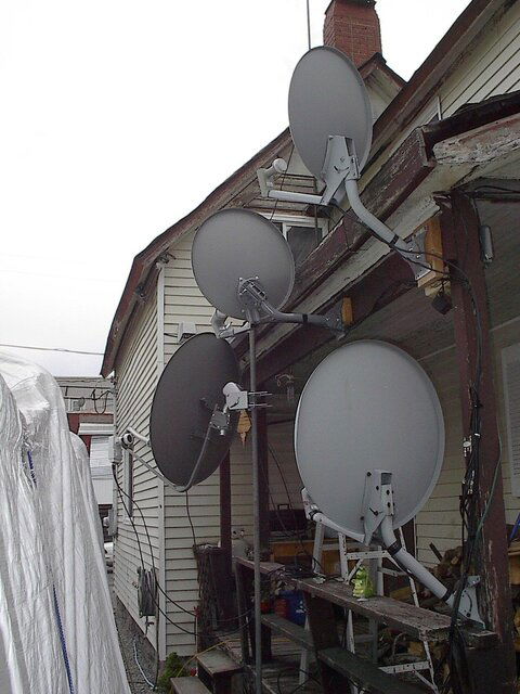

Thanks for the info. Had another good day today. Using the Channel Master Iceberg posted along with Lak7's advise. Backtracked from 91 to find 74W. Could not get 74 but got 72 big time! Using my sat. meter I got a signal of where it was , even though the machine did not lock on it (74) and set that to my true south. Using the motor (using 1.2), I found pretty well 72-110. Now I just have to figure out how to scan properly on these sats. I can't hit anymore as that is it for my line of sight until I set it up on the tower. My girlfriend calls it 2 wasted days... What does she know,LOL!!! Thanks guys!
Can someone point me in the right direction?
Moved my dish up to the top of the porch today in test position #2. From there I should be able to clear everything in the sky. Was expecting more but not?.
Short version. Clarke belt confirmed by channels scanned using "The list". Meaning proper sat. channels are where they should be on the sat. # . Here is where I would need some help.
What I have, 72W,79,87,89,91,95,97,101,105,107. Some missing in between ? Using USALS, 123W my dish is not pointed where DishPointer.co? indicates it should be. It's not helping me find the others either? Ex. 83,85, etc.. Even using 1.2 on my CoolSat 5000 Premium to scan long and short sweeps, I can't see those and others or any above or below these. Any ideas? Now I'm on the roof crawling out of the bedroom window. At least the snow is gone... LOL. I thought that the setup might be off but it's "hit and miss" from 72 to 107. I'm hope others have been there and can help. I looked and now need to ask. A world where one can get on the internet today and view or download whatever they wish. I try and try, to tell the "armchair warriors" that this is a hobby. Thank you all for any input. N.B., I don't always get all the channels listed. I would think that is since that I'm in Canada/Northern NY. that would be expected?
