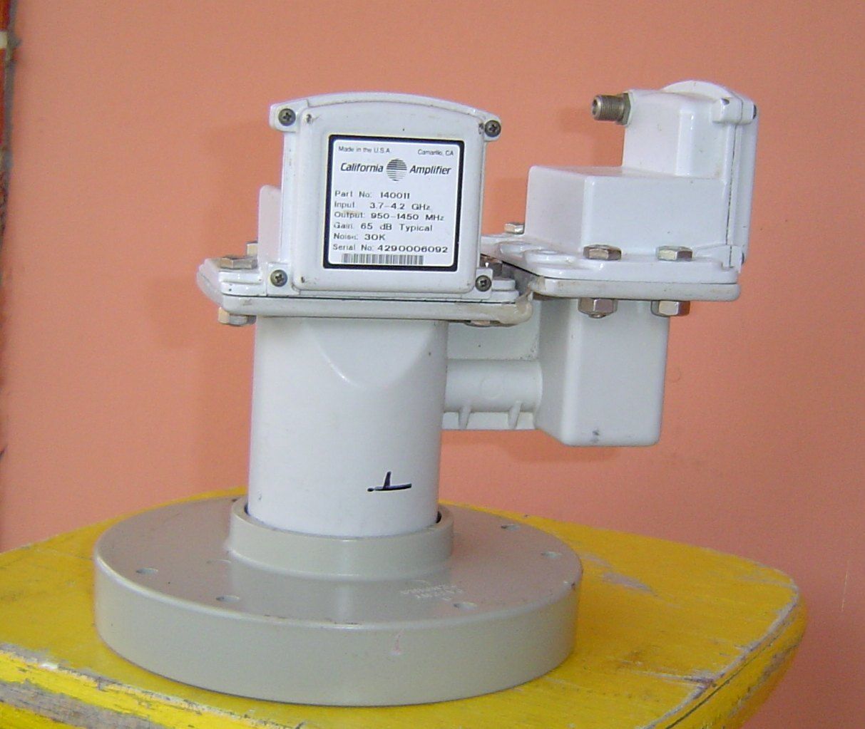

But your title "The most powerful" would have to be an Orthomode feed horn with 2 LNB's (1H, 1V) Best choice for weak signals.
Thank you Fat Air...I will try the 241 option first but looking at Orthomode feed horn.Is this too expensive?
Expensive? depends... if you watch and wait, good deals will be found. Right here on this forum I picked up an ortho with LNBs for $65 Cheap!
That's a deal.
You can't even buy the dual feed from the jerks at chaparral that cheap.
...and you'll need to hook up an ortho through a multiswitch.
Read up on 'em, and don't go off half cocked ;)
Plenty of introductory material on-site.
via iPhone 4
An orthomode feed allows my cheap WSI 6 footer to pick up "some" of the 9/10 FEC, DVB-S2 feeds . That's saying a lot for the cheap 6 footer. A larger dish , say a 10 footer, should really rock with an ortho feed. :)
