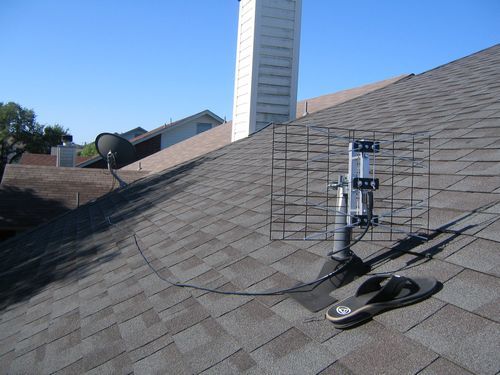

If things don't work out - don't be afraid to venture into outdoor antennas. It's not that hard to do. I am super lazy and I still managed to install mine without running any new wires and without installing a pole. Here's a pic of my setup. I just clamped it onto an existing exhaust pipe and hooked it into my dish wiring system and now my reception is perfect and available anywhere in my home.
Thanks for the visual. My dish is mounted off the roof about 75' from the house due to trees in the area (which also is probably affecting my OTA signal). There is some existing wiring from cable that I could probably hook up to, but the jack for that is on the other side of the room. I have so many wires running right now, I don't think the wife would want a coax transversing the room, so...
